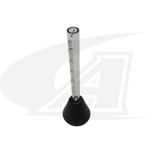

  16. budd
    Joined: Oct 31, 2006
    Posts: 3,478
    budd
      66.5 KB
      155
