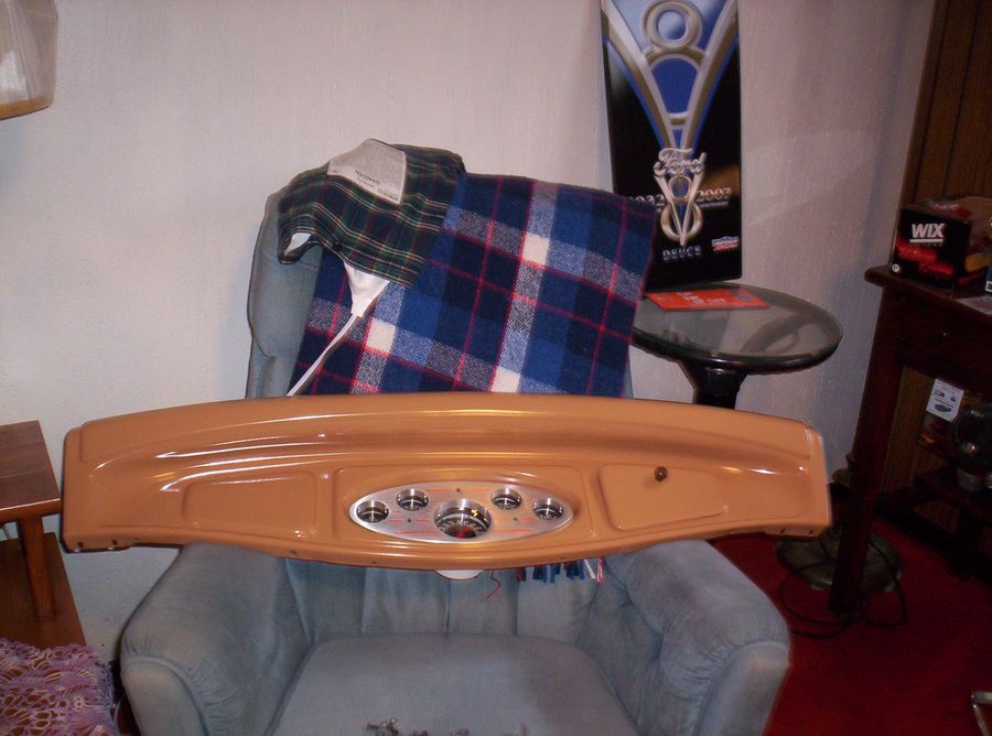

  1. You nailed it! Dash insert is much much better. Awesome job! I've done some woodgraining before, not sure of the process you used (guess that's coming) but very satisfying work. Yours looks perfect. Having watched your other build threads, is there anything you can't do? Lol

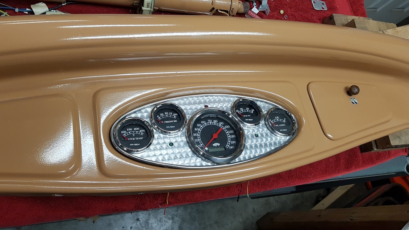

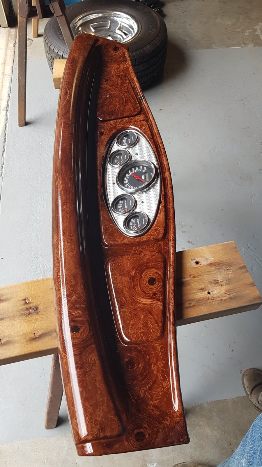

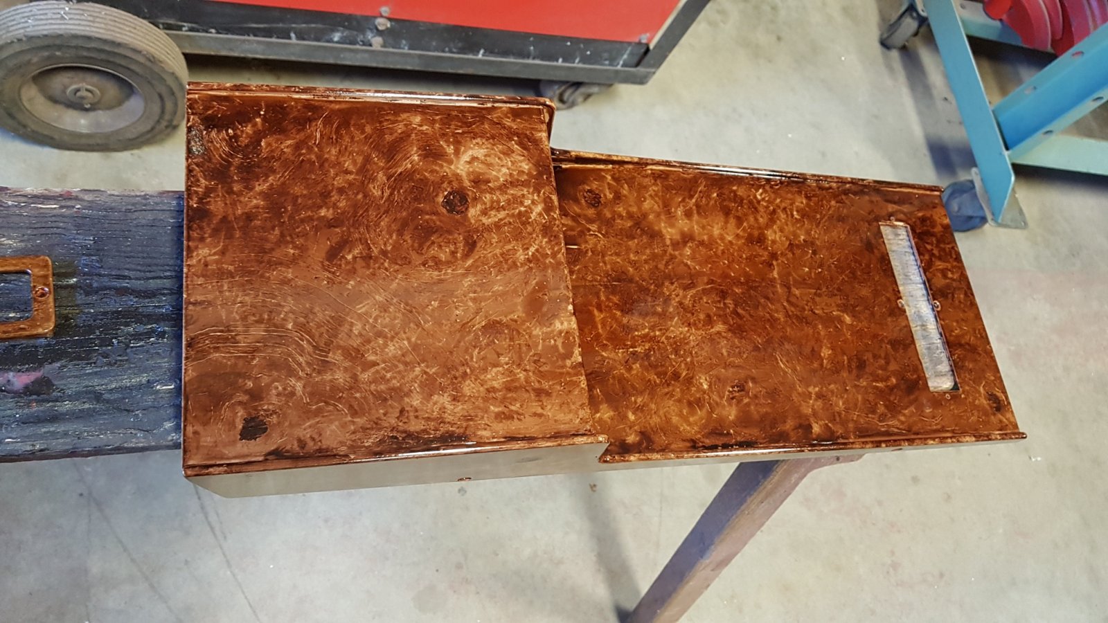

  6. @1-SHOT , @lake_harley , @hotrodA ,@A Boner , @Chainsaw chipper , @SS327 , @Budget36 , I know some of you guys have seen this, but thought I would edit the post to directly link all that expressed an interest in a "how to faux wood"...
    It'll be a few days before I get the next batch of interior pieces ready to faux burl wood finish...so to speed up the info being passed along...here are 2 videos I watched...I used the general graining process and the red mahogany stain color choice from this video:
    With the "plastic bag magic" shown in this video:
    As a side note, for the knots, I used the the same red mahogany color, but in the gel stain. I used way less "graining" than in shown in the second video.
    On one of my batches I didn't care for the finished look, so after letting it dry for a day, I simply wiped it all off with lacquer thinner and started again. Per the videos, the tan color that was used on my interior pieces to start with was the perfect base for the faux burled wood. I finish with a few coats of spray bomb high gloss clear.

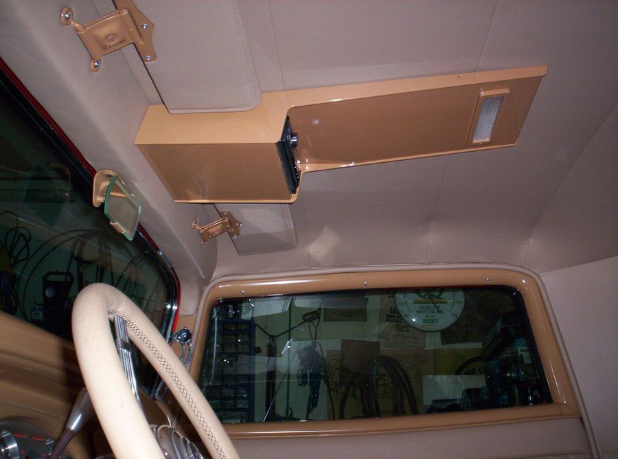

    And the rest of the garnish moldings and trim parts were detailed with more of burled wood treatment. While I'm not crazy about the overhead console, I had no interest in redoing the headliner, so it was re-installed. Here's a before and after comparison (albeit taken with different cameras, different light and from opposite sides of the car...but you get the idea).

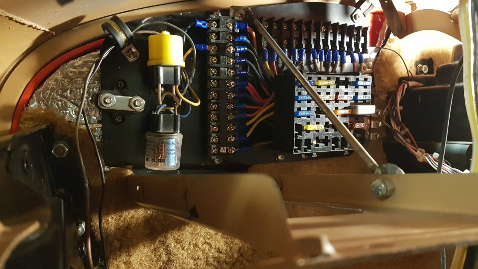

    Next up, still in the interior was a combination of the electrical upgrade and interior aesthetics. The dash had a couple of the plastic A/C duct vents hanging under it...this style.
    They worked, but I didn't care for the afterthought add-on look to them. The PO also went with a wide array of hidden switches and controls under the dash. There were rocker switches, toggle switches, rotary control knobs etc.. I appreciate the hidden switch style, but I didn't care for having to fumble around under the dash to find the various controls. i also didn't want to try and memorize that the rocker switch was for the windshield wipers, and the toggle switch was for the interior lights, unless it was the toggle switch on the right, then it was for the headlights etc.. So I decided to build a sub-dash panel that would hold the A/C ducts, all the switches (including the ignition switch that got moved from the column to the dash...more on that later), heater controls as well as incorporate a couple small storage shelves to hold sun glasses, a hidden phone charger, etc..

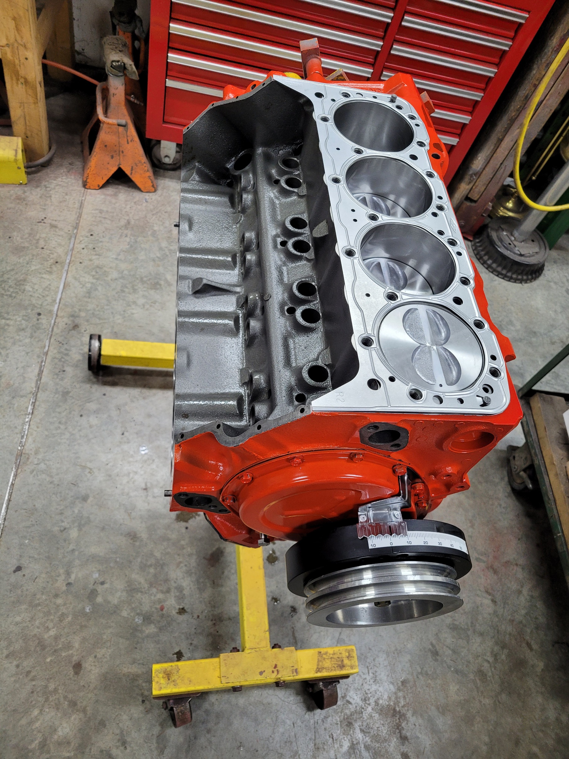

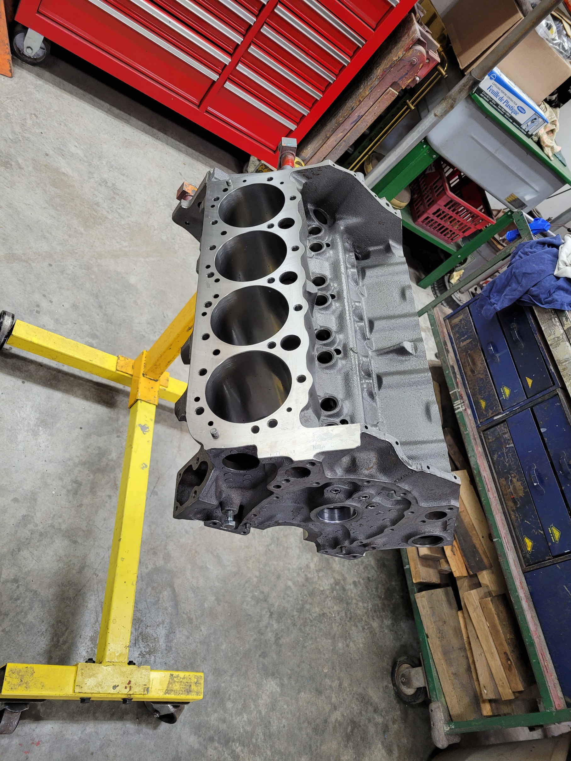

  9. After driving the car for the summer of 2023, I decided a few more upgrades were required before the summer of 2024. I felt the engine performance didn't meet my expectations. I got some lower than expected compression readings when tested and I thought perhaps the smogger era heads were holding it back. So, I found a set of camel hump 327 heads. They received a set of guide plates, screw in studs, fresh valve springs, guides, valve and seat grind and seals. I also gave them a mild pocket porting, exhaust passage clean up etc.
    Once I got the old heads off the motor, I could see however the fresh .030 bored 350 had vertical scoring in the cylinder walls. This was likely the cause of the lower than expected compression readings and was probably a function of fuel washing the cylinders of the fresh engine when the PO tried running the tri-power carbs the way they were set up. This culminated in him blocking them off as he never could get them to run properly. I remedied this as part of my earlier efforts (I figured if you can't get a tri-power carb set up to work, you better hang your head in shame and hand in your "I'm a hotrodder" membership card!). Anyway, the old short block got yanked.
    And, I began putting together another fresh short block to go along with the fresh heads. The block was bored .030", rotating assembly was balanced, received hypereutectic flat tops, a retrofit hydraulic roller cam etc..

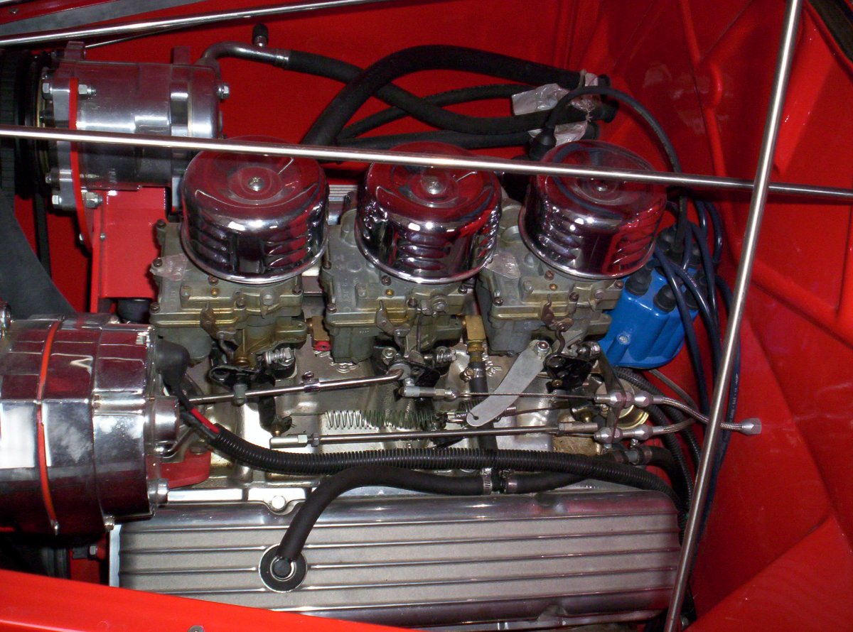

    I really wanted to run these cool polished and detailed Corvette valve covers along with the tri-power.
    But I struggled with excessive oil consumption through the PCV system during and following the engine break in. I documented my efforts in this regard in the following thread.
    https://www.jalopyjournal.com/forum...evised-pcv-baffle-in-intake-manifold.1313932/
    I still haven't resolved the issue other than by using the modern style finned aluminum valve covers with the built in baffles, breather and PCV holes. My theory is that the retrofit roller lifters throw a lot more oil around the lifter valley than a stock set of hydraulic flat tappets as they're taller and have the tie-bars. I'll get back to working on that problem in the future (I really like and want to use the early Corvette valve covers).

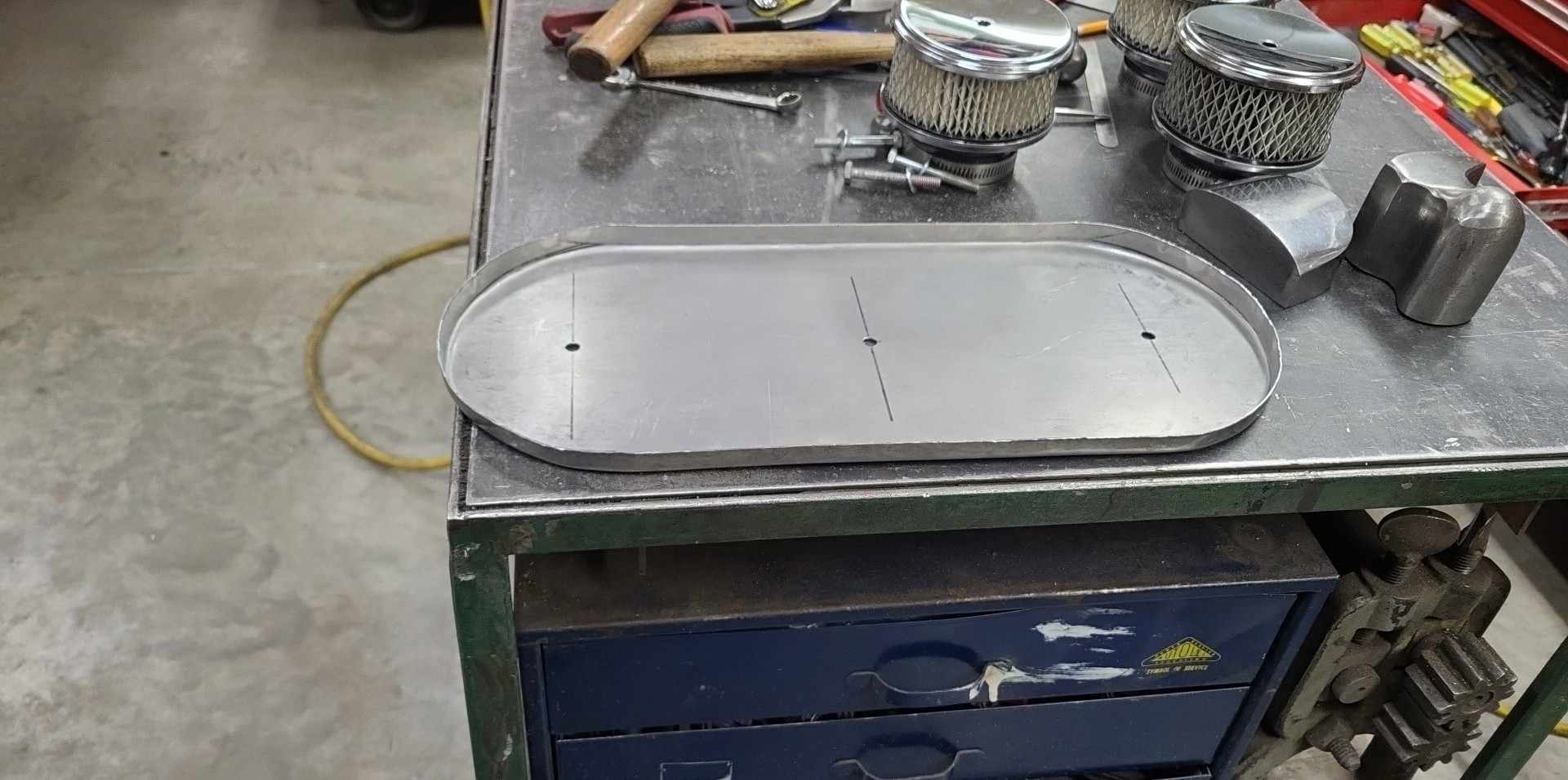

    Along with the fresh engine, I wanted to come up with something other than the three small individual air cleaners.
    So I spent some time hammering out and welding up a new 18 gauge mild steel air cleaner base (using plywood as a hammer form).
    received_956750025345121.jpeg received_947050919675762.jpeg 20240225_131748.jpg 20240225_131815.jpg
    Followed with some time on the bandsaw and milling machine that turned a chunk of 1/2" aluminum into a new top.
    After a bit of polishing and paint detail...and, after the engine was placed back in the car.

    Thanks...I posted the videos that I followed. It was a pretty easy and rewarding project...the secret is in the plastic bags used to dab the still wet brushed on stain. ;)
