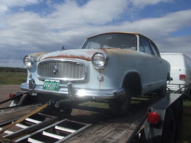

  4. Animal
    Joined: Nov 11, 2004
    Posts: 2,139
    Animal
    41,
    I found the car in the San Luis Valley, and the plates are 9 years expired, so it could well have come from La Plata County. I love living in Colorado.:D

    Hey Animal,
    I agree that your American looks very solid and clean. I can tell you that the stock front end is actually pretty strong and will support a v8. Problem is the front end parts can get pricey (trunions) and hard to find which ****s cuz you spend alot of money and you still have a Rambler front end... I have seen pics of a Rambler coupe with a straight axle from the 60's..but only that one. If your trying to keep it simple I would go with a small block. Get a 8" Maverick rear end..it will go right in. The trans tunnel is tight so you will probably have to open it up. Keep the steel wheels and dog dish caps. I am doing a 2 dr. wagon but I went really weird and went with a rotary turbo setup. Good luck with the car:D
