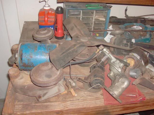

    while.....Well not much on TV and I found myself out in the garage with a wrench in my hand taking the heads off the flatty.... WOW what a mess inside!!!! Are they all this funky inside or did mine have a issue......cylinder walls where mirror smooth and everything looked to be in order (hell this is the first time I’ve seen the inside of a flatty so who knows)
    pics
    and the carnage
    well I guess ill look for a builder
  2. Don't touch the build-up in the lifter valley-nasty lead deposits. Take a rotary wire brush to the deck between the valves and cylinders. Get down to shiny metal and check for cracks running from the valve seats to the cylinder walls. May cause problems. Cracks between bolt holes and water holes on the deck are no big issue.

  4. That's the time honored Flathead sludge. Old type dino oils, no PCV and not running the engine till hot enough along with prolonged oil change intervals does this.
    STD stuff for an old Flatty.
    RB is right, wear rubber gloves as this shit is old toxic stuff - handle with care if youre gonna clean it out.
    Are you going to rebuilt this engine? If so, dont bother cleaning out the sludge. Just strip it well, remove all the oil gallery plugs front and rear of the block, get it hot tanked then magged for cracks.

    From the pics it looks like an 8BA, 8RT or 9CM engine. With the relieving done it should make a great breathing motor when finished. Just have it hot tanked and magged before you start spending much money on rebuild parts to assure it is crack free. Oh yeah the sludge is a piece of flathead history.

    Plug number one...
    ...and plug number two.

    8BA's only have plug #2. #1 is for 59 and earlier engines.
