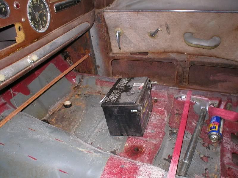

    Awesome!! I would like to see how close/far things line up from the floors to the rockers.
  7. When I head back out there tomorrow, I'll take some pics (there's about 18" of snow on the ground I don't feel like wading through again).
    The Hudson has sort of a perimeter frame, where the rockers are about 6" tall and circle the perimeter of the body in sort of a horseshoe shape. It actually goes on the outside of the tire, although it gets much thinner around the tires and across the back.
    I cut the donor car's rockers and pans about 1" on the outside of the frame rails. This puts the frame of the donor car about 2" inside (on each side) of the Hudson's perimeter frame/rockers.

  23. And a couple of the interior / frame rail section showing the gap I'll need to close. Things match up pretty freakin good...
