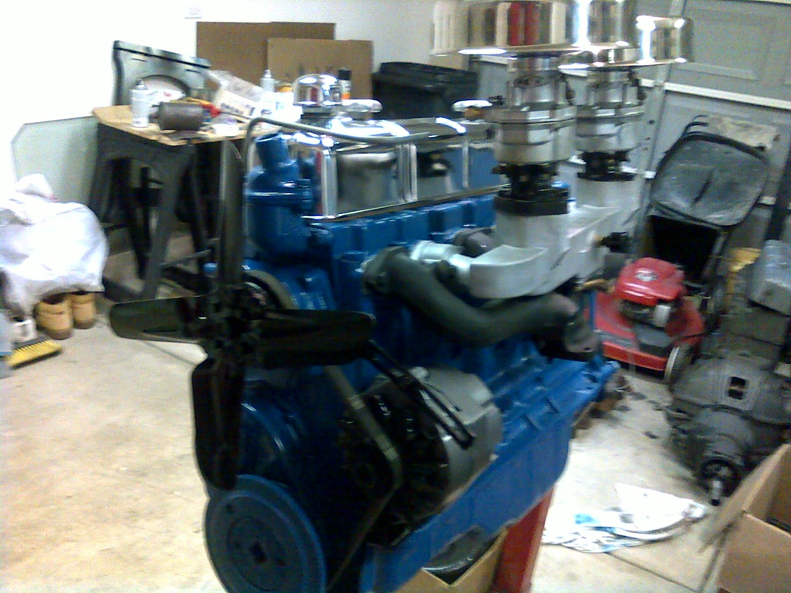

    Well it's been a lot of work and sweat and thrown tools...but it's just about ready to drop in!! I am figuring 2 weeks from today (July 18) if anybody in the Joliet area is willing to help please let me know!! Sorry for the quality of the pics, they are cell phone as my nice camera is in the shop for God only knows how many more weeks!! Thanks again for all the help and the kind words, without you guys I would still be lost!!!

    I can tell you when I put my 235 in my 54 it is a hella lot easier with
    A: hood off
    and
    B:go to harbor freight and get one of those fancy engine leveler thingies...
    also as much as it makes it easier with the hood off, if you still have the springs on yours just go ahead and leave it on.
    it is probably waaay harder to get those springs back on than to set the engine in with the hood on.
    the leveler will help you keep the engine from wanting to dump on its side.
    oh yeah one other thing,
    I personally found it to be rather difficult to put everything in with the intake on...
    food for thought...

    Hood springs are still intact and we pulled the motor with the hood on, and found out that it's a nightmare to put them back on. As far as the intake is concerned I am going to try and leave it intact, 'cause as you all know these things are a pain in the ass to put on with the motor outside of the car....and damn near impossible once in the car!!! Thanks for the kind words!!!

    I'm getting ready in the next week or so to put the 235 back into the '53. I left just about everything off externally, since it will be easier to get it into place. Intake/exhaust are off and will go on when it's inside, as well as all of the linkage and the starter.
