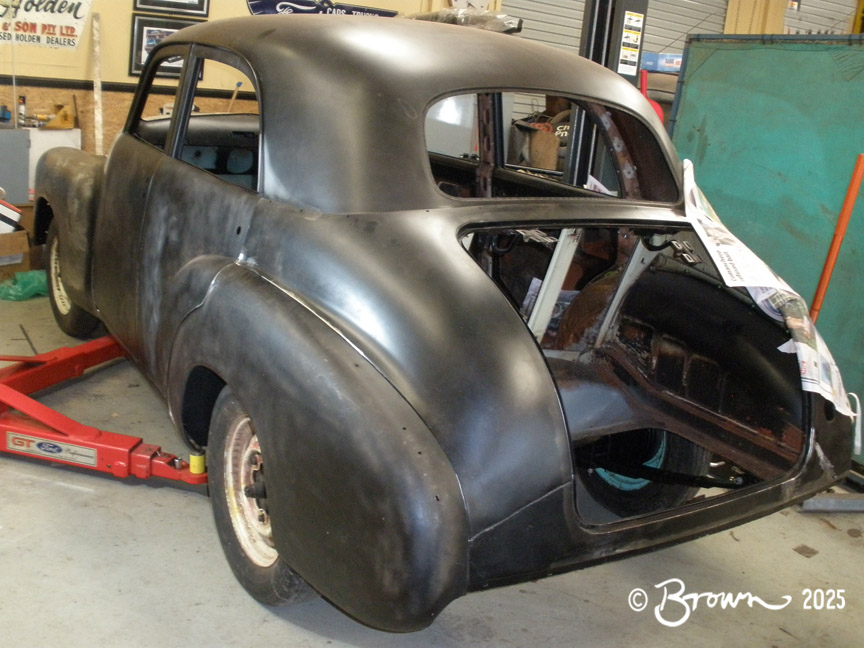

    Here it is in June last year, out of hibernation and on it's way to the shop where my brother and friends are helping me fix her up. I'll post updates in the next day or two, it's late here. There's a few twists literally emerging in the fix, you'll see.

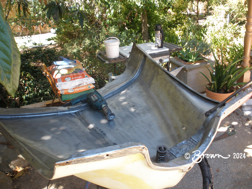

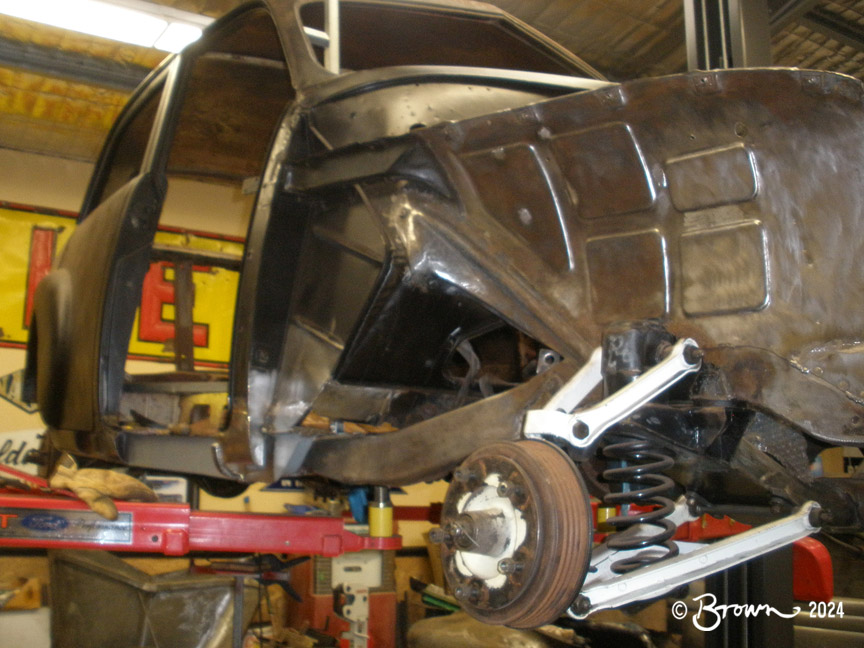

  3. I'll prolly be playin' catch-up more often than not with my lo-fi photo entries. We started this thing off with me & my pal Mark stripping paint back to bare metal, one panel at a time, by nhand with tungsten blades, or with paint stripper. This is a '56 Holden, last year of this first series which debuted in 1948 in Australia. These, believe it or not, were, and still are extremely popular, kinda like the '55 Chevy of Australia. They still have a big following and large dedicated club network . 240124FJ1.jpg 240124FJ2.jpg 240124FJ3.jpg 240124FJ4.jpg

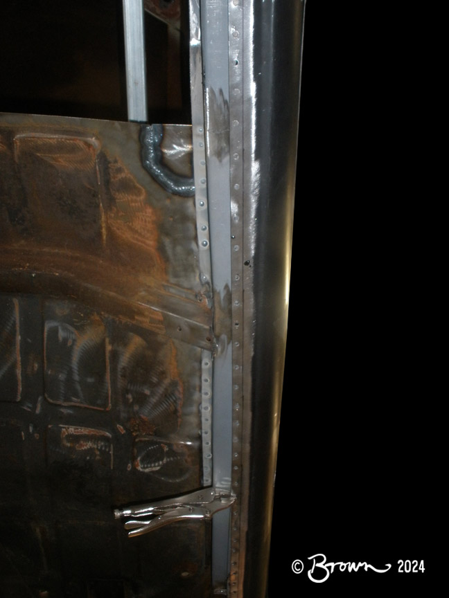

    The stripping was the first thing. The budget is modest on this build. I'm leaving the front clip on. Most parts in the front end are new/ restored but I will go thru & re- check later. Stripping has revealed rust/ damage in
    • cowl vent. attaching hinge broken. I found a cherry cowl vent in a now-gone yard of 2500 cars, then lost it. The next day we knew someone going out there to the yard and told them of it. In this massive old yard, they found it and bought it for me for 30 bucks.
    • left hand inner & outer sill, rear dogleg- collision and rust. rear LH corner of car crushed 1/2 inch inward. More soon.
    • rust in rear lower roof area L & R and LH upper trunk channel
    • rust rear RH body lower corner
    • front floors gone
    Plus a few minor areas in fenders
    Some blasting here & there (inner fenders, doors, hood)

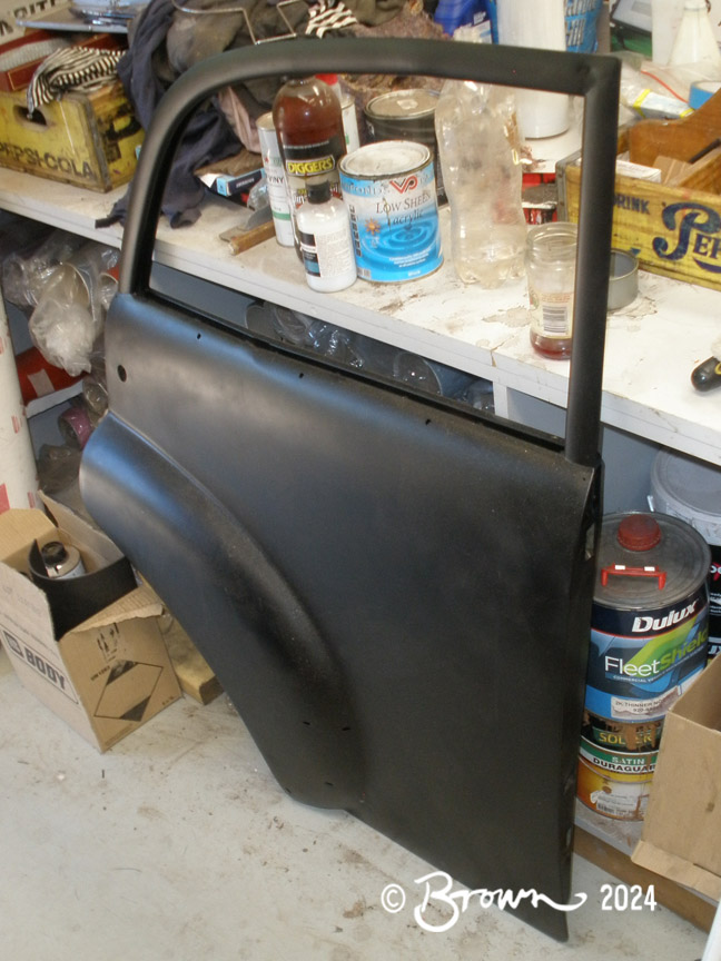

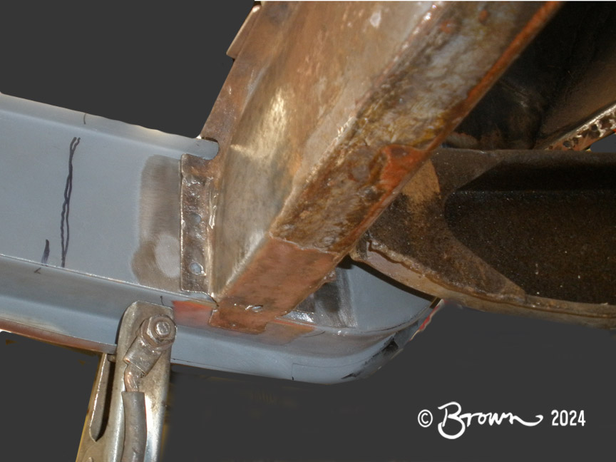

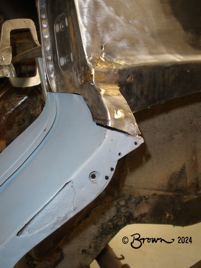

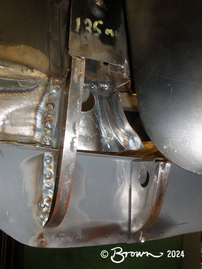

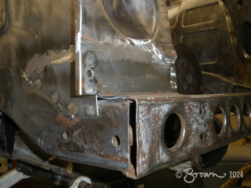

  4. Tomorrow, we are installing a new inner LH sill. This follws intense repair to dogleg & B pillar & door aligning the last few weeks; This is a photo before we started; 240331FJ1.jpg 240331FJ2.jpg
    yuck. Door always needed a good slam. big crease is seen near that wood tip 240331FJ3.jpg
    The primer grey panel was cold chiseled out of a donor car in 1984. finally using it.

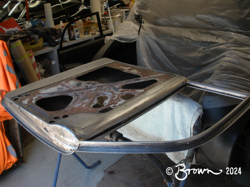

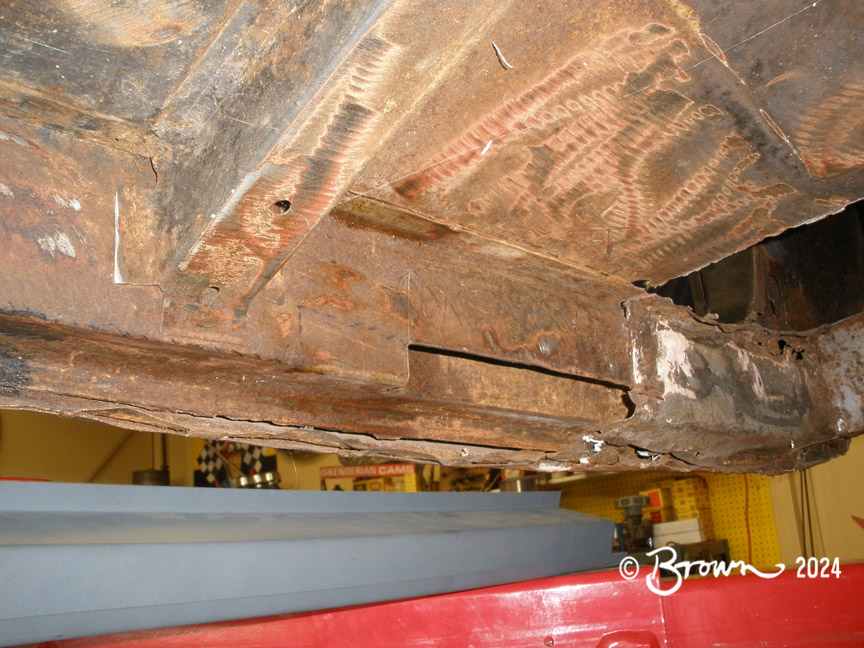

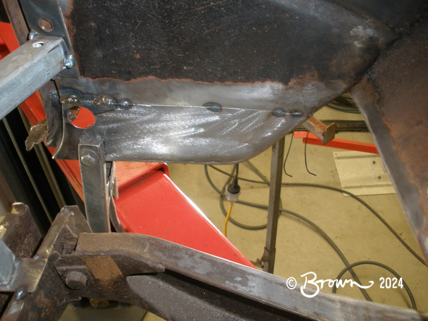

    This is how the LHS looked before repair, looking rearward. A new outer sill had been roughly installed in '83 in order to make the car look OK to any cop's eye (from a distance, obviously). I had done a nice thick Bondo job here. Seemed a shame to scrape it off..
    rusty wheelwell replaced- first welding job
    These chassis-less cars are light (2280 lbs). So brace yourself before you hack.

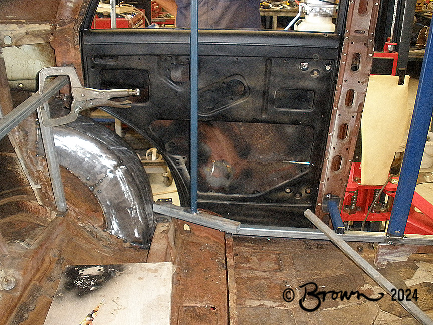

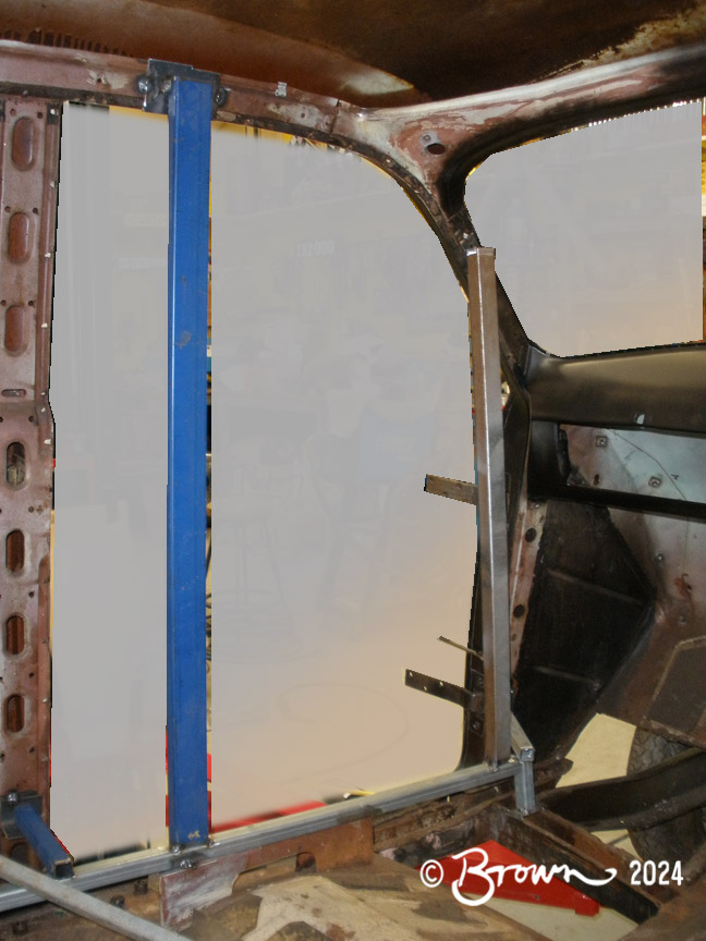

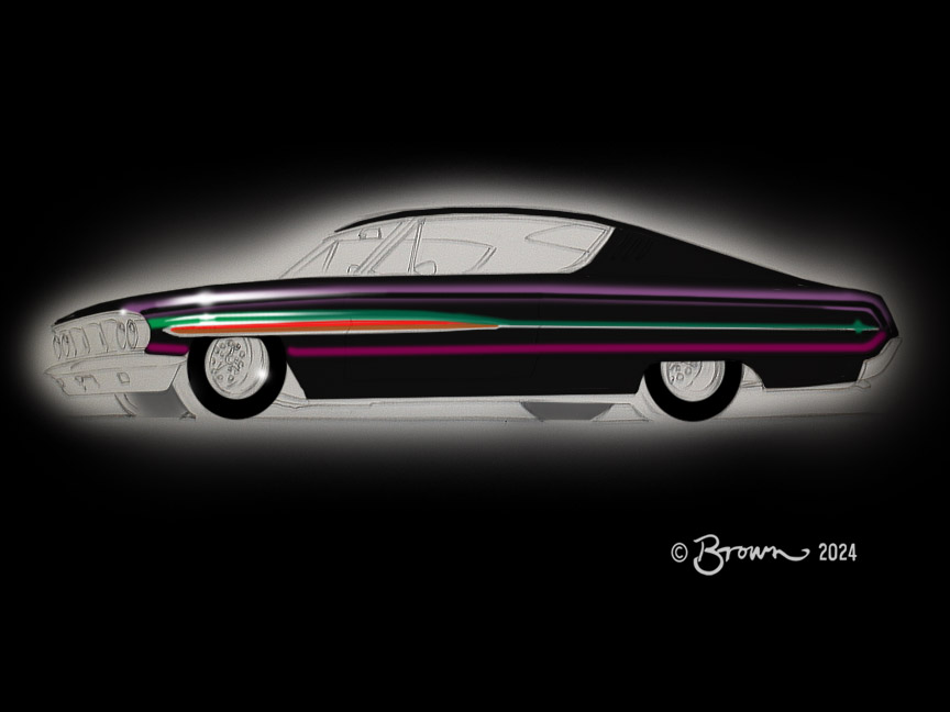

  5. Installed (tacked) inner sill on this fucked-up LH Side yessdy. We've lost 8,9 or10 mm somewhere between inner & outer sill. WTF. Also Had an alignment issue with LHR door window pillar channel, which appears to be corrected using a hydraulic jacK & wood bearers as per workshop manuals. 240509FJ1.jpg 240509FJ2.jpg 240509FJ3.jpg 240510FFAFF1.jpg 240510FJ1A.jpg 240510FJ2.jpg 240510FJ3.jpg 240510FJ4.jpg 240510FJ5.jpg 240510FJ6.jpg 240510FJ7.jpg 240510FJ8.jpg 240510FJ9.jpg 240510FJ10.jpg 240510FJ11.jpg 240510FJ12.jpg
  6. Whoops, sorry for the '64 Galaxie drawing.
    down-the-road and Sharpone like this.

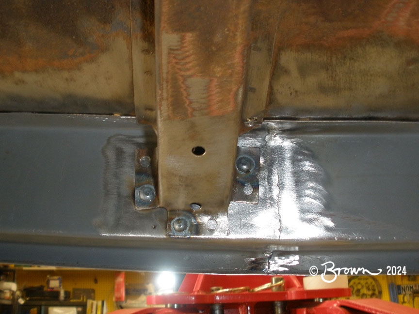

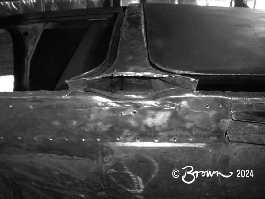

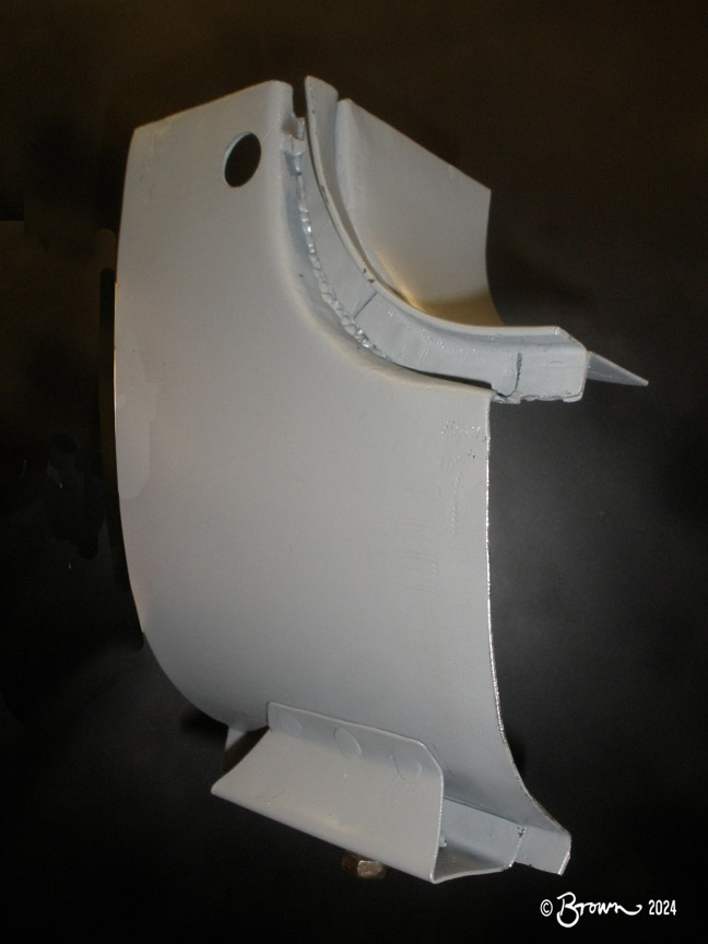

    Nicely hand-fabbed 'A' pillar base (LHS).

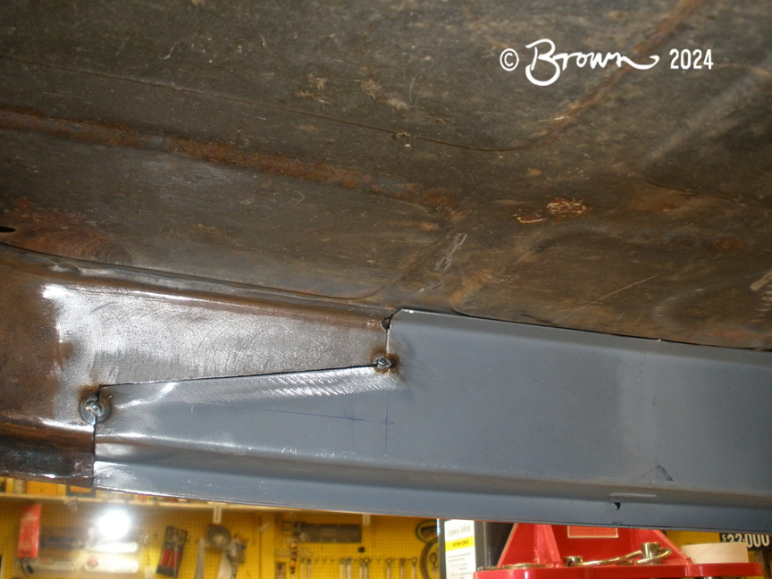

  9. So we have the rear dogleg buttoned up and spent Thursday standing around figuring how to find 1/2" between the floor and the outer sill, which we intended to tack in. This has occupied us for a few weeks, no, longer.
    We deduced that the sill (repro) was a pretty crude thing, with tired die pressings. Nevertheless, a bit of heaving and muscling (by hand) on the bench, and I managed to create a roll in the panel to the point where it all lines up pretty nice. We went for coffee after that work and I forgot photos- next week.

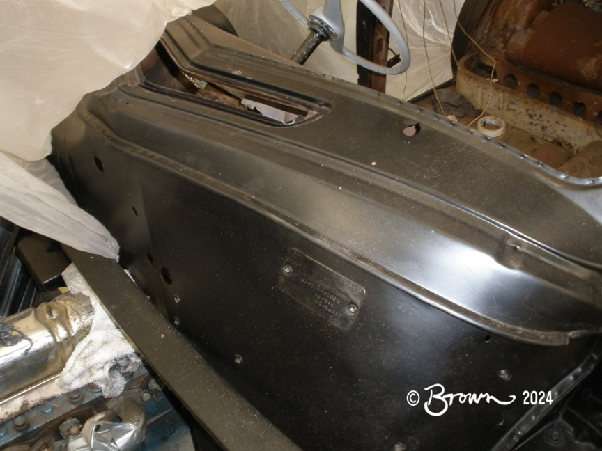

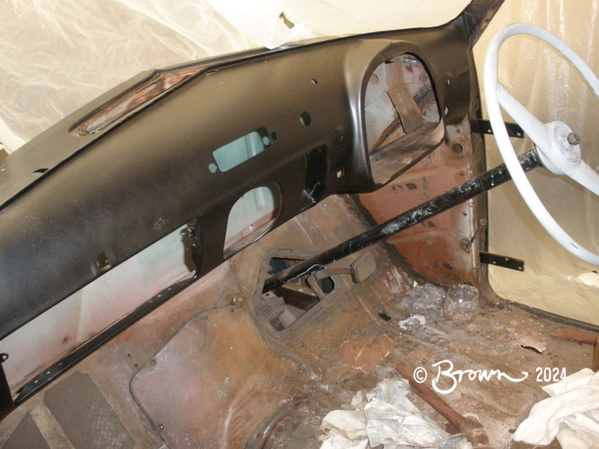

  11. So today Geoff apparently buttoned up the outer sill. I was not there. I was there yesterday, doing the goofy classic chore of scraping crap off the underfloor, subframes etc. I tracked grease all over the new paving and later on at Mom's place for dinner, so I was a popular boy.
    Geoff is looking forward to wrapping up this LHS, it's been a twisted rusty mess. How the car did not break on the transporter over to where it now sits- who knows? A few stitches of weld held fast..
    Most of the servicable components in the front end are new, just thrown in. Stripping the gunk off the underside of the car is a job for a rocket-scientist like me, with a tungsten blade, pain, and swear words.
    240607FJ.jpg 240607FJ2.jpg 240607FJ3.jpg 240607FJ5.jpg 240607FJ6.jpg 240607FJ7.jpg 240607FJ8.jpg

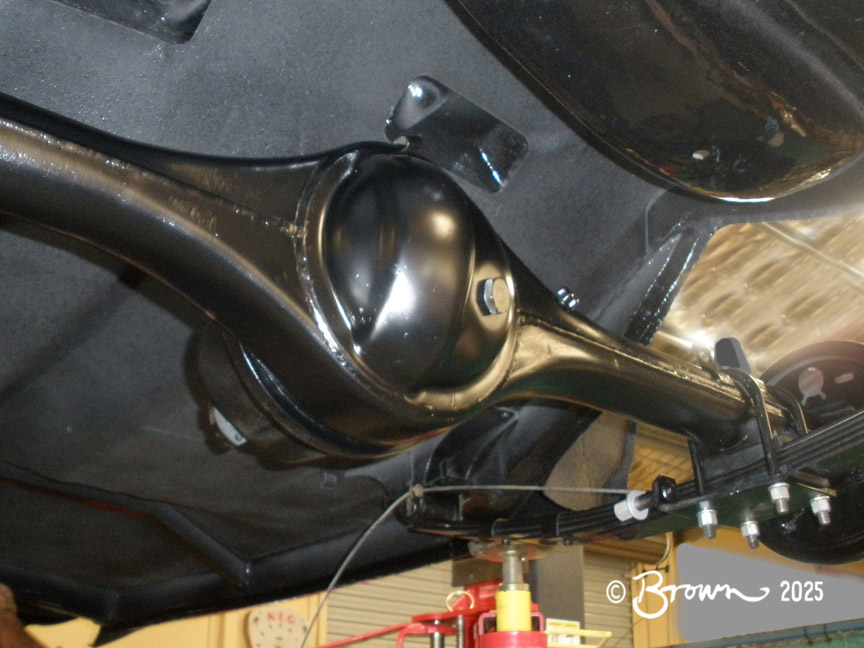

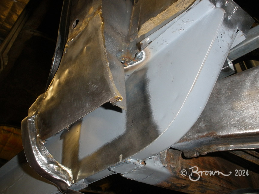

  26. Of course the right hand side of the car appeared OK. Until we went to install a new front floor. So, order more sill panels and get to it.
    While the welding is going on, I have organised my shed into a workable (barely) space. I am organising things like all hardware restoring/ reconditioning, replacing. I have been concentrating this last week or two on the doors and anything to do with them.

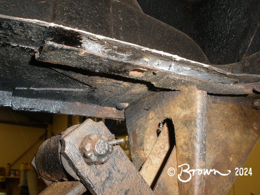

    Last photo shows an area of concern- rear spring hangers. Want to make sure this floor which was 'fixed up' in 1984 is a stable platform for the spring hangers.
    240922FJ2.jpg 240922FJ3.jpg 240922FJ4.jpg 240922FJ5.jpg 240922FJ6.jpg Gotta make new buttress brackets 240922FJ7.jpg Back corner RHS 240922FJ8.jpg hole is for gas tank.

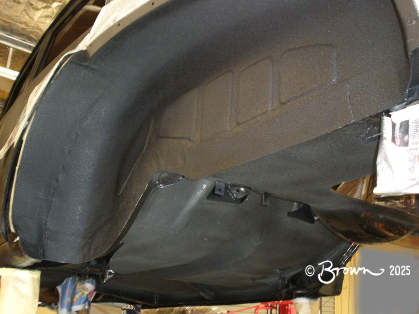

  30. Sorry it's been so long. The floors, rear wheelwells and boot are buttoned up, epoxied, Shutz'ed. Rear end painted, Northern Springs here in Willaston reset my rear leafs 2" lower. I like it. Next, throw steering box back in, get the thing off the hoist. Treat & KBS roof underside. Then straight into bondo/ paint. Little devils are enticing me to do wild paint- but think I'll stick to original 'duo-tone' Frankston cream with cream/corella green (Duco 'Metallichrome') interior (green door caps/ window surrounds/ dash top. Keep Mum happy. 250226FJ1.jpg 250226FJ2.jpg 250226FJ3.jpg 250226FJ4.jpg
