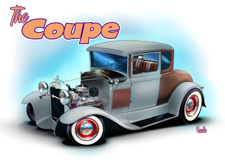

    Something like this? I do like it, but;
    • The car is historic to my family , my city, my country- I now like the idea of people relating to it in those contexts
    • My nephew is building a Holden six- powered gasser
    • My build budget is miniscule
    • This is my first, and possibly only project. I'm over 60 y.o- I'm impatient.
    • I'm building this car remotely- keep it simple
    • I live in a nanny state- I have to have an engineer inspection/ pass to put a seatbelt in this thing. So you can imagine the red tape a chopped top draws.
    I'm going super mild custom, basically like a bomb style. I want to take my ageing mom for a drive in it. And use it as a Sunday Cars & Coffee cruiser. It will carry my art gear- I draw & paint cars on Sundays, all week in fact.

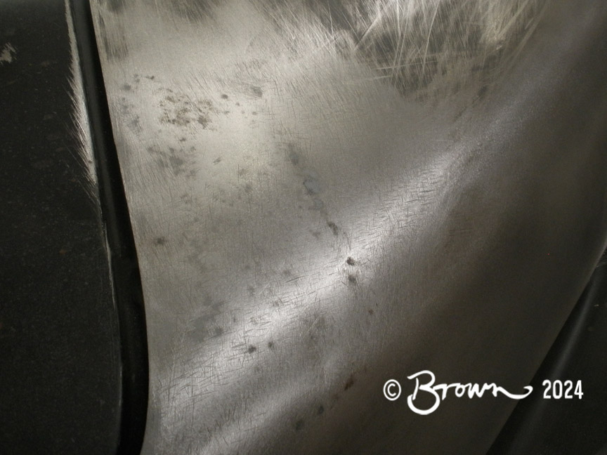

    Here's the first etch coming off LHS to make way for the 2K hi fill. Help! How am I going to get this thing into paint by mid/late May with little/ no bodywork skills? I have some ready-to-hand advice (advisors). I've even considered the 'fauxtina' cheap trick, but no, not that. My original vision with the low budget was nice paint in the interior and engine bay. Anything else a bonus.

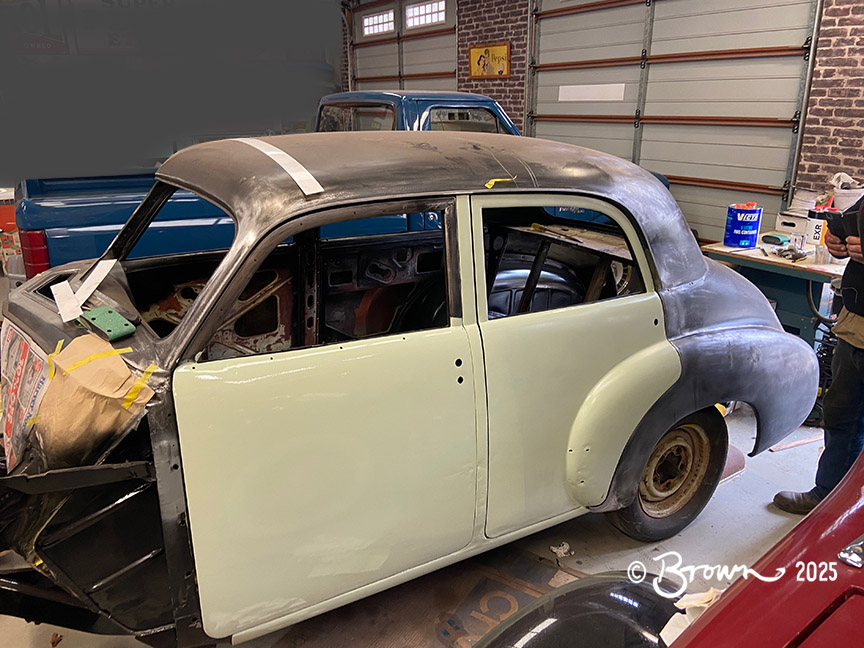

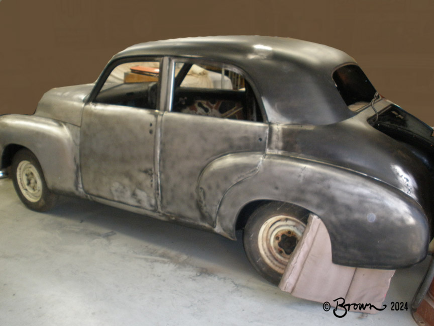

    Autumn (fall) here. The leaves will fall soon. Winter is in mind as it approaches. The race is on to at least get this thing sealed in undercoat before the wet weather sets in.
    I'll be glad to see the back end of this KBS black sealer. It's great stuff, but you must be so careful around it. It's nasty without a mask, esp if spraying. Mask up. Tv-Vek suit. It gets everywhere. It oxidises HARD, so when you scoop it out don't get any on the can lid or you won't get it open, and whatever is in the can will solidify. I've thought of argon-ing the can lol.
    Masked off the front clip and painted it as well as hood baffle, engine mounts, fender stays & engine fan. There were logistic fuckups- I ended up brushing it on with a 1" brush. Any grit in my prep got dug up & ended in the paint. I was distracted and did not stir it well enough, so it went on thin.
    There is grit all thru it. I thought it would take possibly a long time to cure, but it is hard now.
    I will regroup, and go back when I can, cut it with #400, and re-coat with a gun, and finish with gloss black in the bay. Hopefully it all works out this time and we have a nice glossy black bay. I have shutz to shoot on the outside of the bay. It's grey, too bad. It's all I have. Prolly rattle it in black later.
    Messing around with other bits & pieces all while readying for undercoat session looming in a week or two.. Hoping the clutch is OK- has a minute scuff on one disc, and some tiny pit on the face. I think it will be OK?

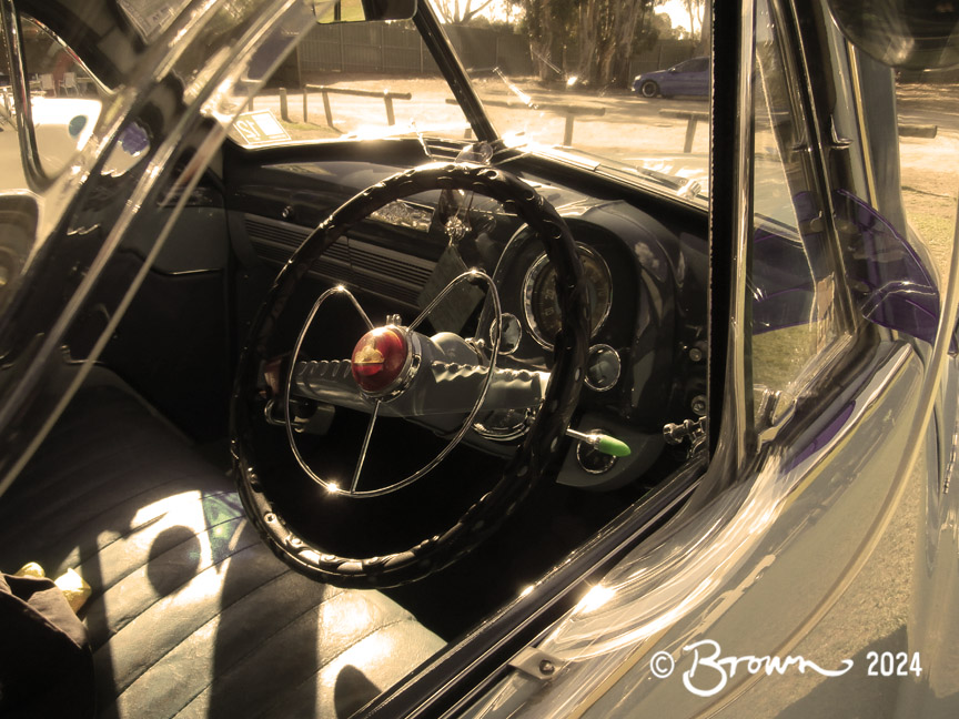

    Loaded FJ seen at recent GM day, same spec as mine, 1 year older, this 1955 one in leather, mine has the new wonder fabric - vinyl.

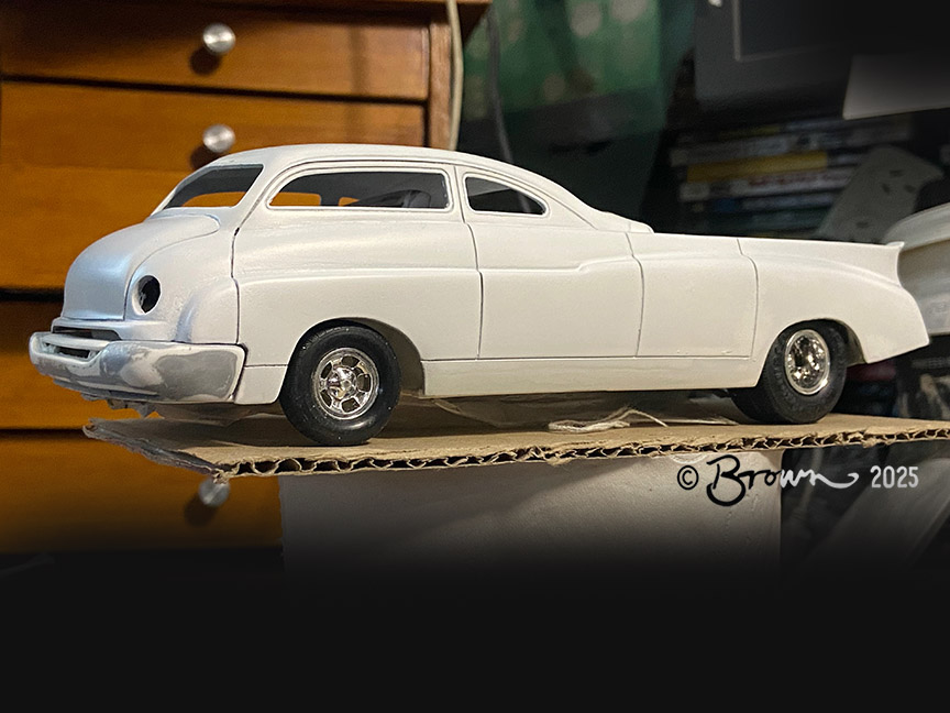

  21. Next up is a walk-around with a welder, finishing off little things here & there, fill a few trim holes in trunk lid & doors. The belt line trim stays. I've never been keen on the brightwork around the door windows, so bye-bye for now. I've got all the pieces, they will go into a box in the rafters.
    Did not do much during the covid thing. Messed around with my Model kit Mercury coupe, which kinda turned into a truck..

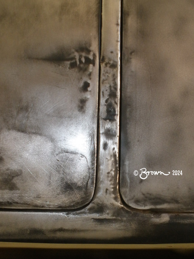

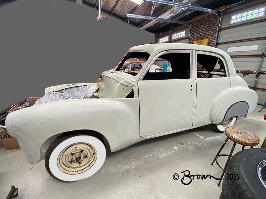

  22. Whoa, July last post.. Got a covid illness, wiped me out for a month in aussie winter. So I've been plugging away applying 2 pack undercoat over cleaned bare metal, with a roller & 1" brush. Watching weather data points so as to be successful re humidity/ dew point. All sanding of bare metal/ primer by hand- no power tools. Keeping dust down.
    Messed up the hood outer with hasty prep ( did not remove phosphoric acid well enough)- had to strip it & re-do. I'm nearly ready to go with Bondo having applied 2 coats to pretty much everything with 180 grit rub 'tween coats. LHS of car as shown is rougher than RHS of car. Overall, it OK, a lil' bit of welding of a few holes still needed. My bro has done all welding/ fab & helped with primer, as well as constant advice. It's largely his work, this car. In his shop.
    Car is nosed & decked, apart from tailight, which is singular & in stock central location. I'm in a restorer- heavy club- this car may raise some eyebrows with it's lowered springs and various subtle changes.
    Getting warmer here now (Spring).
    Last pic shows cowl vent & steering column jacket. 251004FJ1.jpg 251004FJ2.jpg 251004FJ2b.jpg 251004FJ3.jpg
