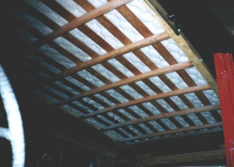

    However, the '31 I restored with all recycled/scrounged/free wood, except the door hinge pillars and dashboard crossmember that I bought from KC wood in NC. As we speak I know of 3 cars just like it, slammed, IFS, V-8 Hotrods, with the wood intact in the body.
    I scrounged the rest of the wood in that car for FREE. The top slats are 1/4 inch plywood from a wood crate I scrounged, the sills were foundation for a crate that a lathe was shipped in. It took me about 6 months to scrounge up enough s**** oak and other hardwood and did it all with a crosscut/rip saw, bandsaw, a joiner, and glue and clamps. My '29 custom has mostly recycled wood at no cost, combined with steel in selected locations.

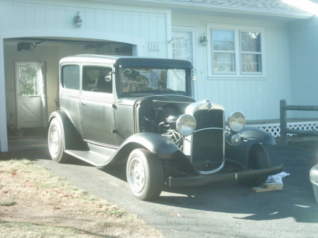

  7. Everyone thinks mine is a Chevy at first, but it's Chevy's big brother-Pontiac-a 1931 ( pic in front of old house). Same wood as a Chevy, but it's now a hybrid:D, replaced all the bad wood in the floor with square steel and sheetmetal as well as put steel in the rumble seat area. But, I left all the solid wood in the sides, top, and doors, replacing only some small pieces in the bottom of the doors.
    The other pic is my other Pontiac coupe-a 1930 that has all the original wood including the spoked wheels. Some of the wood in the top around the fabric cover is getting alittle crumbly but still pretty solid thanks to sitting lost in a barn from 1959 til 1999. Since then its sat warm and dry in my shop unless I feel like taking it out for a spin on sunny days.

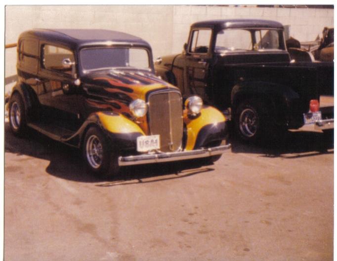

    here is a photo of a 34 chevy sedan delivery that we built in 1978 when I worked for california street rod, It had a454,T400,cruze,ac,ifs and irs.
    It was owned by chuck lombardo.
