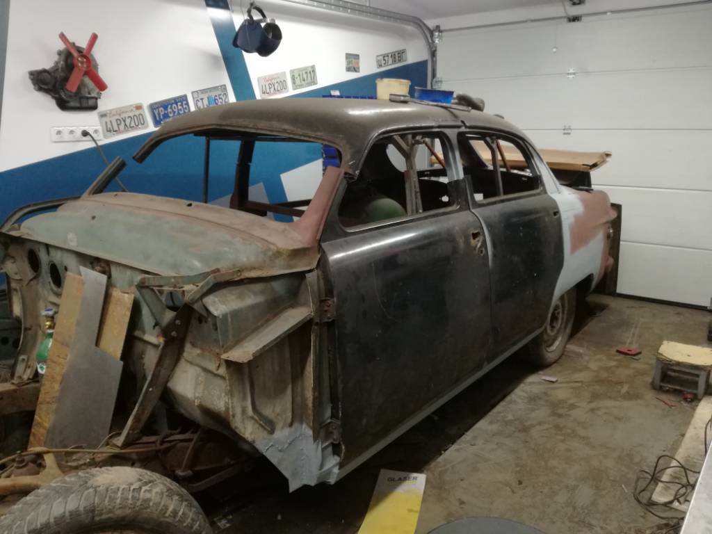

  12. Trefl
    Joined: Dec 6, 2012
    Posts: 93
    Trefl

  14. Justin Terrell
    Joined: Jan 22, 2007
    Posts: 44
    Justin Terrell
    YES!!! I love the 4-doors!!!
    Trefl likes this.
