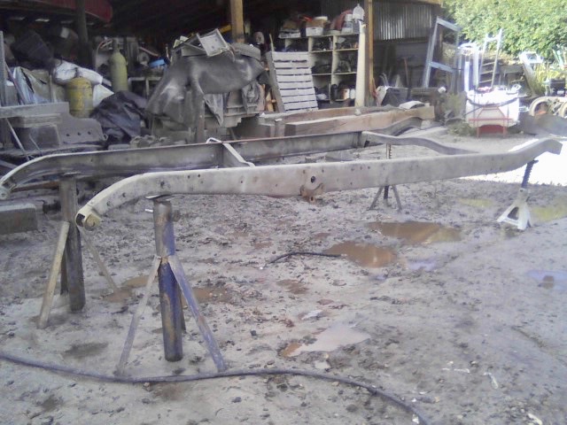

    I used a wet blaster I got from eBay. It kept clogging then I found there was a piece missing. Once it had all of its parts it worked pretty well. There is no dust like in dry blasting. It also doesn't get a hot. It took a LOT of sand and made a muddy mess but removed most of the rust from my frame. I messed around and it re-rusted some. I finally put it is a citric acid soak . That removed the flash rust & the rust in places I couldn't get to before. Your idea sounds interesting. Having better control of the sand would be good.

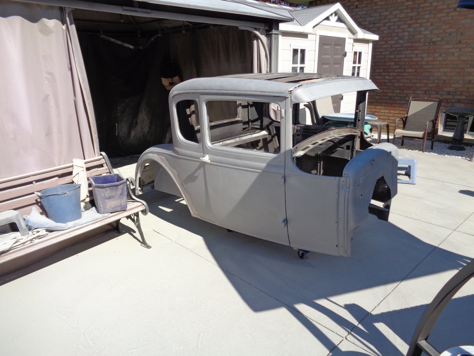

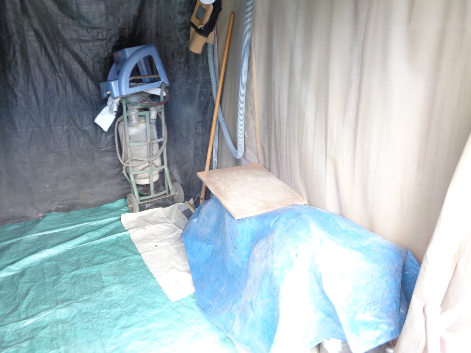

    I have done several complete vehicles and countless other parts and projects with my homemade pressure blaster over the last forty years. I believe I have perfected the process for a small at home operation. Using an old gazebo for containment, a repurposed 60 lb propane tank configured with an air ***ist media feed, similar to what was depicted earlier and a fresh air supplied face mask, which keeps visibility at a maximum (no steaming up), keeps dust out of your lungs and feeds cool fresh air through your coveralls. Even on a 95 or 100 degree day it is comfortable. I prefer recycled gl*** for the finish, non panel heat/deformation and speed of rust & paint removal.
    Just thought I would throw my thoughts out there even though I have no actual wet blasting experience. Good luck with it!
    The closest example to what you are planning would be my Model A coupe which I blasted inside and out over a two day period (6 hr days), including all four fenders. the hood, dash and all other interior garnish pieces.
    What I have found to be the absolute most important thing to perfect is an ample dry air supply. I have posted my system before. DSC06146.JPG DSC06119.JPG
