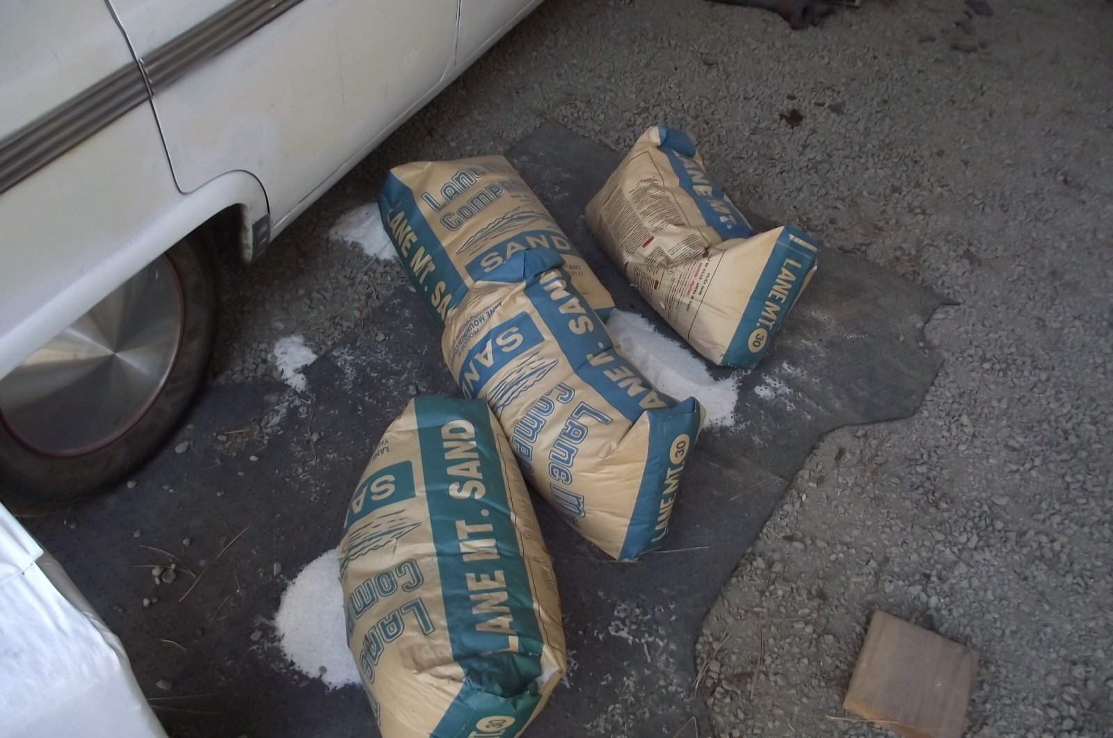

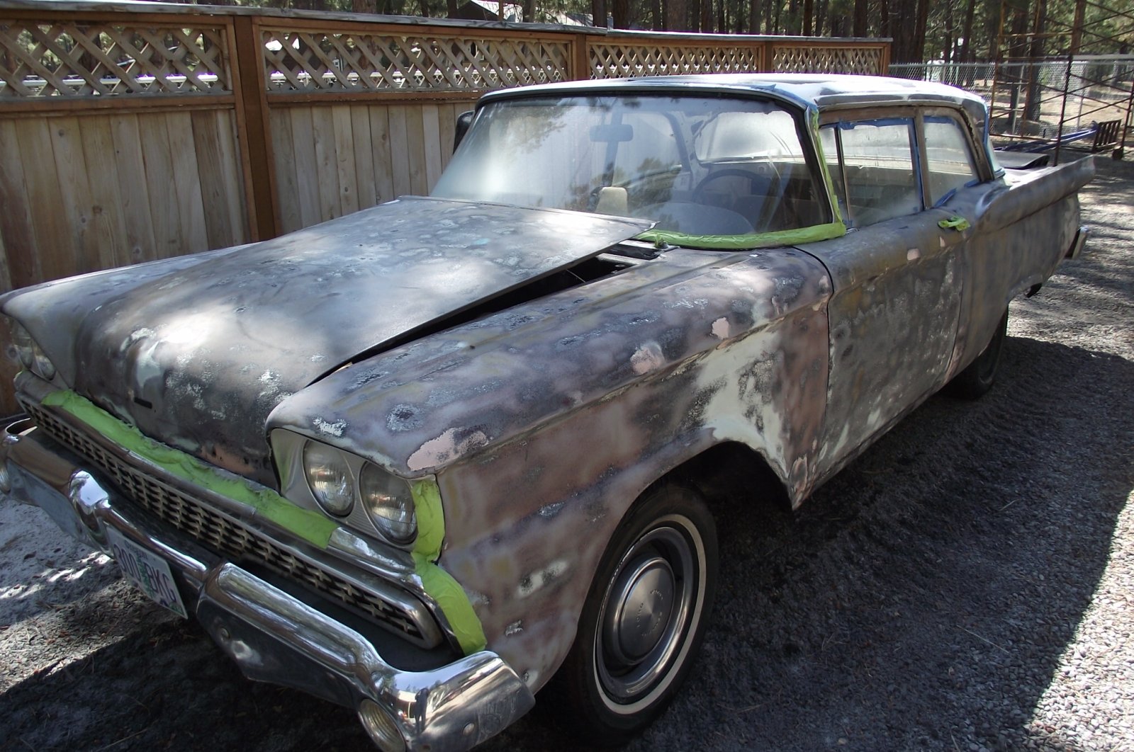

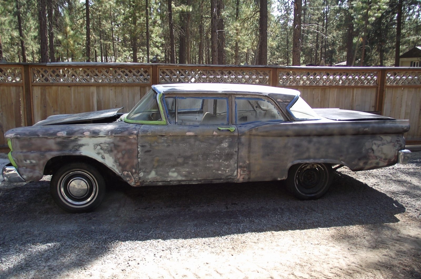

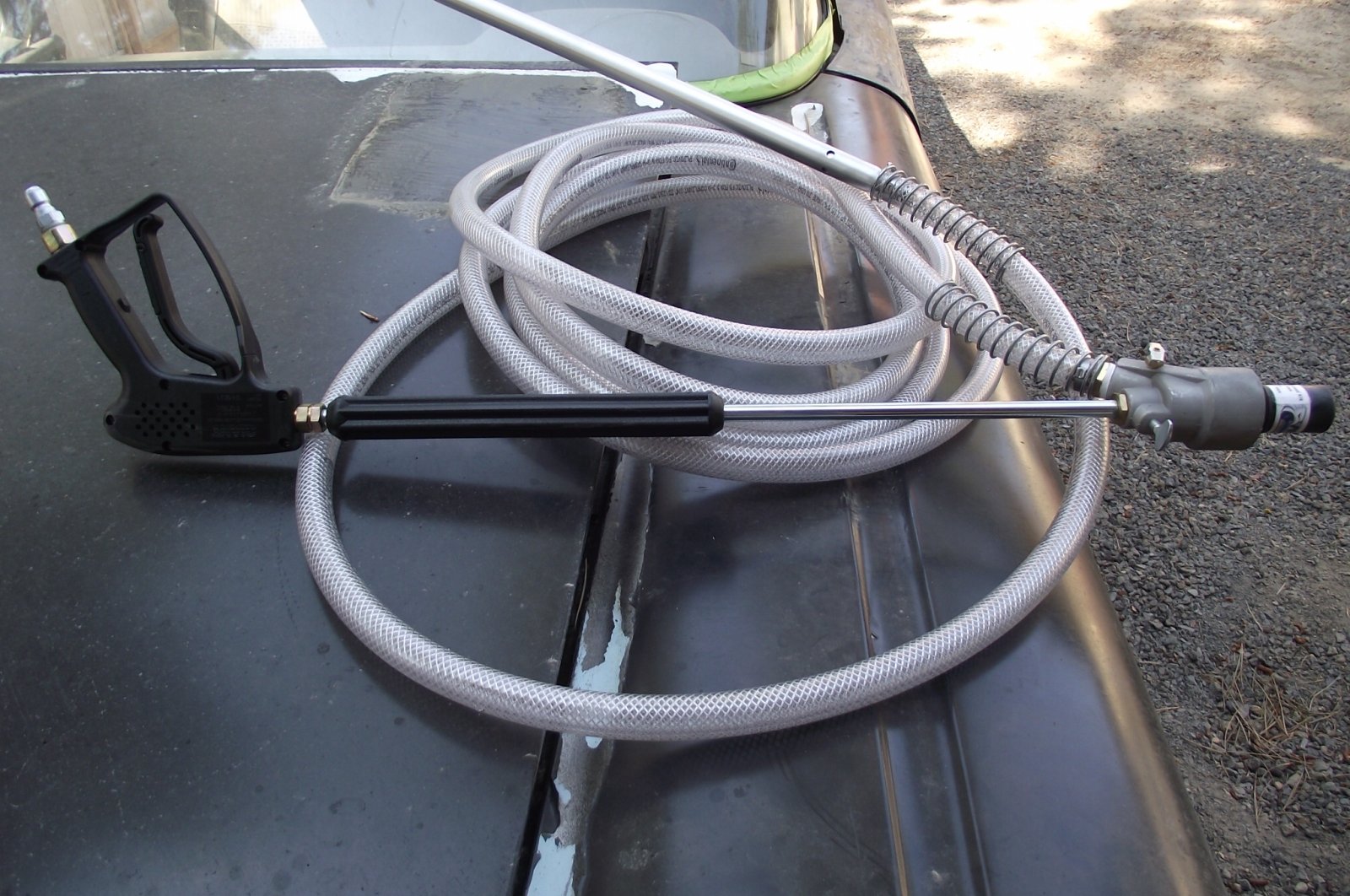

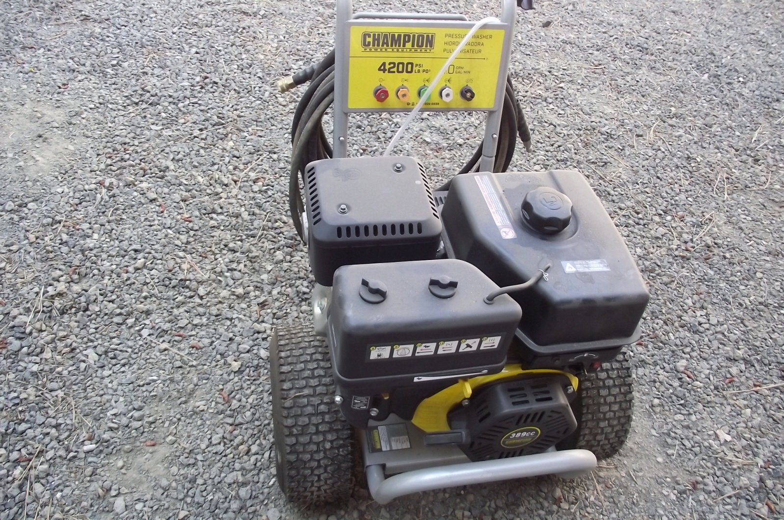

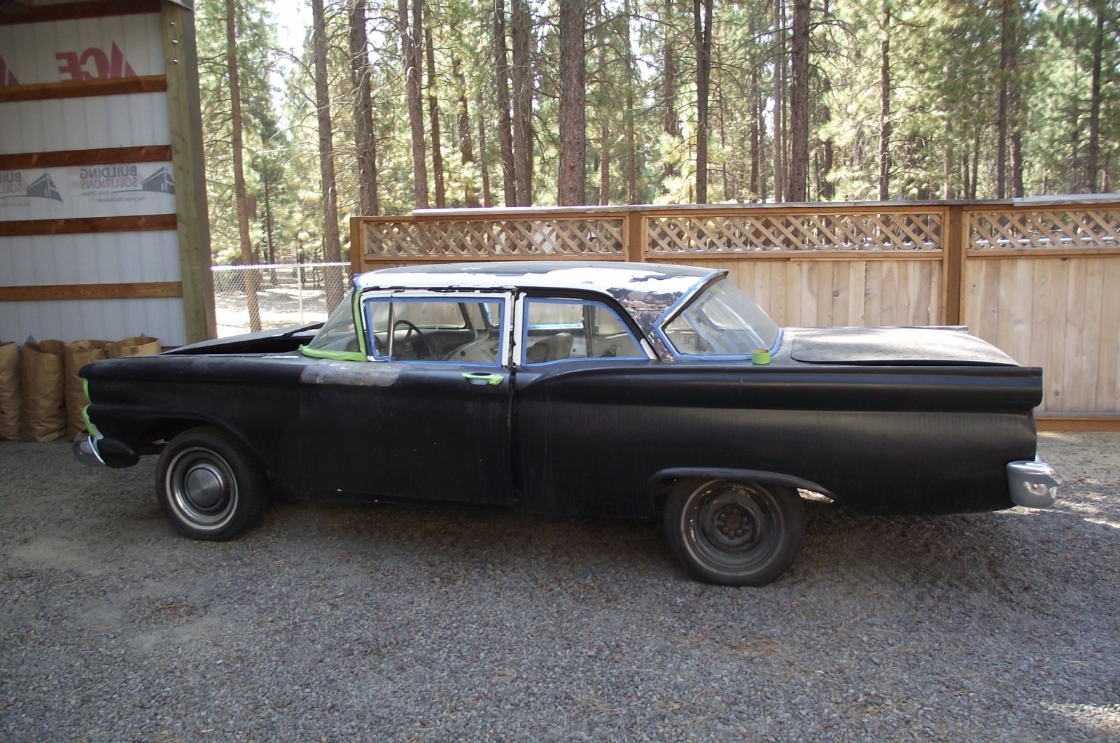

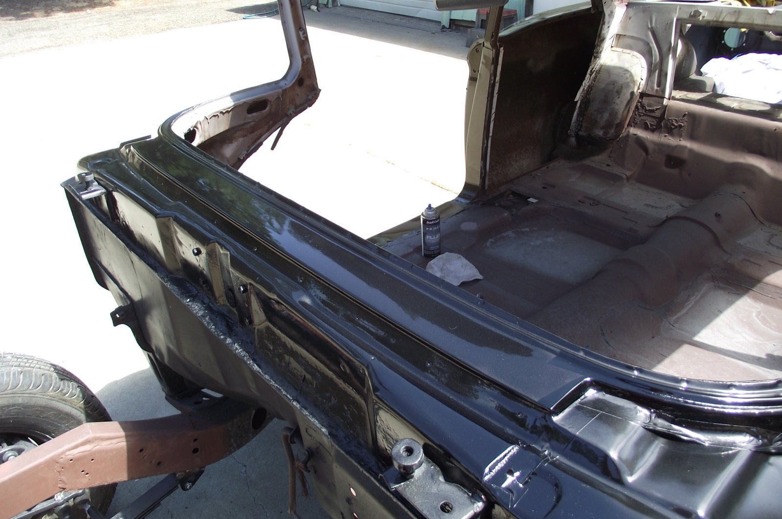

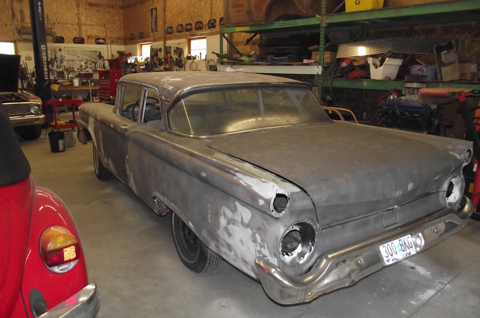

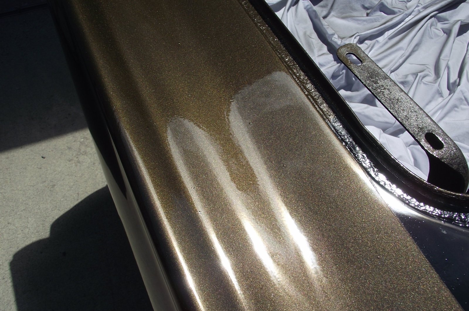

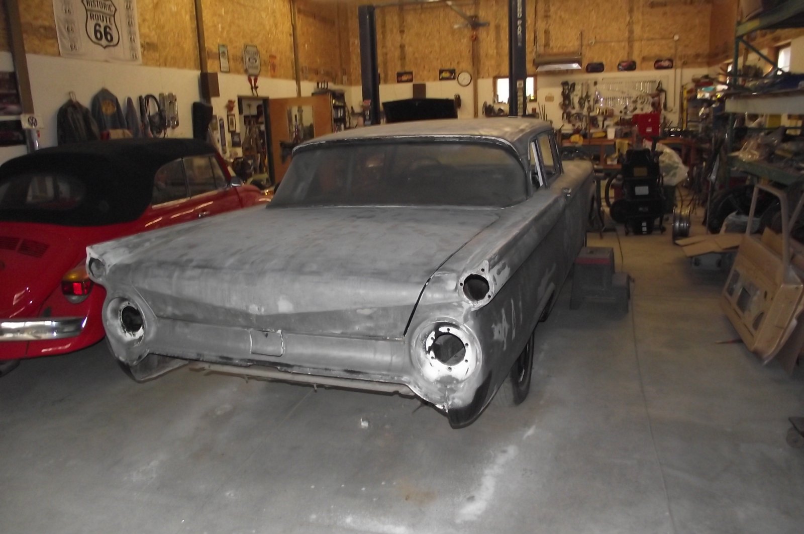

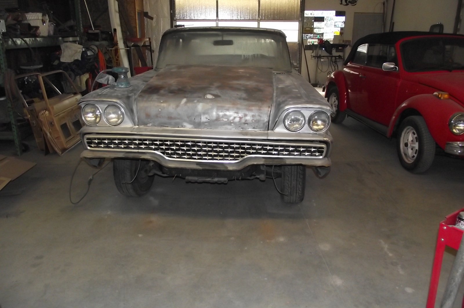

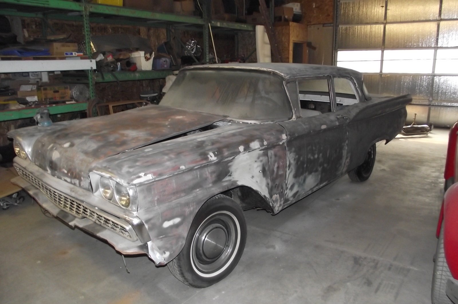

    I bought one of the high end wet blasters that was demonstrated on you tube (Power Eagle)and used it with a 4200 PSI pressure washer on the 59 with green diamond media, It worked great , the clean up was a little tedious but the whole car was going to be blown apart for paint anyways. A shop vac and an air hose got it clean and then I went over the whole car with 60 grit until there was only shiny metal. Had to strip all the chrome and stainless off it, the gl*** was no good so it got blasted too.

  15. Mike Miller
    Joined: Oct 13, 2008
    Posts: 4,561
    Mike Miller
    more pics
    DSCF5447.JPG DSCF5449.JPG DSCF5450.JPG DSCF5451.JPG DSCF5454.JPG DSCF5455.JPG DSCF5456.JPG

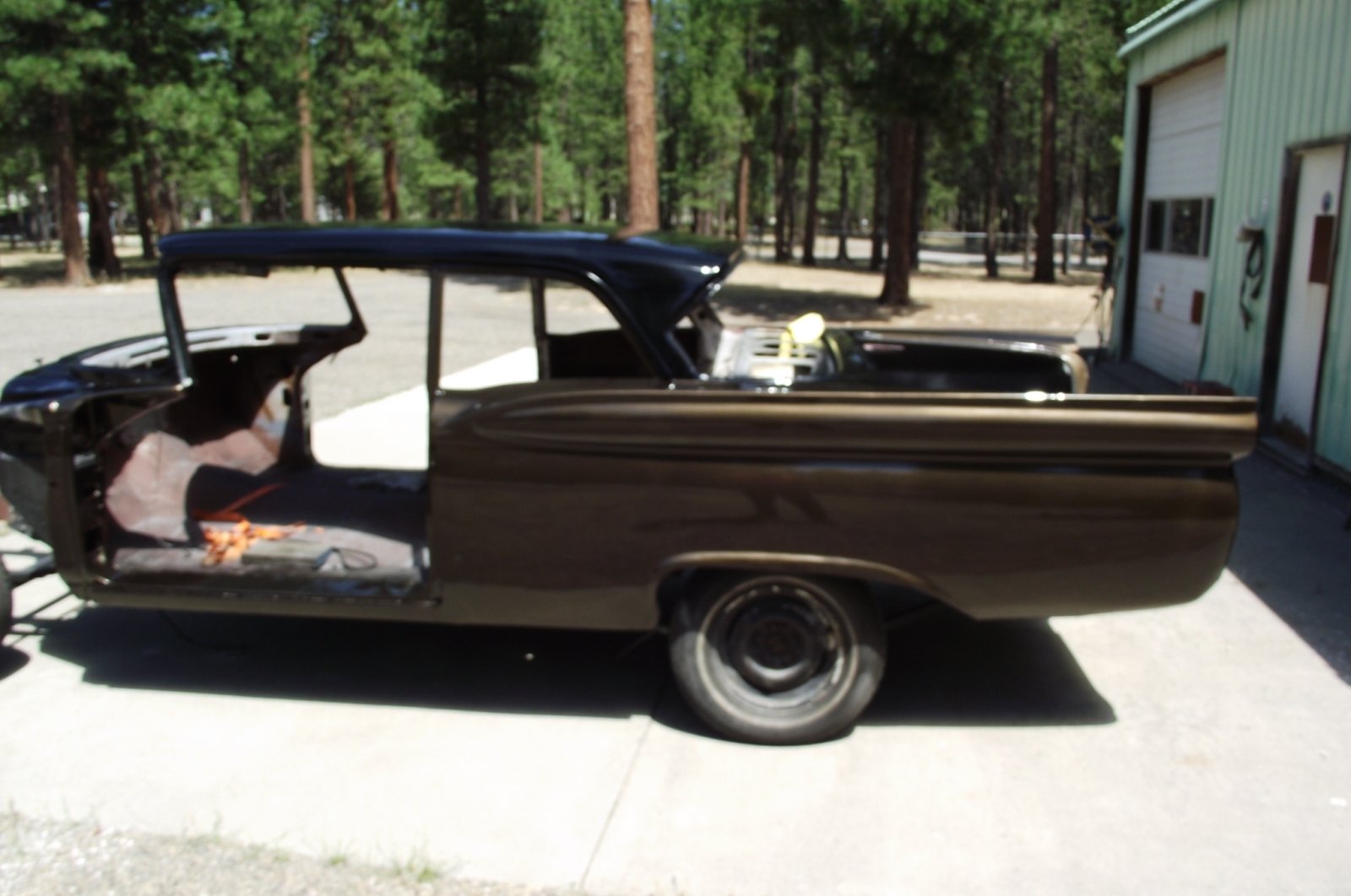

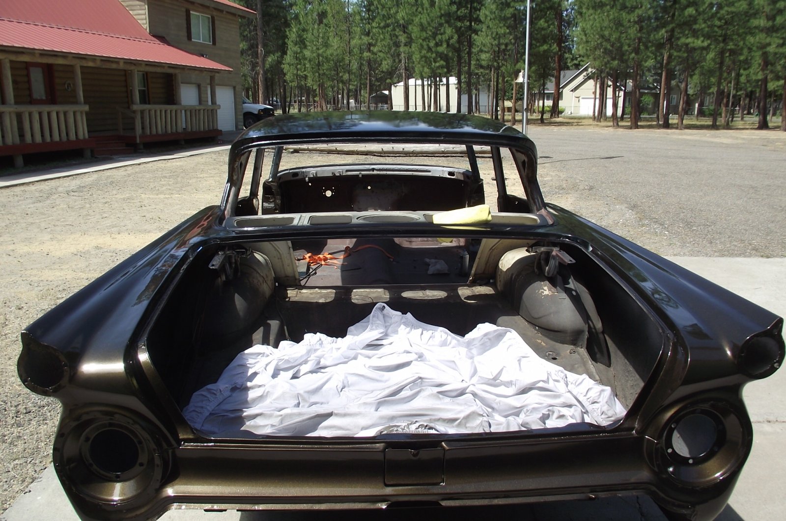

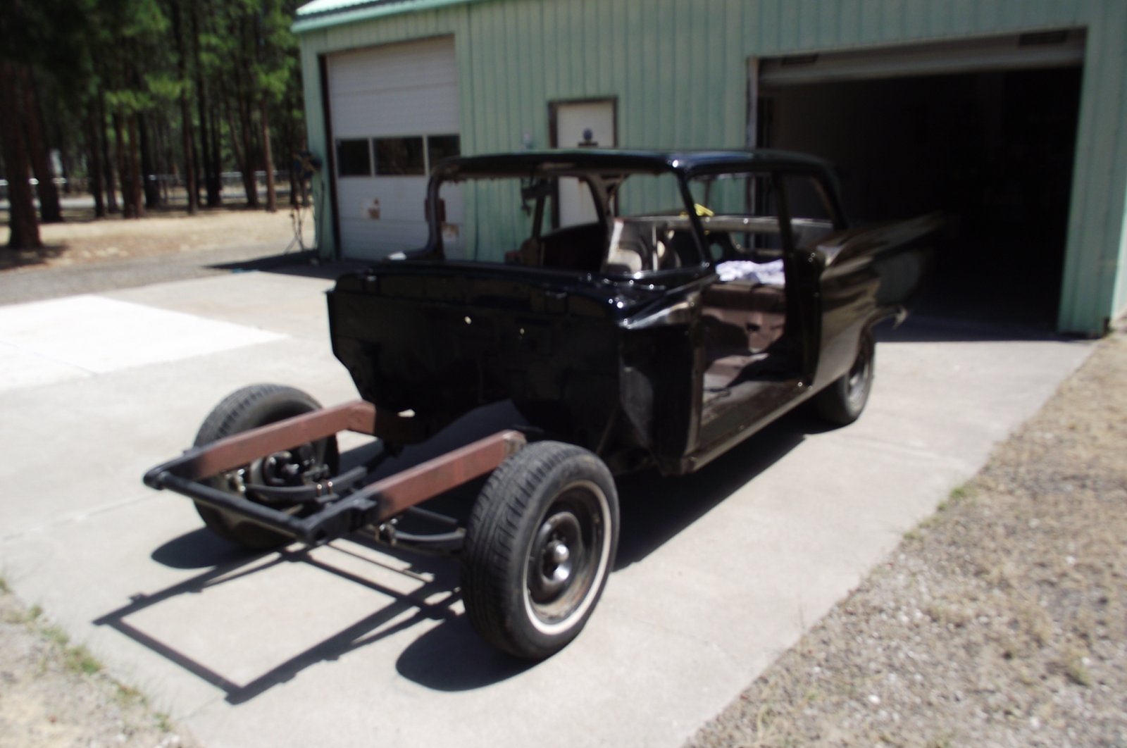

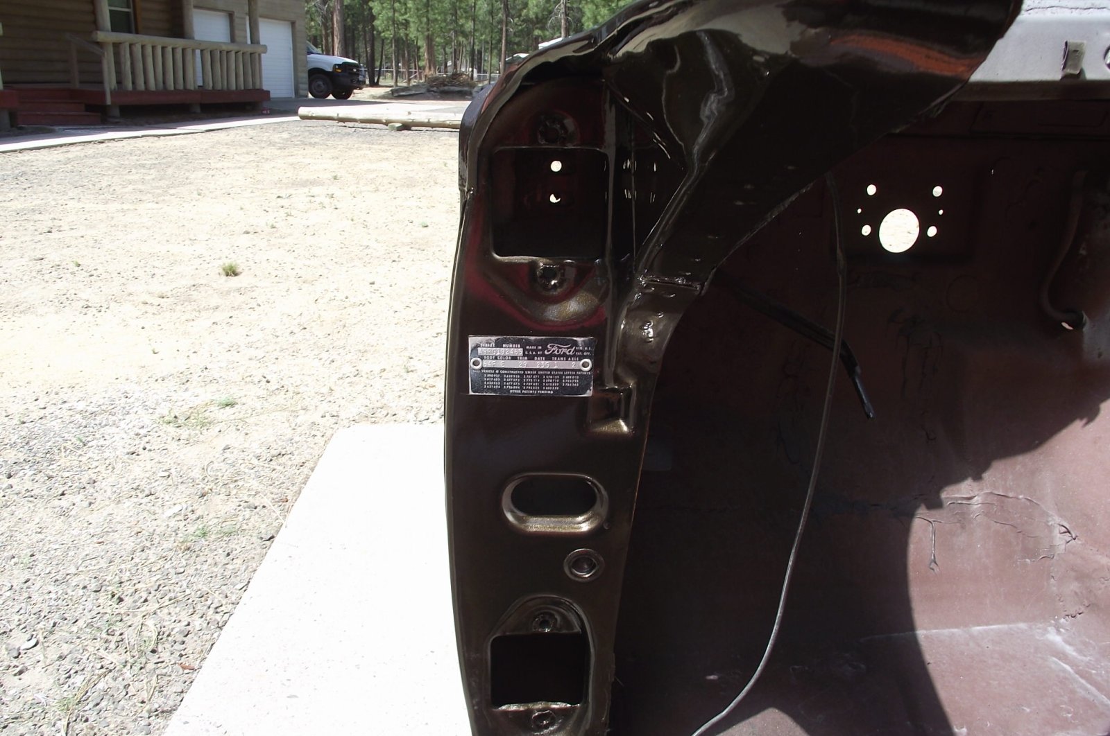

    And painted.
