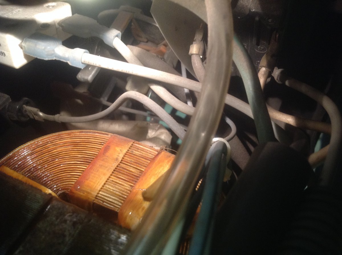

  18. I opened it up and started at the beginning,
    There wasn't much dust inside, a little but not much.
    The voltage dial is ABCDE and when welding on the E setting is when the machine causes the most racket. I'm not sure this is the only proble but the E post is showing the most wear.
    The heavy cable (top center) attaches directly to the E Post and you can see the itty bitty silver or tungsten contact on selector in position D.
    Second pic shows the worn/dirty/burnt spot on the E post.
    Now to figure out how to get it out and clean it.

  26. That's a good point - "dirty power" input.
    I have been welding with it plugged into a new out let and new branch line.
    It's single phase 220 but ran off a 3 phase panel. Could be not balanced on the phases.
    I've tested it after cleaning the voltage selectors and it's much better.
    The wire feed got total service too. The pressure tension arm is in need of replacement, but a small clamp is serving duty now. I also spotted the plastic wire roll's thickness was a bit smaller than the other rolls, a bit over 1/8". That would let it catch on the back pressure tension but not positive enough that it wouldn't bounce there every once in a while. So made a washer with holes away to take up the slop. While I was messing around I busted the ipm wire feed control so I put in a new potentiometer too.
