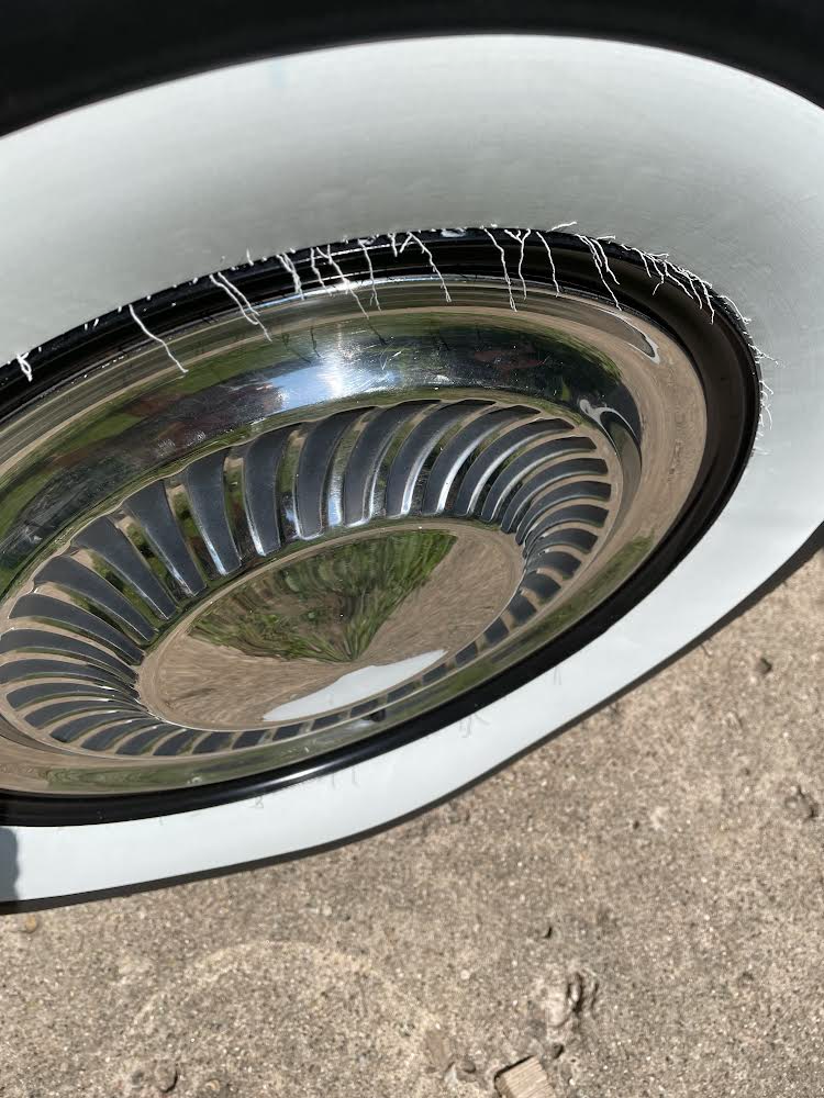

    Hey all,
    I have a second set of Coker American Cl***ic biasply looking radials on my TBird. The first set did the same, the second is also doing “stringing” (not sure if that’s the right term).
    Has anyone seen similar ? It’s on all 4 tires. My wheels were sandblasted and powder coated before the installation. The second set was installed in different shop than the first one.

  2. 19Fordy
    Joined: May 17, 2003
    Posts: 8,372
    19Fordy
    Could that be caused by the tire mounting machine as it rubs against the tire during mounting?
    Were those "strings" present before you mounted the tires on the rims?

  3. OZCAST
    Joined: Oct 12, 2020
    Posts: 277
    OZCAST
    Could be bad QC at the factory. I got 5 tires from them, evry one was too oval to balance. I had to take the best two and get them trued for the front to drive above 35. I'd email them pics and see what they say

  4. Are the "strings" dry and unattached or are they gummy/sticky like something dripped?
    My wild*** guess is it's uncured, white rubber oozing out....... but I know less than nothing about tire-making processes so I can't really say what is possible.
    I've got to say it is a tire defect and a nuisance so I would definitely contact the manufacturer to see what they have to say about it.

  5. '29 Gizmo
    Joined: Nov 6, 2022
    Posts: 1,189
    '29 Gizmo
    from UK
    It looks the fabric reenforcement in the whitewall. Without it the whitewall surface will streach and crack. It looks like the white rubber has not completly filled the mould so the strands have come exposed. Carefully trim them back to the sidewall. You may be able to reseal the surface with a tiny amount of superglue at the very edge.
    However.. if its a sign the whitewall panel is starting to delaminate from the tire, thats a bigger problem

  8. BigBlockHead
    Joined: Apr 4, 2009
    Posts: 9
    BigBlockHead
    Thanks for all the comments - here are some responses to the questions
    - strings are dry and were not present before they were mounted, or right after. I need to drive a bit before the stringing started.
    i have used two different tire shops, so I don’t think it’s the machine either
    I’m wondering if the tire is moving against the rim ?
    I’ve been talking with Coker and they have been good about it. I got a replacement set, but they are doing the same thing.

  10. 27 MoPar T
    Joined: Mar 7, 2023
    Posts: 45
    27 MoPar T
    Are you running the tires at the recommended inflation? Also are you running tubes? From the appearance of the "Strings" it looks like the rim is slipping in the tire and causing the rubber to roll up and stick out the side.

    Could both tire shops be using the same machine to mount the tires?, My initial thought is it appears that the machine may have come in contact with he edge of the whitewall. HRP
  12. Moriarity
    Joined: Apr 11, 2001
    Posts: 37,737
    Moriarity
    SUPER MODERATOR
    put a mark on the wheel and another on the tire and take it for a ride and see if the tire is slipping and turning on the rim? sounds far fetched but who knows. can you break the strings off with your fingers? what does it seem like? rubber? if you cut em off, do they grow back? how long does it take?

    Looks like low air pressure to me.

    Razor blade/xacto knife time….trim it off and move on..

    I know nothing about whitewalls, but it seems to me that the white maybe is put on and bonded to the tire after it’s made? If not, what’s pictured is parts of the sidewall coming out.
    If it’s bonded on, I wander if some kind of clear adhesive would stop it?
    If it’s part of the sidewall, I’d be leery about using them for anything other that rollers.

  25. K13
    Joined: May 29, 2006
    Posts: 9,733
    K13
    No one has ever seen this happen yet the OP has had two full sets of tires do this? To me that says he or the installers are doing something to damage the tires.

    Having mounted & dismounted tires I've noticed on rare occasion the sealing rim edge showing evidence of wear, in the form of a wavering pattern of the metal testimony that the tire or at least the bead or sidewall was flexing & moving enough to actually create the wear, probably normal but of an extreme nature. perhaps more so with a radial versus a bias ply I'm not sure, always thought it was a result of running low air pressure or an overload condition or even more so an out of balance, tie rod shimmy etc.
  28. It sure look to me like these “hairs” are between the tire bead and the wheel, which means they were sticking out of the tire before they were mounted.
    So ether the customer, the tire shop, or both knew their was an issue and mounted them anyway or as @K13 says the tires are being damaged in the mounting process.
  29. Looking closely at the one example photo that we have, I think I see that the "whitewall" ends a fraction of an inch before the wheel rim. So where the white abuts the black is exposed and a 1/4" out from the rim. And all the "strings" are coming from that white to black joint, not from under the rim or any other place. Normally both rubber types should be fully vulcanized and fused solidly together.
    And all the "strings" appear to be the same thickness, like actual strings, but no one has told us if they are rubber only, or rubber-coated string. I'd like to know if one of those boogers is pulled apart, is there an actual fiber string in it or does it stretch or come apart like an old rubber band?
    If they were in my driveway, I'd pull 'em or cut 'em off as best I can and see what else happens or doesn't happen after driving some more.
    As I said earlier, I don't know diddly about tire production, but I'm beginning to ***ume that the whitewall is first made separately with its own warp and welf fiber reinforcement, then is sort of inlayed into the black tire. Perhaps that fiber/string reinforcement is out of position and too close to the edge of the finished white hoop and once fused onto the black tire there is a gap for the "strings" to come out and flap around.
    jimmy six likes this.
