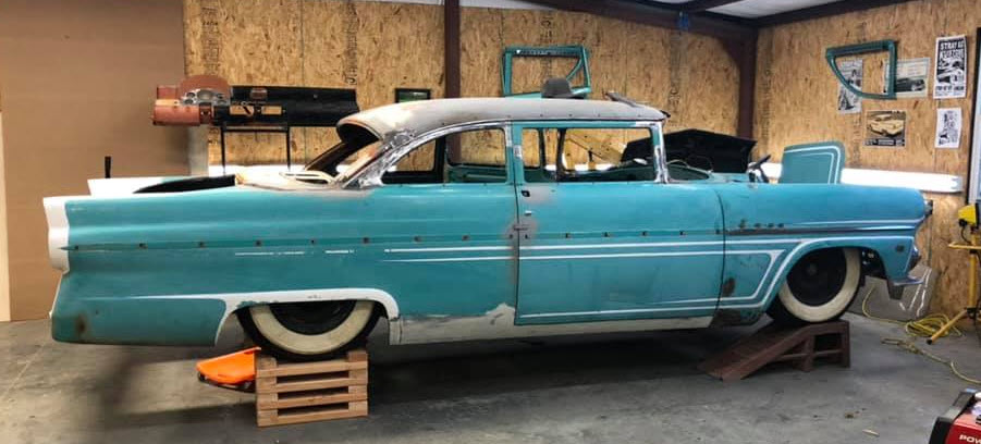

  7. Malcolm
    Joined: Feb 9, 2006
    Posts: 8,160
    Malcolm
    from Nebraska
    Chris, you might try contacting @travisfromkansas
    He has/had a car that had this done to it. >>>>
