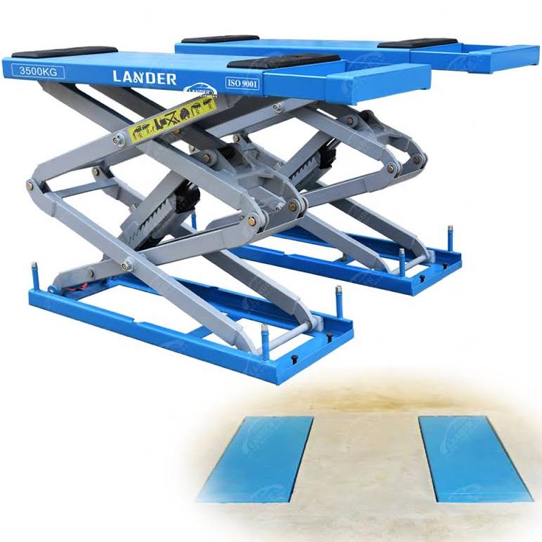

    I’ve been looking recently at those low profile portable hoist that raise the car 4-5 feet .
    but with my one car garage and my drive way on a slope not sure if I can do it safely .

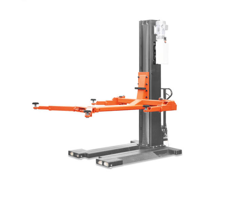

  2. Like these guys pretty cheap new and come up for sale used also .

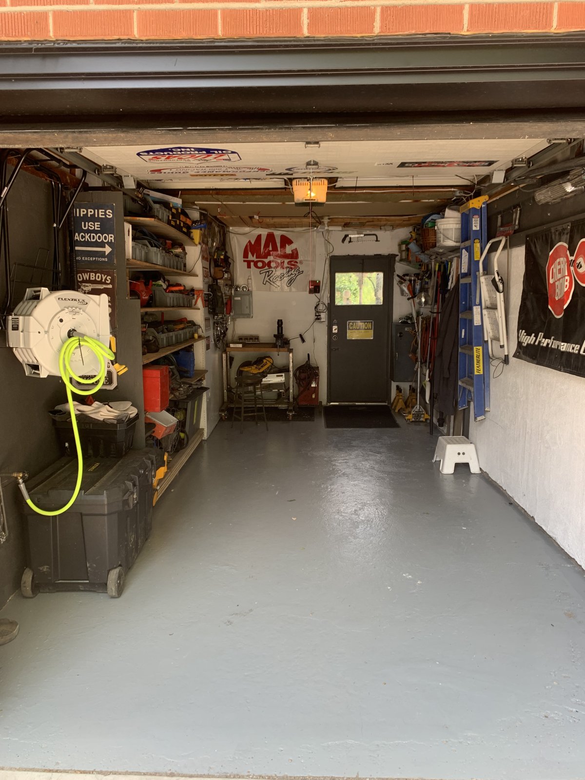

    As you can see this is my expansive empire

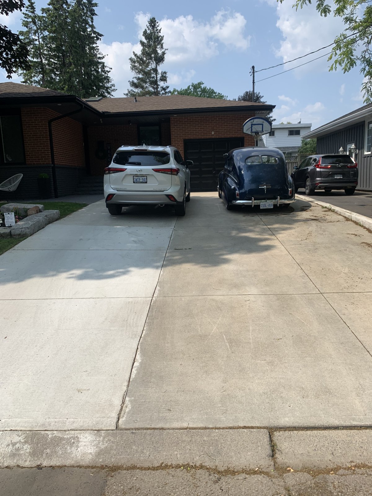

    and here’s my drive way , I think kinda shady using a hoist on it .

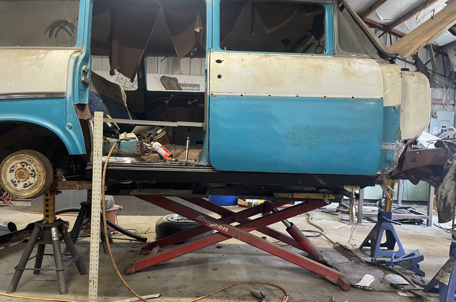

  9. I got this repo snapon lift over 20 years ago. Best $1100 I ever spent.
    Can lift the car 42”.
    A company called Wheel Tronic makes em.
    Perfect body work height.
    The large truck stands are holding the car on its suspension while I fit and weld.

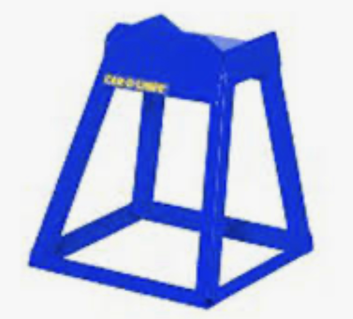

  11. I want to built a set of these wheel stands

  14. That’s what I’m looking for , would you use that on my drive way ?
    or would I have to block or shim the back end of it so the hoist sits level ?
    And the stands your looking for are forklift stands , look for ‘em a lot of the dealerships and union shops once the engineering tag falls off they deem them “ unsafe “ and you can buy them for not too much .
  15. I would trust this lift on a driveway.
    I guess as long as you know the thickness of concrete.
    I would shim it for level definitely.
    I guess if the driveway thickness was in question, a 3x7x1/4 piece of plate would help distribute the weight.

  17. Driveway is 8” of fibregl*** reinforced concrete with rebar .
    I’m Italian i know my “Cemento “
    I’m gonna run a string and a level across my driveway and see how much it sloped and if I can make it work by shimming up the back end of the hoist I would be golden !!!

  18. The side to side level would be more important than a slight slope front to back
