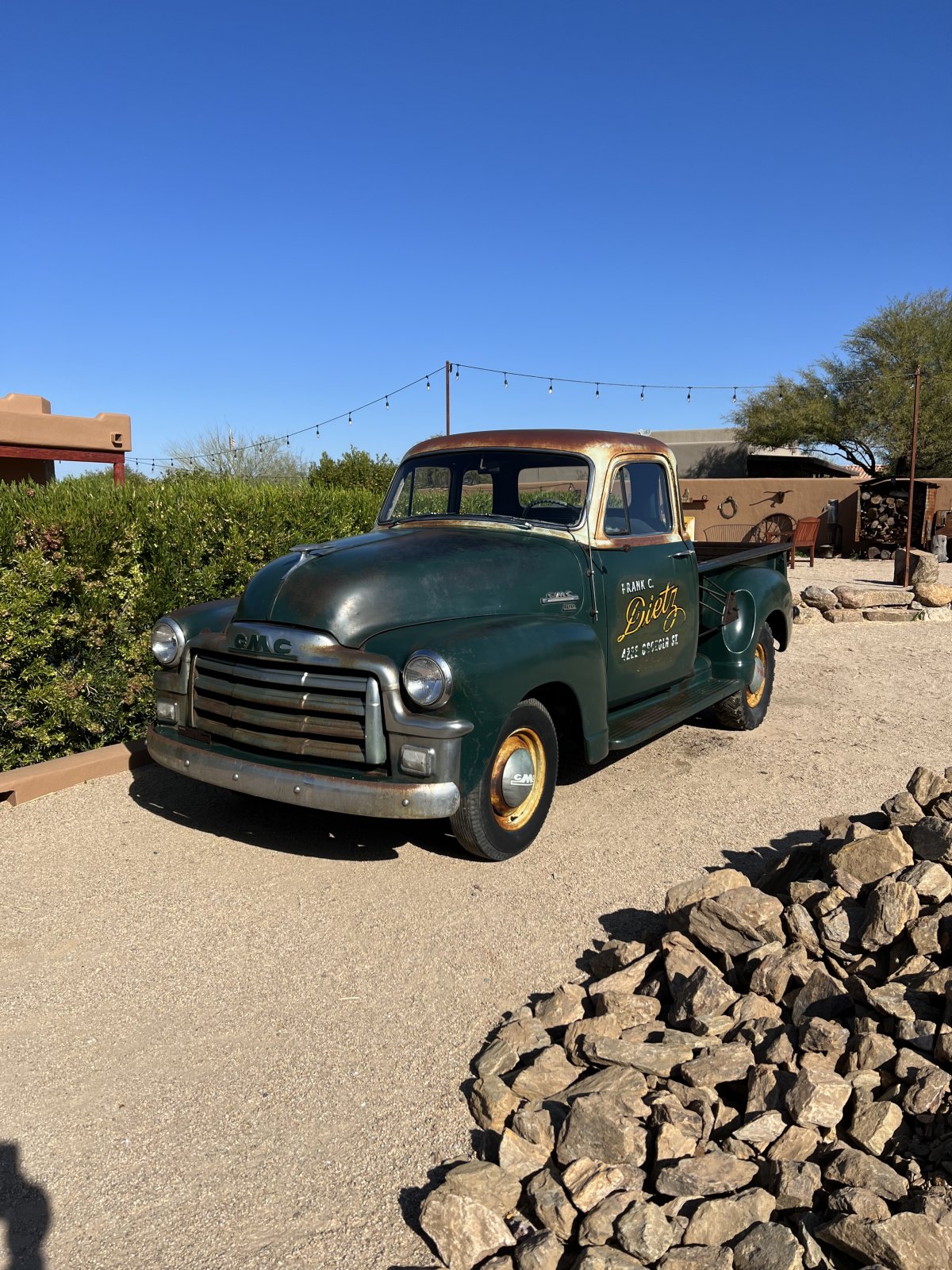

    Hello it’s been a while since I’ve been on here. I’m getting ready to build a 54 GMC with 10k original miles. A true barn find. I want to get rid of the 6 cylinder and drop a SBC however we want something really cool and period correct for that time to top it. Maybe a Tri power, stack etc. What’s a reliable set up that can maintain the cool factor?

    It might be a little lame, but a 10k mile survivor, a "true barn find" I'd leave the 6 in it. How about a peek under the hood?
