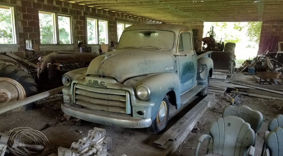

    From a finacial point of veiw, DON'I MESS WITH IT.
    As a rare original "10K mile survivor", it's probably in the $20K value range in today's crazy market. Once you start major changes (engine, trans rear, brakes etc) it is no longer a survivor, but becomes just another nice old truck with a cool story...they're only a survivor once.
    So as @panhead_pete points out, you could spend as much as $10K on all the modifications...and after you've spent that $10K on it, you'll end up with a nice old upgraded (non-survivor) $20K truck.

    If it is indeed an unmolested survivor, I'd have a hard time changing it. Fix what needs fixing and drive it. If you still feel the need for speed and more hp, find another and build it like you want, they made thousands of them so it shouldn't be too hard to find another to build. Nothing wrong with leaving one like it came from the factory.

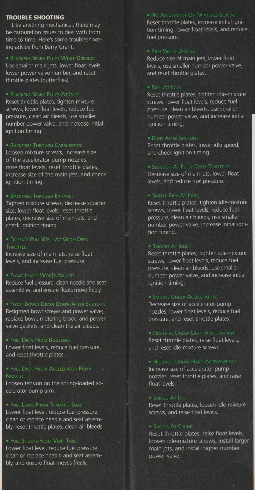

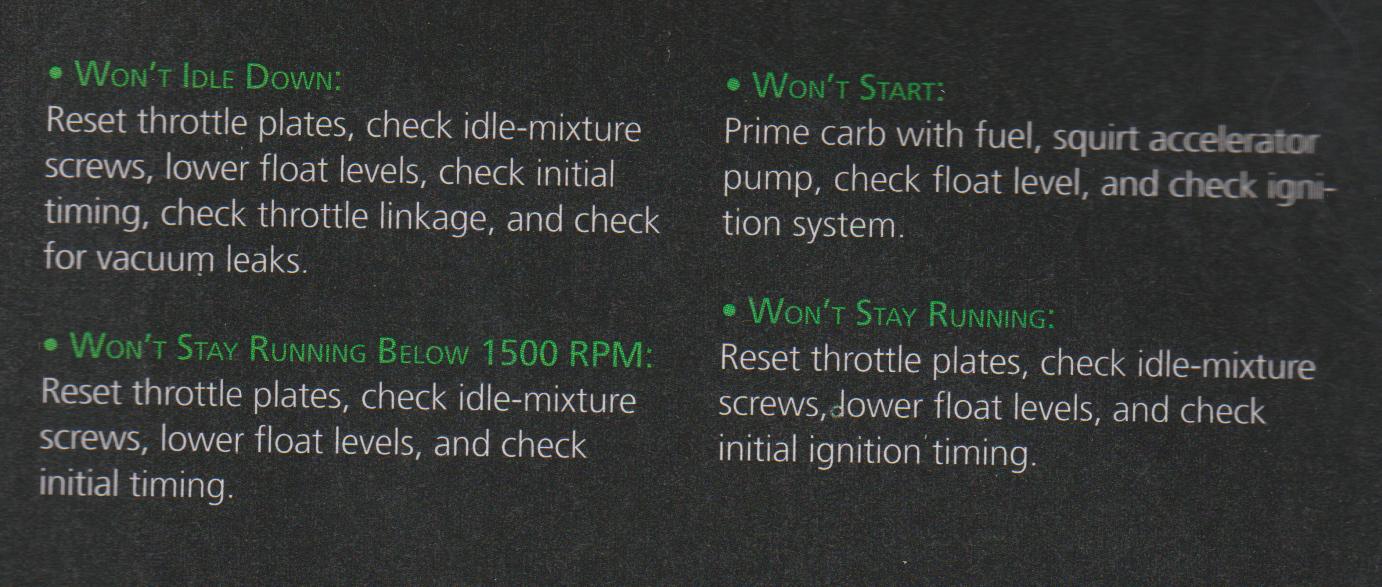

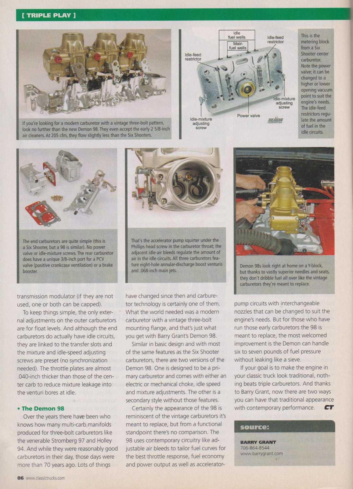

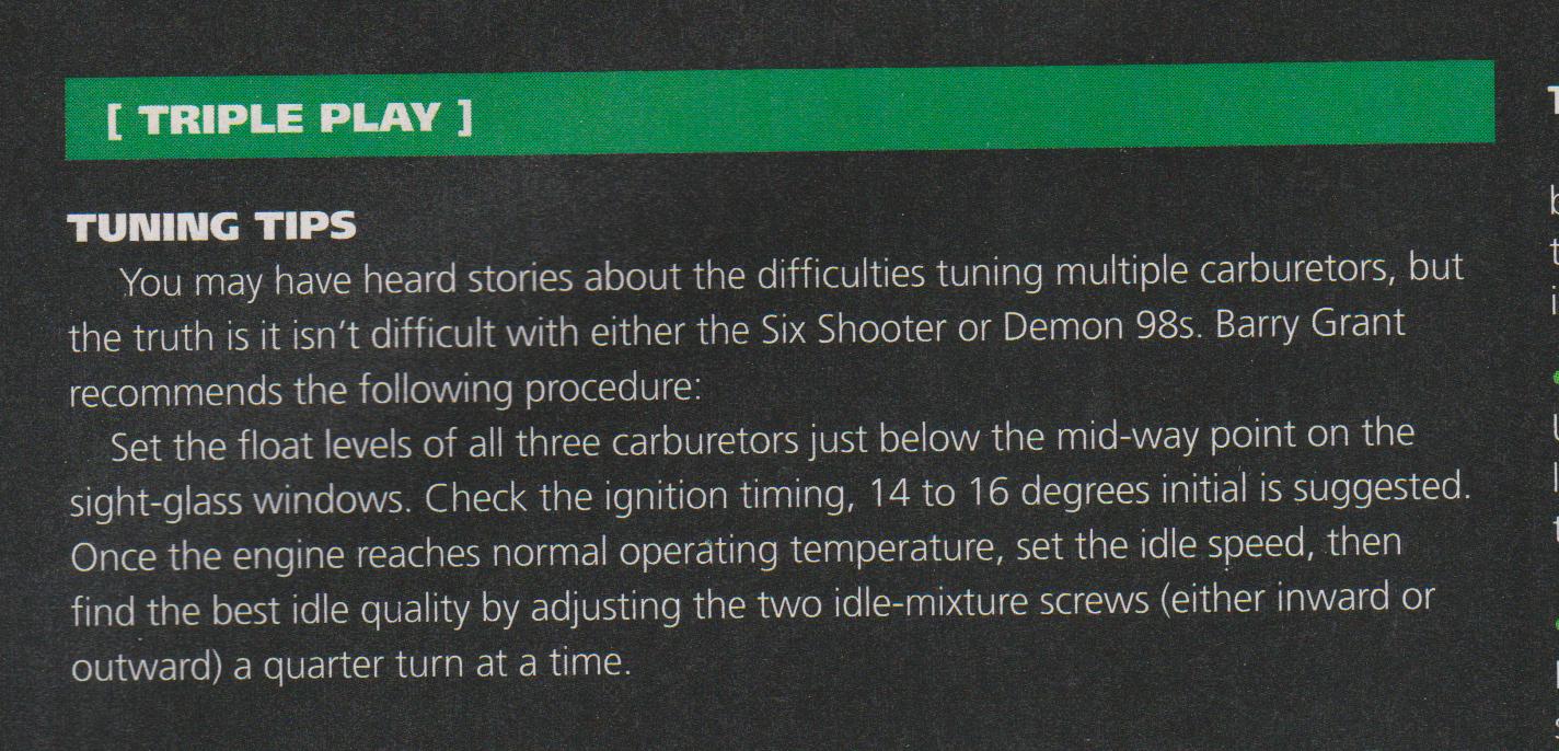

    Here is some information that may prove helpful in purchasing/tuning a tri-power set-up.
    Ok, that should help a little. Looks like you have a great project to build............Good Luck :)

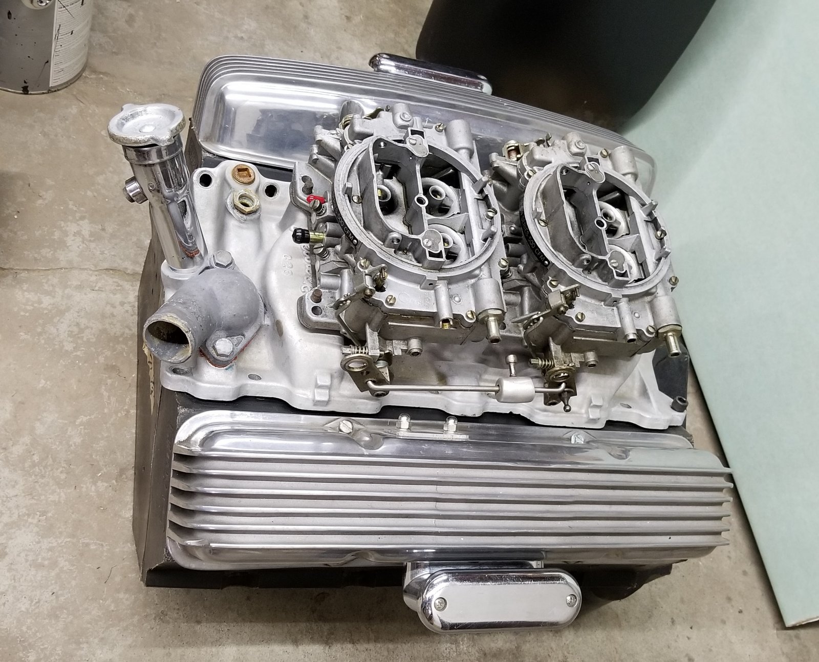

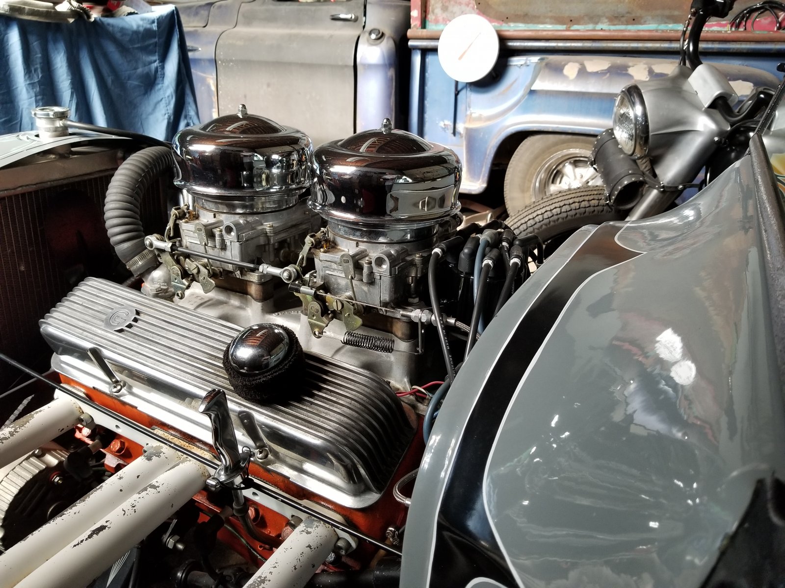

    Couple of intakes I have as backups
    And one in use, very reliable and trouble free the past 15 years
    YEZZI and Desoto291Hemi like this.

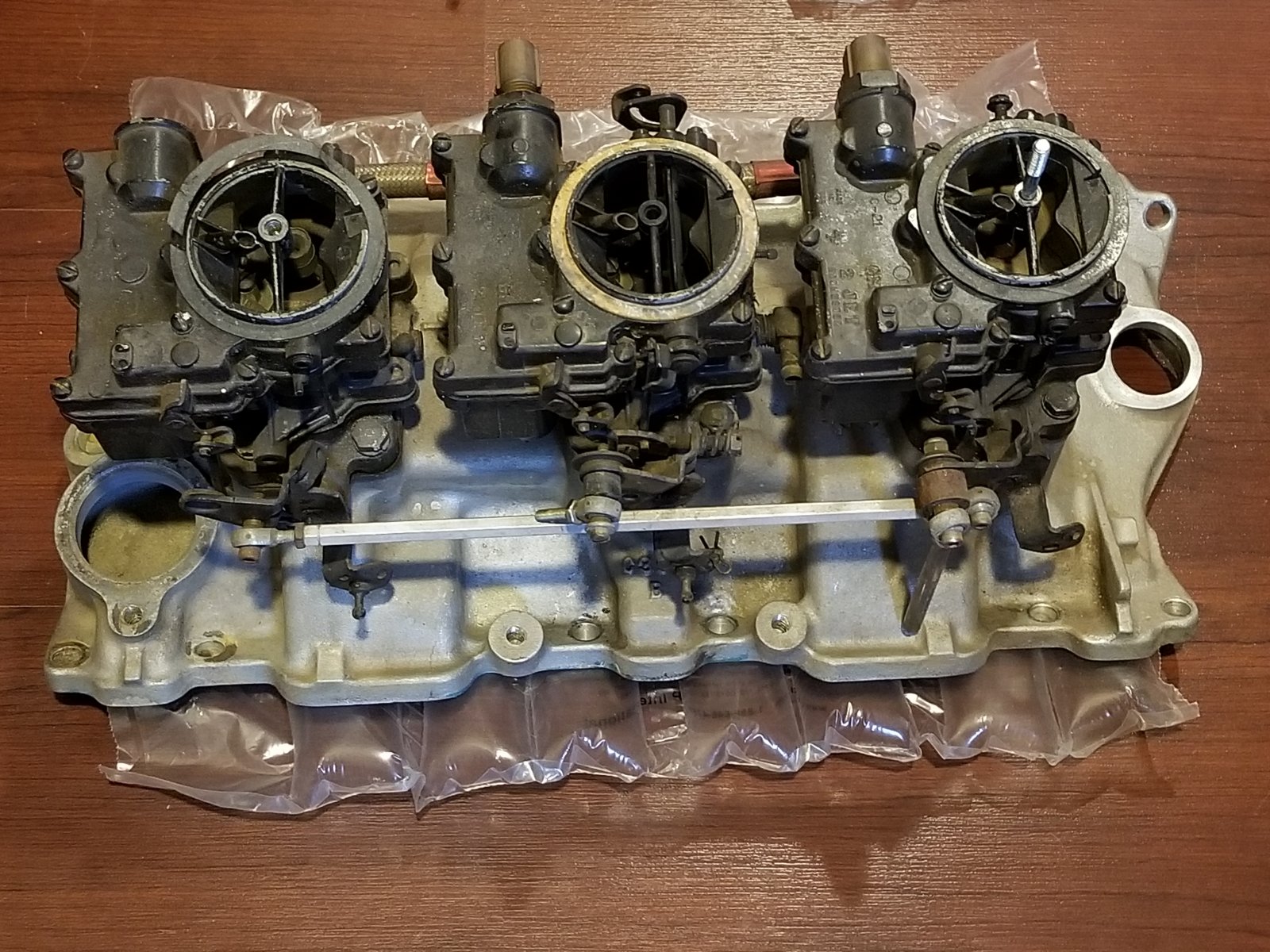

  19. I forgot, I have a similar dual quad setup I need to get into the cl***ifieds! The cabs turned out to be something special so it would be best for me to just get rid of the intake alone.
    What intake is the tripower one?

    That truck is what everyone and their dog is looking for....the holy grail. Ultra low mileage original.....with real patina and old door graphics. Some rich old Ralph Lauren type fart, with a ranch outside of Aspen or Telluride, would be on that truck like a duck on a June bug.;) As already stated but bears repeating, whatever you end up doing, I would keep and store every nut, bolt and part taken off of it. Great truck, good luck with it.

  25. carbking
    Joined: Dec 20, 2008
    Posts: 3,959
    carbking
    T-man - this one is drilled for Stromberg EE-1's or Holley AA-1's.
    Jon.
  26. Yeah, I just grabbed the first random image. It doesn't even look like the SBC one that I actually had. But you get the point. Lets just call it a "stock photo" ;)
    Although, now that I think of it, Offy uses the same casting for both, they just drill whichever bolt pattern they need. TONS of hand machining on their stuff. Great vids on IG
