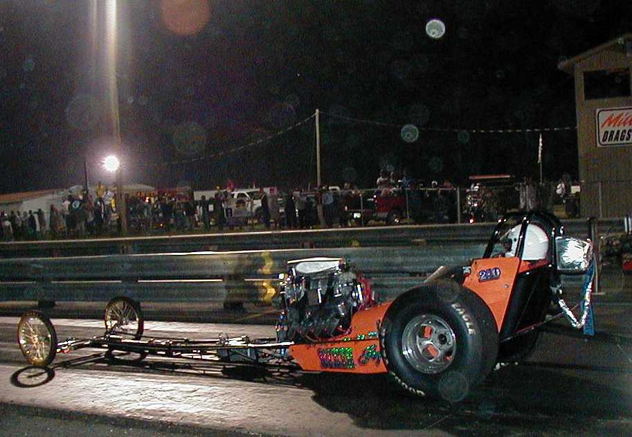

  16. Here's a M/T 28 x 10.5 on that 8.5 rim I mentioned earlier, not a bad bulge on the sidewall.
