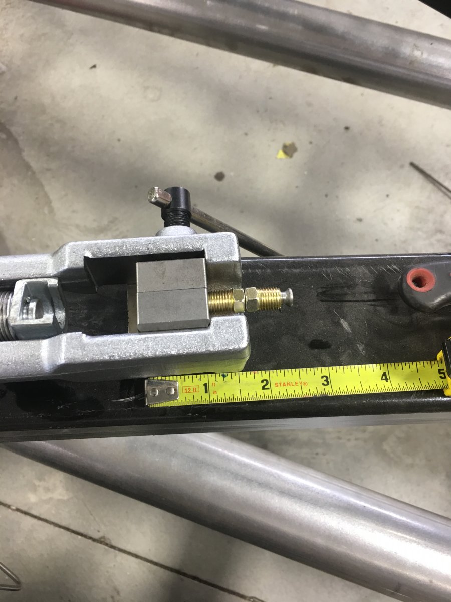

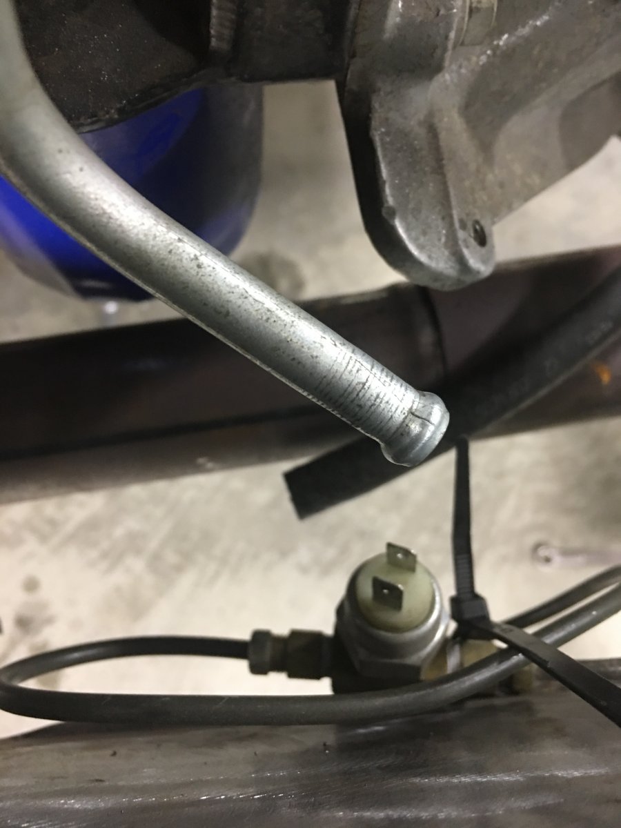

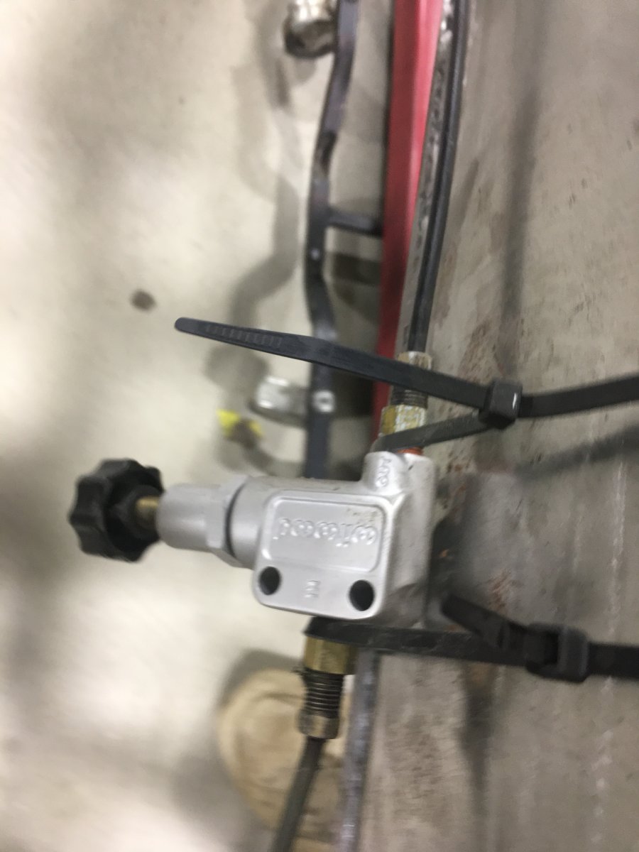

  1. I’ve not seen it,,,
    but SOB there’s a bunch of inverted flair to NPT, then NPT to inverted flair on this one we’re redoing. Sure would be less fittings, less flairs and a way cleaner install.
    Just a few short ******s here and viola!
    1887B8E0-AE2E-4DE8-A7C9-7E3F0180934E.jpeg DAE25B7E-0832-4C0D-8B3C-8B8B8131A7B9.jpeg BED81CBA-0123-4F65-AF98-0351FD1BAB80.jpeg
    We’re redoing this ****

  14. ..??o_O...??
    With a ****** you could stack the RPV and bias adjuster right?
    That saves two joints and save a few inches of space right?
    With a ****** you could stack the pressure Switch Tee and the RPV as well
    That's another two potential leaks and another Three inches.
    That all sounds like it could be really good thing.

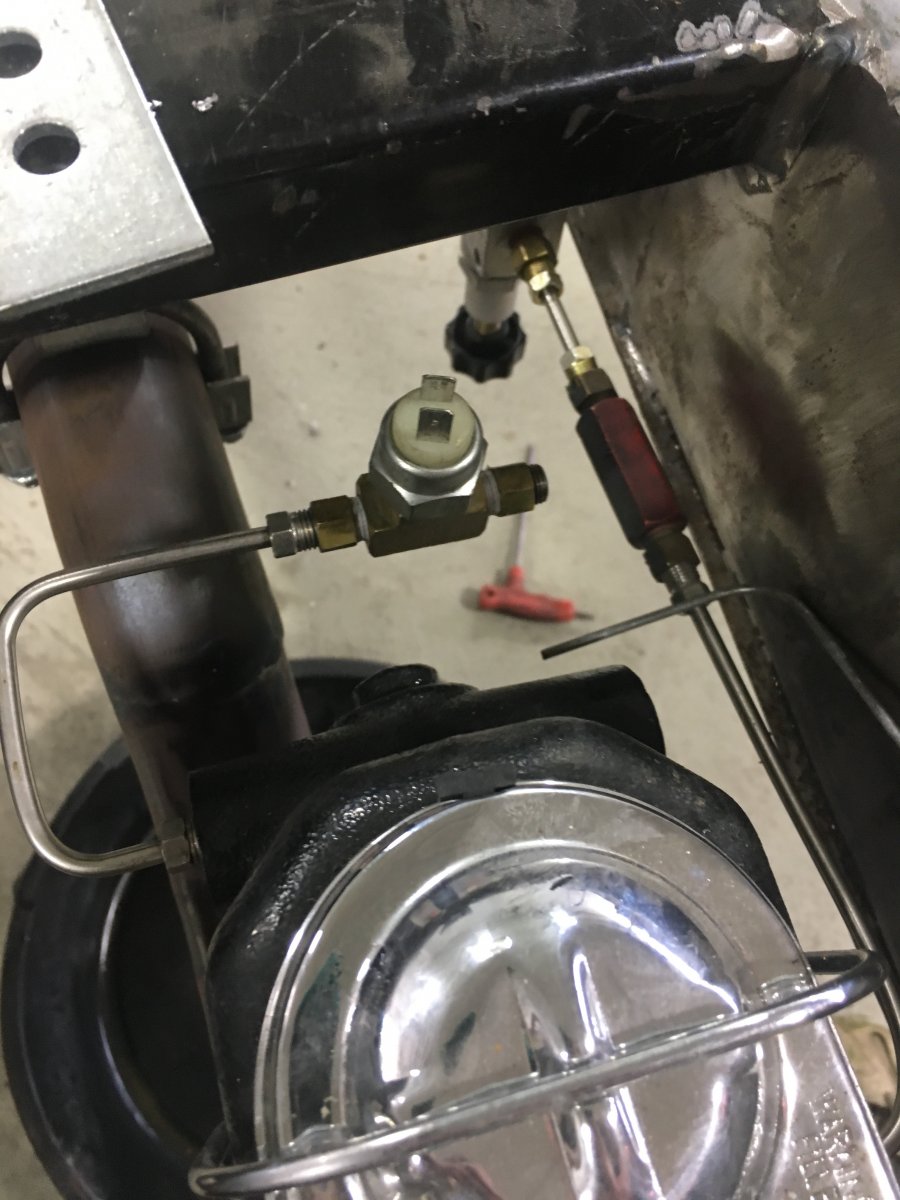

    In that same area, It grinds me to see numerous fittings on the master cylinder to attach 3/16" or 1/4" lines. Get the fittings the factory uses, please. All it takes is a little time to find them. Jegs and Summit both carry them.
  16. 79BB8A42-5CD2-406D-9A6F-857EFD9121EF.jpeg 6 Adapters from NPT to inverted flair in the area that’s the size of your fist.
    ******s ,,, we need ******s.

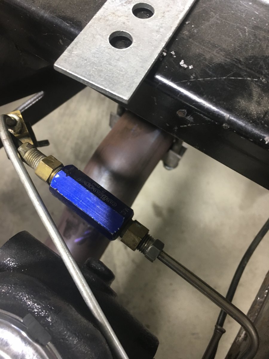

    Posts: 296
    Rich S.
    The line from the proportioning valve with the red union and adapters. If that goes back to the MC, maybe replace the whole line and get rid of the red union and adapters.
  28. Are you being funny?
    That union is kind of important
    The red one is the 10 psi residual valve.
    The blue “union” is the 2psi residual valve
  30. Rich S.
    Joined: Jul 22, 2016
    Posts: 296
    Rich S.
    Nope, I didn’t realize that. I was looking to simplify and get rid of the adapters and have less joints. Thanks for telling me that.
