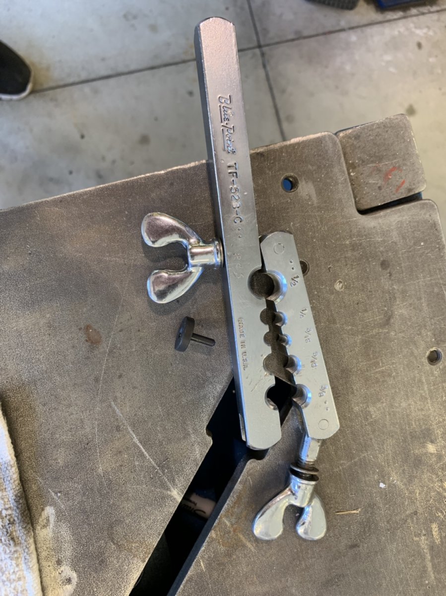

    I have the Mastercool flare tool also. Sometimes I have to go to one of these for short ones. Difficult to get a good grip on stainless . IMG_2444.JPG

    No one, so far, has mentioned stainless brake tubing.....only the stainless ******s. I do not see what the flaring tool has to do with that.
    This thread is getting weirder by the post. What was #31 (stainless ****** pictured) is now #29.....:confused:
