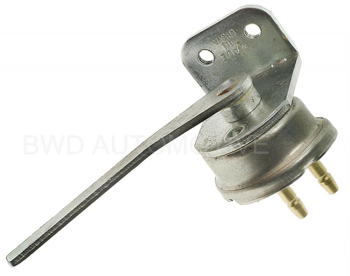

    And I use mechanical brake light switches operated by the pedal. Why do we continue to use hydraulic switches?

    My fave brake light switch. American made, all metal, operated by pedal. 50s chev truck brake light switch.jpg

    who sells it?
