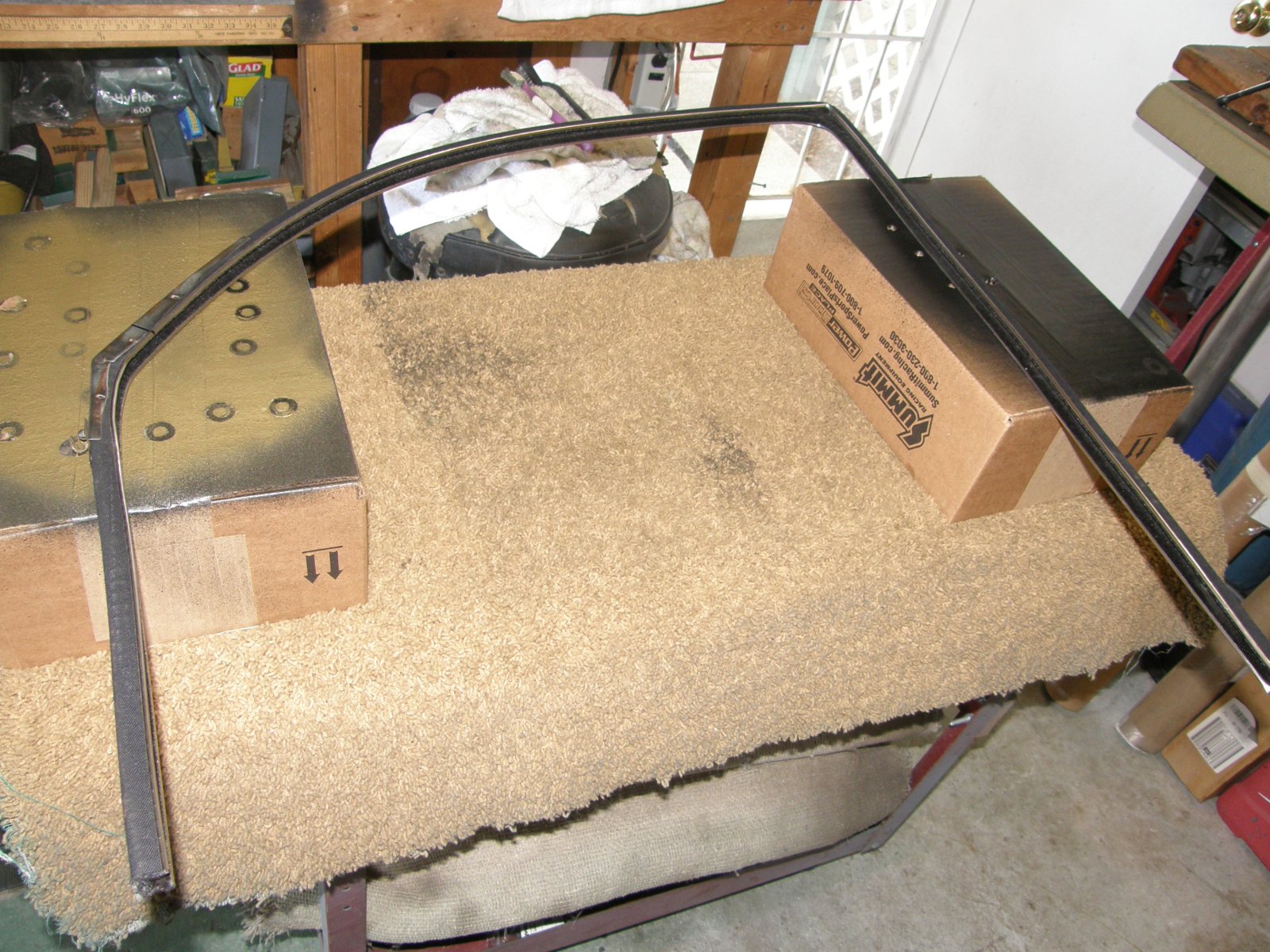

    On my '54 I bought 6' sticks and bent them to fit. I also bought the mounting clips but they just have little prongs that stick into the material. I'd like to glue these in. I tried 3M Black Super Weatherstrip Adhesive on one and it didn't work so well. What do you guys use?
    Here's the backside.......
