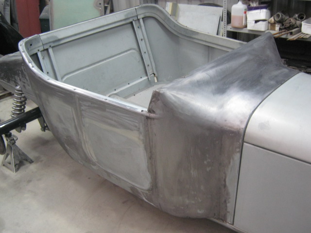

    I said before that I had seen Ron Covelle was building one of these bodies. He had made a really elaborate buck which is completely over the top for a body like this. If you build the sub-structure like the one I built for my T (below) which is a copy of the original you have most of the information needed to make the outer skin...
    If you need more info about the shape of the skin you can simply add a couple of stations (wooden profiles) to the substructure to give you a guide to the shape in particular areas.
    The amount of work in building the buck he built would be at least equal to the work involved in building a body in steel and if you have the original body in front of you you simply don't need an elborate buck.
    I built a simple buck for the turtledeck of this body but only because I knew I would not have an original body to work from. If you have original panels to work from you do not need a buck for a simple body like this which is made from lots of small panels. I dont actually have an original body to copy and am workiing from info gathered from various sources and from photos for the most part.
    Unfortunatly sometimes things are shown to make things more difficult than they are.
    I have had teachers that make things look as difficult as possible to show how clever they are rather than actually teaching sound methods.
    David

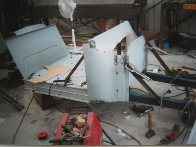

    I agree that bucks aren't always necessary when building a body. I used a Fibregl*** T-bucket body for some patterns when building my T body..once I had the floors done i then made a steel 'jig' to position the top of the cowl and the rear 'cab wall' and then its just a matter of keeping panels symmetrical ...and I was able to make a few changes as I went...ie lengthened front bulkhead.

    When I built the body for the car below I worked from a f/gl*** body which was longer and wider than an original. I started with the outer panels just taking a guide from the 'gl*** body and made everything symetrical. I put the floor in last, it has two opening doors. I just made the panels and bolted them together like an original.
    Money is always a problem, the UK is no better. I have lots of work but am under pressure from some of my customers regarding cost. I am building my car on a tight budget but I am determined to get it done. I laid out most of the money up front when buying the donor car.
    For simple bodies like these you just don't need a buck.
