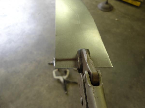

    I am doing a cowl top and am wondering how you did the 'rebate' where the cowl joins the firewall. I am thinking of making the hood offset seperate and welding it to the cowl, after shaping, as a seperate strip.
    How are you going to do yours?
    Thanks, oj
  2. austinhunt
    Joined: Nov 26, 2011
    Posts: 533
    austinhunt
    Here is the quote explaining the "rebate" for the hood.

    I think I'll stand in line for also ordering the second DVD. Can you show a little more detail on how you formed the swage around the perimter of the inner door skin. I have been trying to do the same on a pair of 2 longer than standard 28 A Ford doors.
    Thanks
    Michael
  10. austinhunt
    Posts: 533
    austinhunt
  11. Mindover
    Joined: Jan 18, 2009
    Posts: 1,661
    Mindover
    from England
    Michael, I did the swage on a pullmax with some simple tooling but it would be possible to do it using hand tools. It depends on if you have put the curve into the door frames how you should go about it. Let me know and I will explain what I think would work.

    I tried to do these with a bead roller and form the additional flanges as separate pieces to be welded in along the edge later, so had used the shrinker - stretcher to try and put the curvature in the inner frames before the extra pieces were welded along the edges. My lower corners were added in a similar fashion to yours also. I have cut a new pair of blanks to try again, but would like to try and make some tooling to use in my vibroshear machine.
    Michael
  20. Mindover
    Posts: 1,661
    Mindover
    from England
    Michael I will take some photos of what I made for the job and post them for you. I made tooling for the Pullmax because I may well make more of these bodies.

    Micheal, I am very sorry, it is quite a while since I looked at this thread I did not realise you were waiting for photos. Here is a photo I just took of the tooling I made. Quite crude but it worked. I will probably improve it if I make more of these bodies. The bottom tool was an existing tool made for another job (it has a mirror image top tool) The top tool has the 'nodule' which fits into the small swage (bead)
    I hope this helps!
