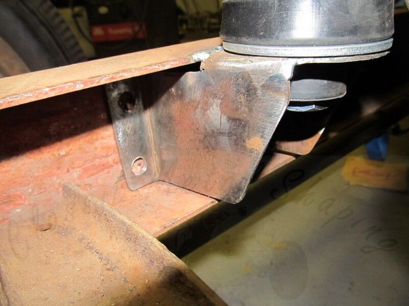

    My Mate Glenn came over and helped me fit the engine into my chassis...
    This seemed like the logical thing to do next. In order to work out the exact possition to put the engine in I mocked up the bits of body I have using the cowl frame I made, the door I borrowed to copy and the original bun panel with the new turtle deck panel I made earlier in the thread.
    With this done I set about making some engine mounts. I wanted them to be like you might find on an old car rather than 'street rod' fully butt welded jobs. I made a simple profile pattern and marked out the mounts onto some steel, not the best piece of steel but this will all be blasted before being painted in any case.
    Once cut out I folded them in my flypress...
    These were put in place then welded. I have some riveting to do in the crossmember so I could rivet these but I may plug weld them. they need a bit of tidying up as yet.
    Its been a long time since I posted but I have been working on the new bit of workshop as well as being very busy at work. I had the electrics done and had to find the money for all this but I hope to progress on the T now.

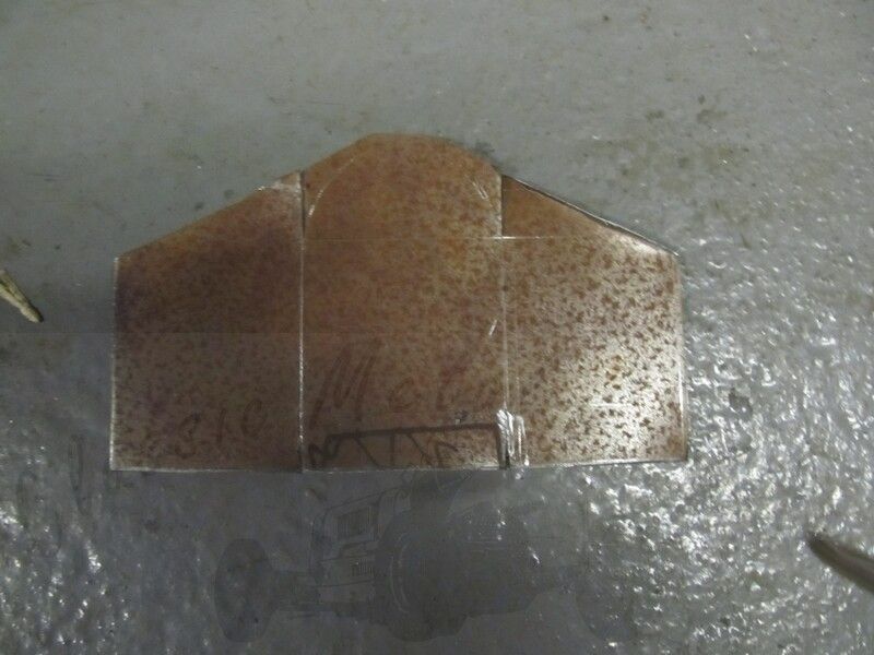

    from England
    been doing a little work on the T, something always crops up to stop me getting on. Here is what I have managed to get done lately.
    This is the patterns for the center of the crossmember/trans mount. I made patterns from scraps thin steel/aluminium whatever I had. they are in the foreground, the larger piece is a half sheet of 1/8th steel plate.
    I cut all my sections from this with a cut off disc in a grinder.
    For the main piece I folded a couple of flanges in my Edwards folder...
    Broke the back of it with my rolls, they are nowhere near man enough for this so I finished it by hand over a tube.
    ...this is the new part in 1/8th plate compared to the pattern...
    David
