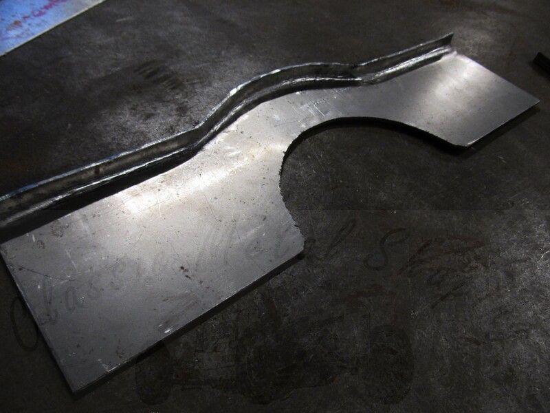

    I laid it on the ch***is upside down so I could mark the shape of the crossmember onto it...
    when it is up the right way it will also be rotated 180 degrees.
    I used the pattern I made earlier to check it was the correct shape and mark out the flange.
    below is what it looked like with the flange formed using a hammer and bench dolly.
    Checked it with the pattern...

    Next I cut out the side pieces from my patterns using my bandsaw, then I formed the bottom flange for these - again using a hammer and dolly...

    Here are the parts ready to weld together, this is all 1/8th steel as per the original material used.

    Be tough work bending the 1/8" thick steel when making the curved flange.

    Its 3mm but most on here would not know what that is, its the nearest we can get to 1/8th whats 1/8th 3.25mm? pretty close.
    Forming the parts by hand is not too hard, I use a slightly heavier hammer but I don't have to put a huge amout of force behind it. If you go much thicker it starts to get tough though!.

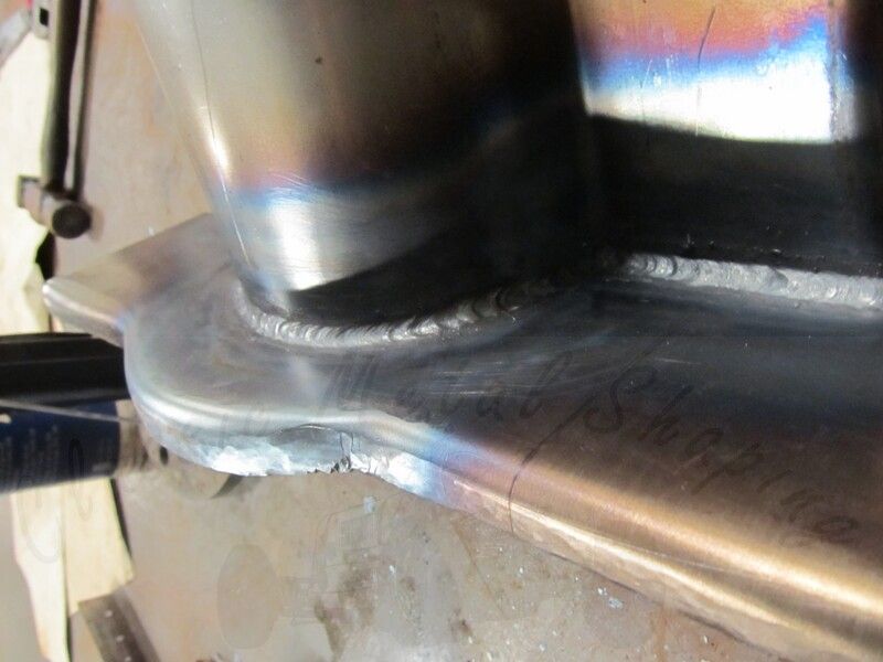

    I will have to sort my mistake out before this is fitted to my ch***is but I will show where I am with it now.
    The parts I formed were tack welded together...
    Then fully welded inside and out...
    I used gas welding for this.
    The other side was then tacked and welded in the same way...
    With a good fillet of weld on the inside and the outer corner reduced to a radius by welding I could clean this up without making the metal thin.
    Once I had cleaned up the weld on the outside with a sander it looked like this...
    I have made this so that it will rivet in place like the original part would have. Pitty I made a mistake in the design but I will sort that out soon.

    Nice to see someone can still weld with a torch. :D

    I got my first welding qualification in pipe and plate welding (gas and arc) in 1976 I can't remember the last time I gas welded anything other than thin sheet though so I am a bit out of practice.
