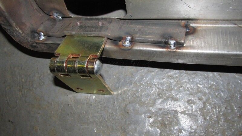

    I made the brackets for mounting the door hinges a while ago and I recently got round to putting them in the door frames, I think these should have been one piece but I have never seen a door apart and did not realise until I had this made. I am sure it will be fine. I simply s***ch welded them in place no-one will see this once the skins go on...
    and the other hinge...
    I did both doors at the same time of course. This is the only view anyone will ever get of this once it is all together...

    hinges turned out perfect! My doors will be cut open shortly so I can see what the stock arrangement really was.

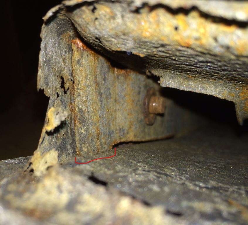

    As promised, here is a pic of the bracket. I haven't cut it out yet, but from what I can see its just wedged in there. The support is provided with a press fit into the beads.
    They are one piece per hinge on mine (2 per door), which are the later 27 versions to my knowledge (and similar to what you are replicating, large holes with more details)
    I think your method is better and more robust than what Henry did.

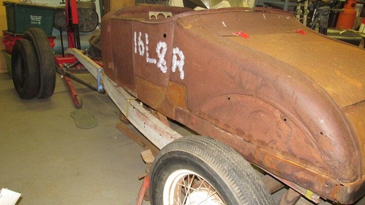

    Anyone that has been following this thread will know that I have been building my T body with information that I got from wherever I could because I did not have a body to copy. Well my mate Glen who has been helping me all through this build has decided it's time to recreate his first hot rod and has bought the '27 T body below. We went and picked it up from Norfolk in my van thursday evening. I will have this at my workshop for a while so I can copy what I need from it. This will make things a lot easier for me.
    I have made the bun panels now (almost anyway) so I have made all the outer panels for the main part of the body. I have still got quite a bit to do though especially on the turtle deck and having this will be a great help. Thank you Glen!.
