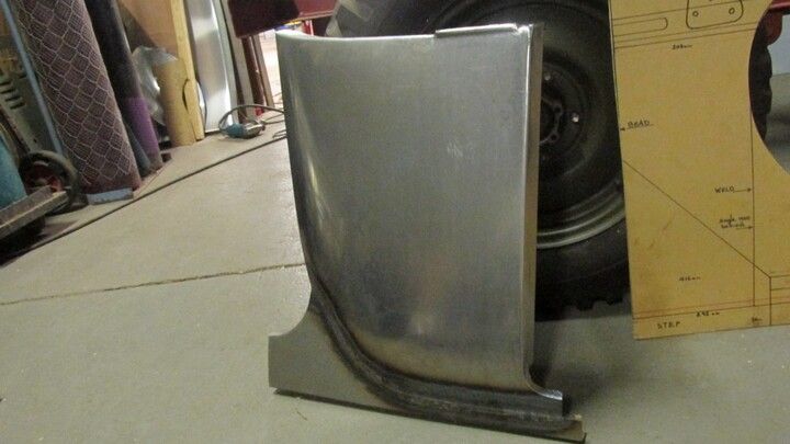

    Following on from the photos on the last page here is the almost finished bun panel...
    Inside...
    Just a little tweaking from here, and I have to dress the weld.
    David

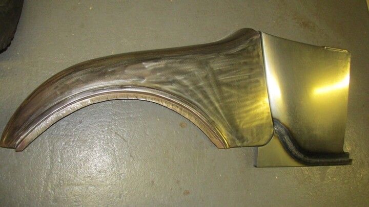

    I used a clamp to put the turtle deck panel I made together with this bun panel to check the fit. The top of the turtle deck panel is slightly wrong and when I checked the buck I realised that a chunk had fallen off. It has been knocking about for a lot of years. Simple enough to sort out.
    David

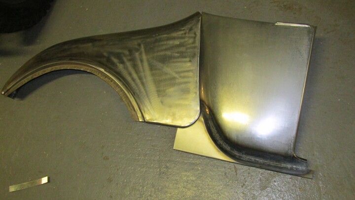

    Here's another shot. I had to clean a load of rust off the turtle deck panel for these shots, I am going to have to put everything in primer to stop it getting worse.

    One more photo o found.
