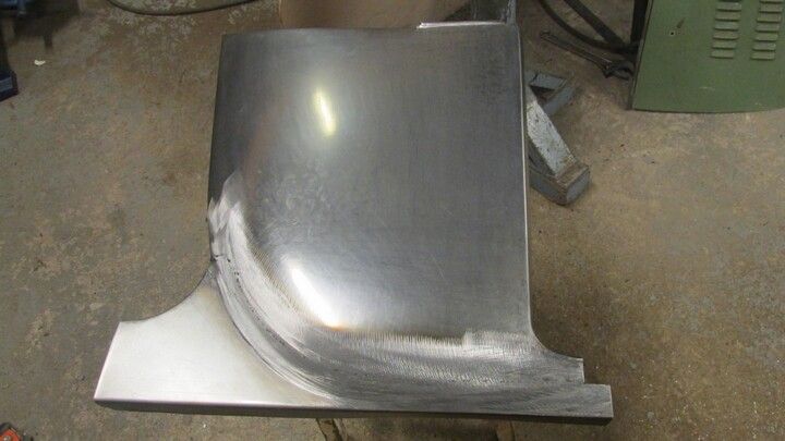

    Not really for this car but I made another bun panel this time in one piece because I had a good pattern, I wanted to see how it would turn out 'cos as I mentioned I may make a small batch of bodies at some point but more on this at a later date.

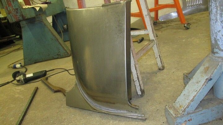

    this is the bun panel I made for my car...

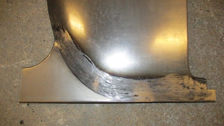

    The next job was to dress the weld. As I showed in the photos earlier the way I weld the panels leaves a very smooth panel that has very even penetration so when it comes to metal finishing i don't have to do any grinding...
    this is a close up of the weld after a small amount of planishing had been done and before I began to file and dress it.
    here I had begun to file and dress the weld...
    here it is pretty much dressed smooth...
    This is the metal finished panel once it had been lightly scurfed.
    Dressing this area out took just a few minutes because there is very little distortion to begin with.
    I put all the original details in the returns are correct to the original and the swage at the top was also recreated.

  6. How did you recreate the swage at the top of the panel David???

    I did it with a wheeling machine Mike. I put a couple of big shrinks in the panel and the rest was done on a wheel. A cheap little Chinese one. You don't need huge expensive machines to make panels. Glad you are still looking in.

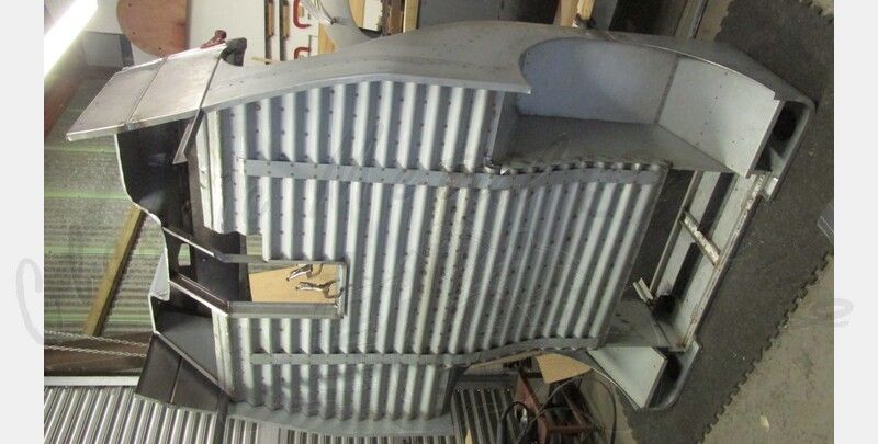

    I have been working on a replica of the prototype Bantam Jeep a**** other things. Not exactly hamb friendly but the right era.
    There were seventy of these built just prior to America joining the war. There is only one original left.

    We are building two of these prototype ww11 Bantam bodies from scratch. This one is done now all painted and on the road. We were working to a deadline. We made most of the panels for the second one at the same time and will begin to put it together soon. It was a lot of work we even created the corrugated sub floor for both cars ' cos you can't buy the correct profile.
