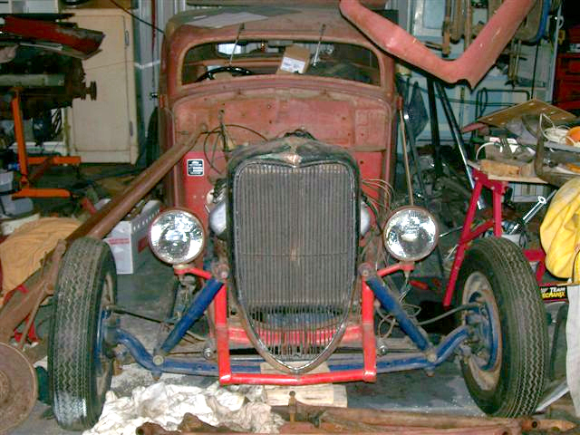

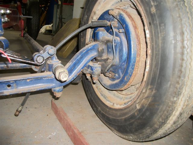

    Found a photo of the axle I dropped twenty five or more years ago. I did it the hard way with a sledge hammer and heat. Its been under this little pop (Anglia) Coupe that I built way back then. The axle is a Ford Pilot axle (more or less the same as a 32 heavy) The little Pop coupe is now in Australia and is being re-built by my good friend Bob.
    David
    Here is a link to the thread on the Pop (Anglia) Coupe http://www.jalopyjournal.com/forum/showthread.php?t=364638&page=2

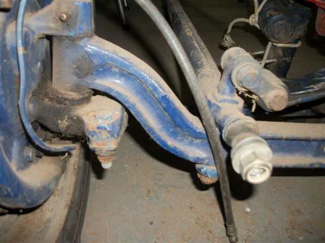

    is only one side of the axle dropped in this picture? hahaha, awesome!

  13. Heres a couple of pics of the dropped axle - taken yesterday

    Yea, then you soded off to Aus with them!. ha.

  16. Yea, then you soded off to Aus with them!. - Yup, certainly did.....

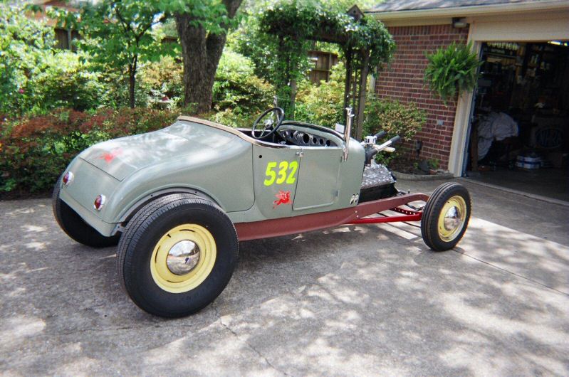

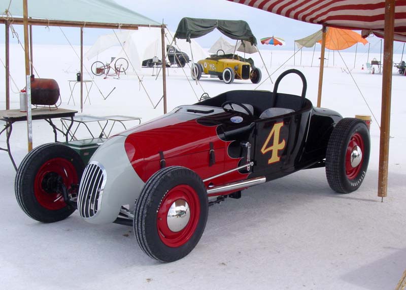

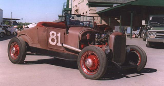

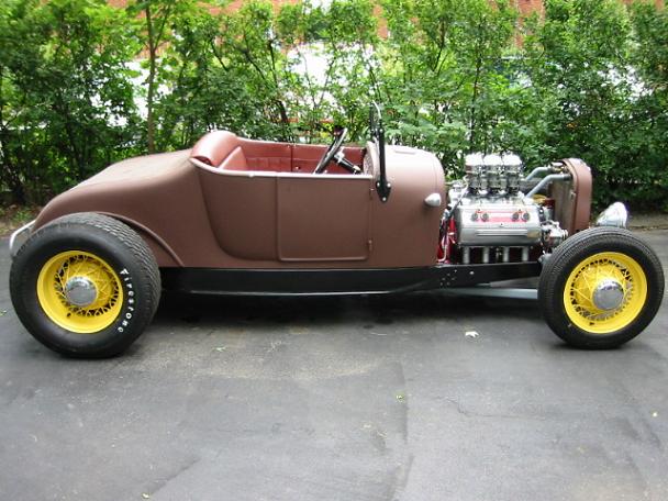

    Following your build, as I have the makings for the same car waiting in the wings.
    Here are some pics I've gathered, for inspiration:
