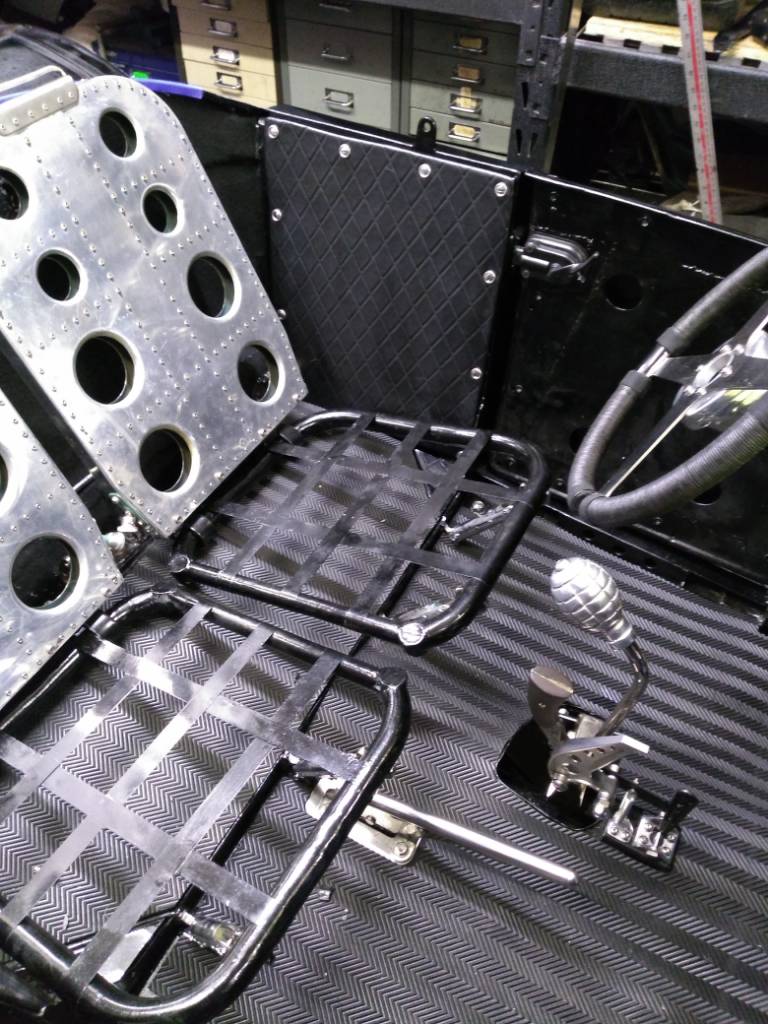

  17. Could not get my originals to fit and they were worn out anyway. I replaced them with early 2CV door locks and welded the T release lever on to the Citroen lock. IMG_20190728_172644738.jpeg

    Thanks Jack, good to know you are still on the forum and interested in this build. I bought repro catches and they were not bad but I had to modify the claw part that mounts on the 'B' post, this piece is not a very good replica of the original but it works ok once modified. Looks like your 2cv locks will work well.

    You are doing awesome work.I want to make this panel. Can you give any advice/instruction?

    I'm going to guess. Curve it, flange it, bead roller, holes last?

    Thanks for the question. First I made a buck, then I wheeled the shape into the panel. Next I put the beads into the panel then formed the flanges on the sides. The raised areas I put in with some simple tooling made from wood and rubber and a steel former. I then punched the holes then finally flared them on the same machine I use for punching louvers. You can see some of this in a video I posted in this thread a few weeks ago.
