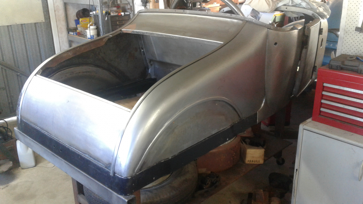

    The next job is to get the turtle deck in one piece and fitted in place. Here is a photo of the two side panels. The turtle deck is as much work as the rest of the body I feel.

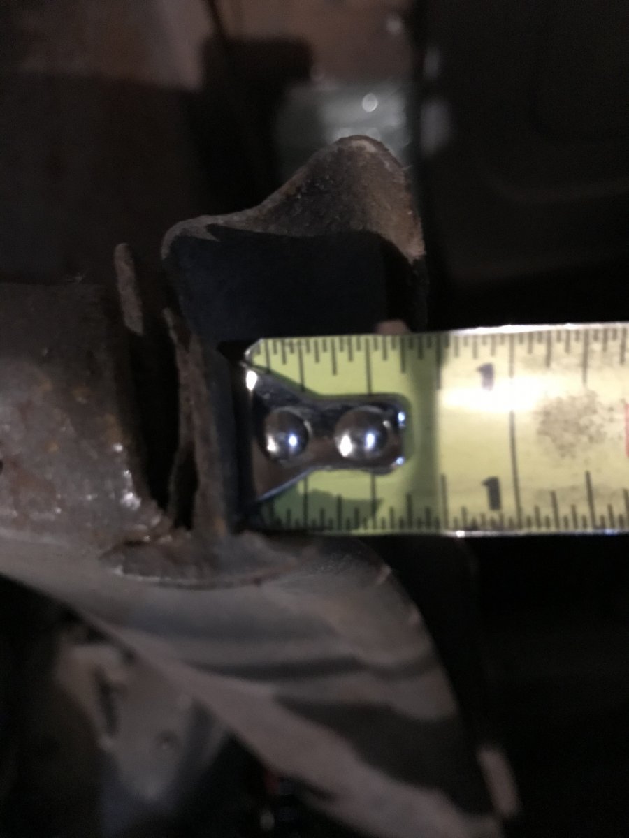

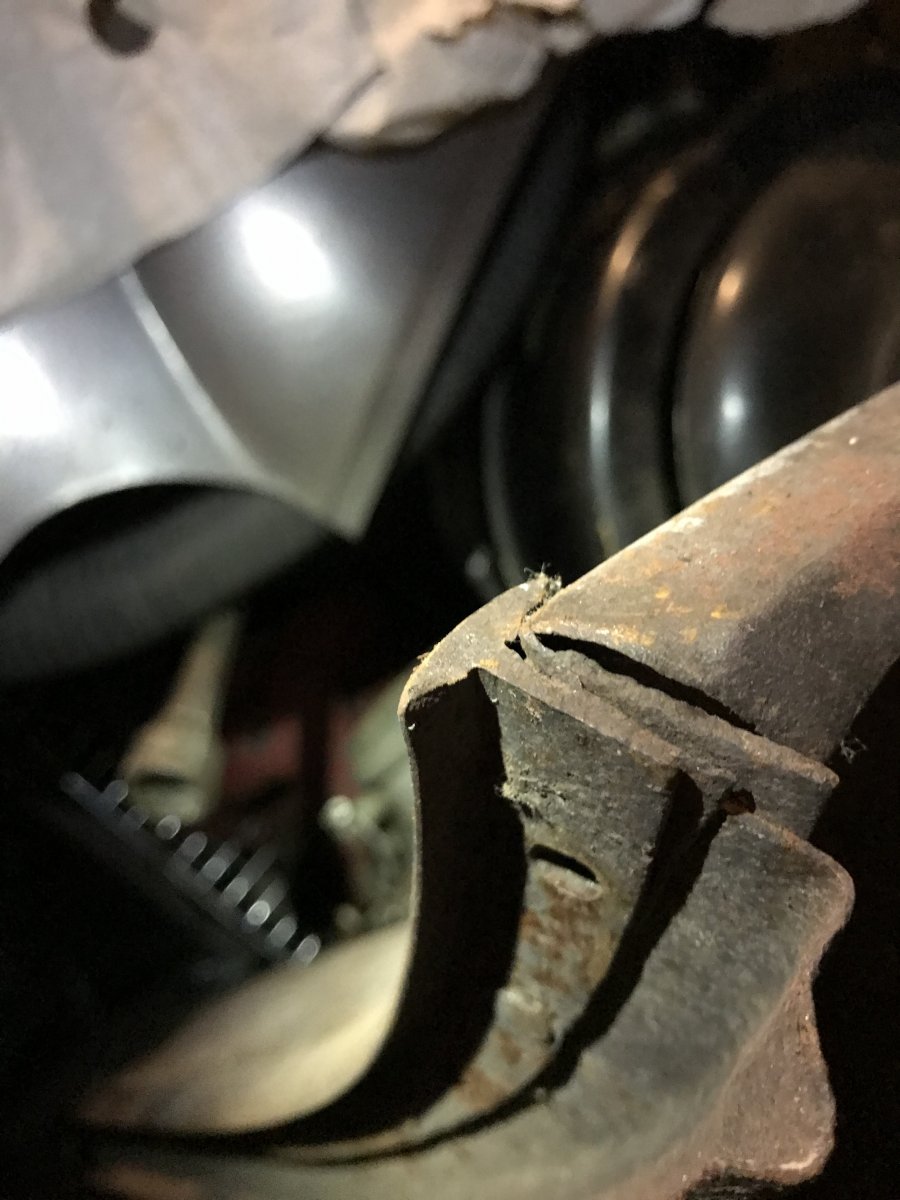

    I need a bit of help. This is regarding the T section trim pieces that run down the turtle deck from top to bottom on each side of the trunk. I was given some pieces of this which I am going to use. (Thank you Phil) My question is - one side of the top of the T section is longer than the other. Which way does the trim go?. I imagine the longer side sits over the sheet metal of the side panel while the shorter side sits in the gap over the gutter. ( adjacent to the trunk lid) Can anyone confirm whether I am right please?

  20. Does this help David? Sorry it’s kinda dark in the garage.
    6EADC586-4309-439C-9E01-4D20CBE77B90.jpeg 94C22888-07D9-4053-8A5B-CD54D64F789B.jpeg
    kidcampbell71 likes this.

    Yes, long side over the sheet metal. I made mine like this. MIG welded then took to it with a big grinder with sanding disc, finished off with body file.

    Thank you for being so helpful again Mike. That is a great help. I really appreciate you going the time and trouble to put up photos to help me.

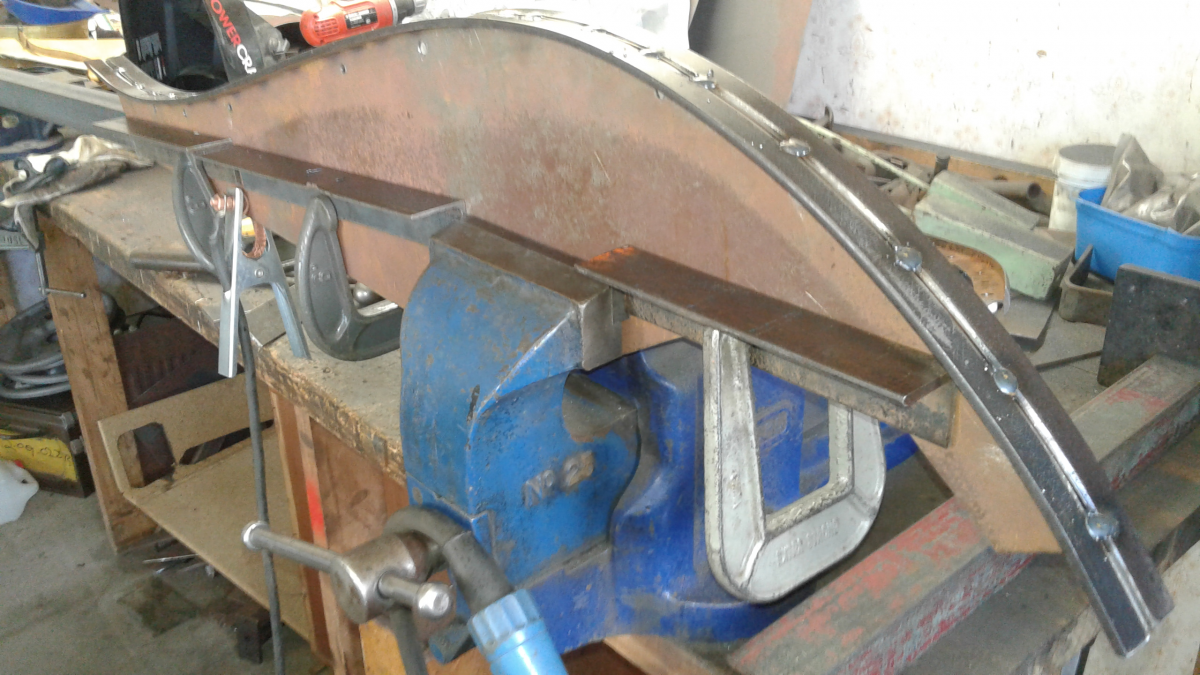

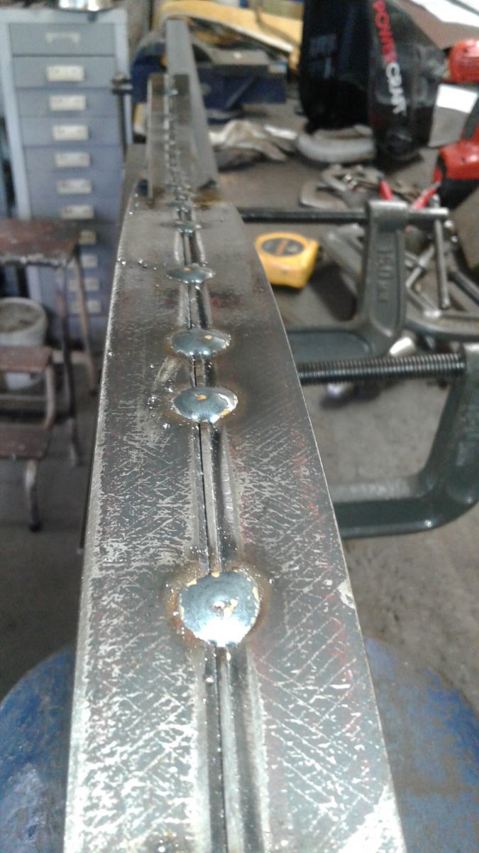

    Thank you so much for your reply confirming I was correct. I was lucky enough to be given some pieces of the T section. (Thanks again Phil) but these were not from a 27 roadster. They are not quite long enough and were not the right shape so I will have to make up a foot of so of each side and change the shape. I am doing it in a slightly different way to the way you did it. I will post it on here at some point. All I can say is wow! To the way you did it!. I looked at doing something similar but after trying a short section I decided it was a m***ive amount of work. Well done to you. Your car looks good. I see you have made quite a few panels for it.

    Regarding T SECTIONS. I have drilled holes in the horizontal piece above the edge of the vertical piece then plug welded. This keeps shrinkage to a minimum.
