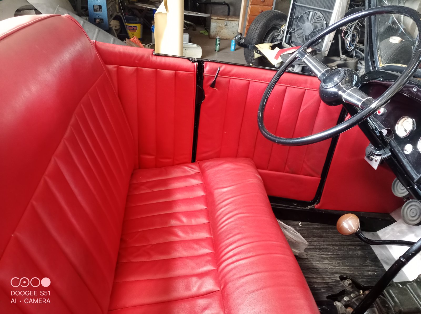

    I created an interior for the car by buying two front seats and a rear seat from eBay. These originated from an old Austin. I cut the rear seat down added some extra metal and foam in the appropriate places to make it fit the car. I used the front seat swabs and backs to create the trim panels for the doors and bun panels. The vinyl from the back of the front seats I used to cover the kick panel area. It's all proper tuck n roll. I used foam board as a backing. I am very pleased with it. It's not perfect but it has a patina and looks the part. Best of all it cost a total of around three hundred pounds. About four hundred dollars. IMG_20240227_114857_031.jpg
