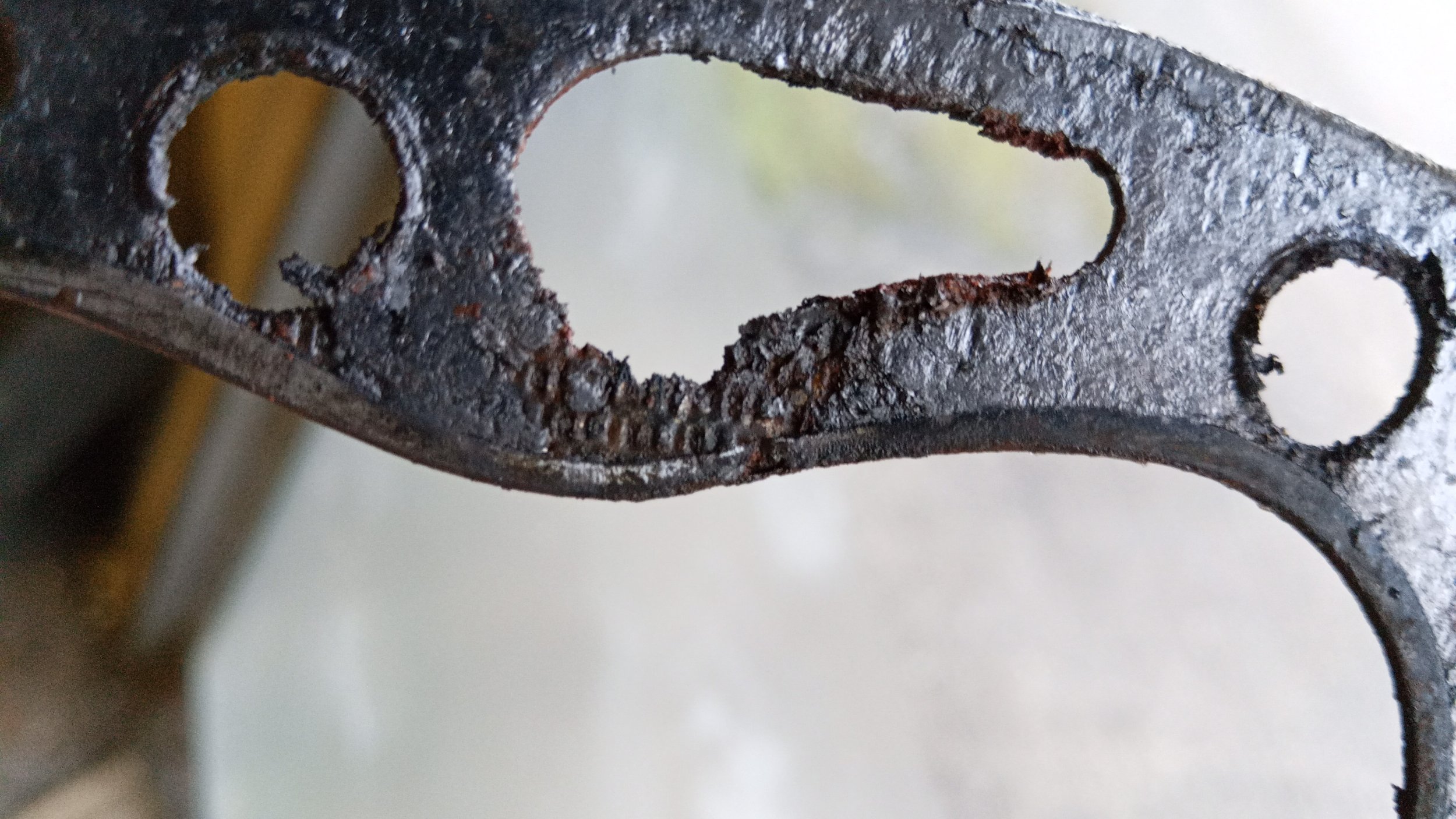

    I spoke too soon the other day when I said the car had run without any problems. Tempted fate I guess.
    I checked the plugs a few days ago and found one was wet with water. It's been a bit smokey too so I decided to pull the head that side to see what was going on. I suspected the head gasket had gone. Sure enough it looks like that's what it was.
    I will now strip the rest of the engine to try and find out why is smoking. So here is the head gasket. These were new less than 3000 miles ago.

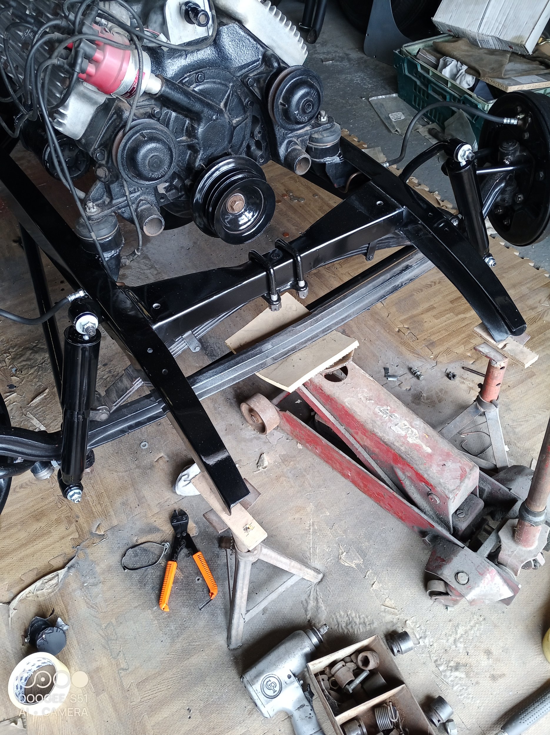

    IMG_20241016_112250_112.jpg So this is my car today. Tomorrow with the help of my mate Glen (I don't know what I would do without your help mate.) I will pull the engine and begin to strip and examine everything.

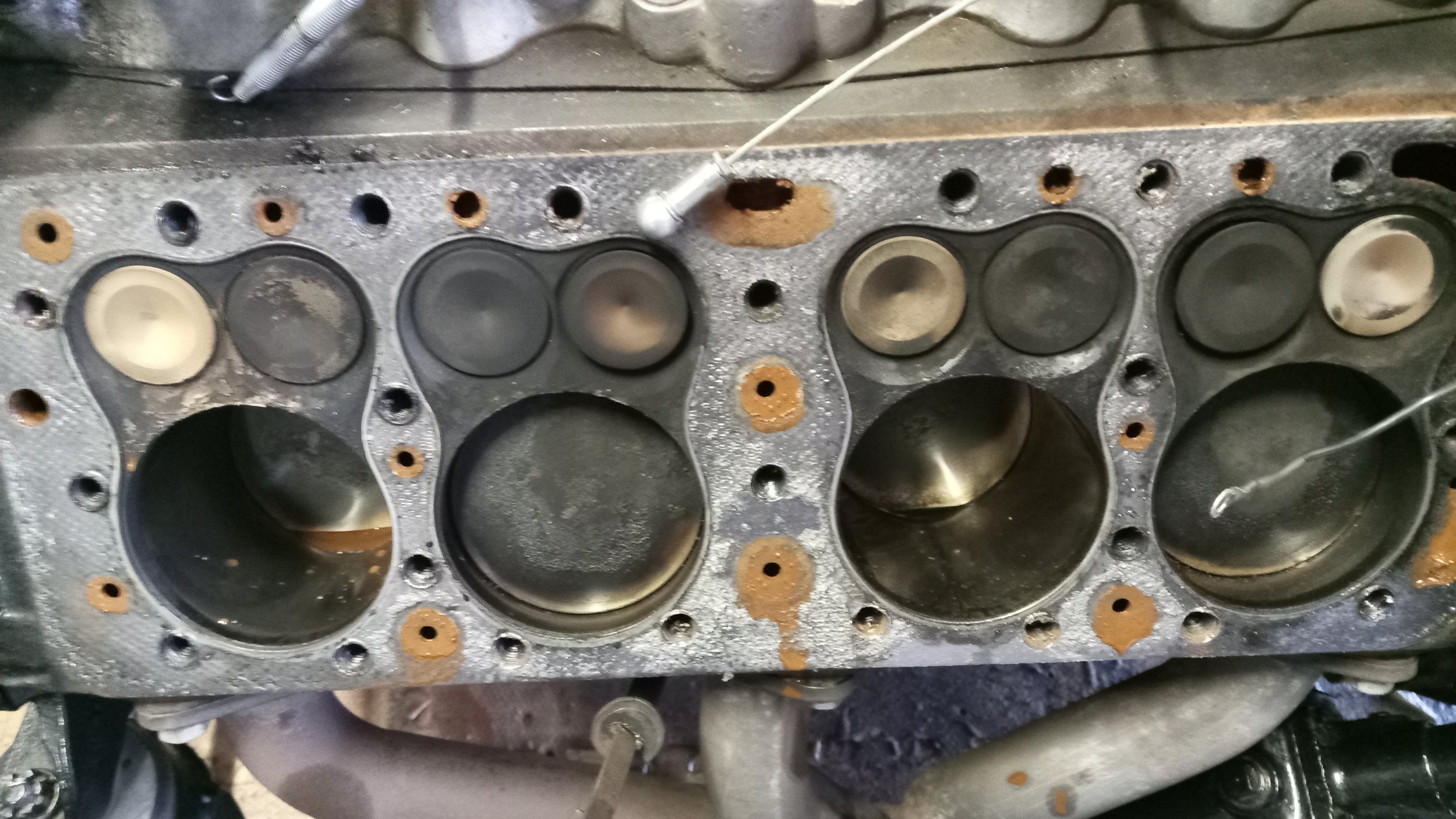

    from England
    IMG_20241015_104644_565.jpg so water in no. 4 and oil in no. 2 cylinder. There was water in the valve chest too but the oil seems ok. This might be because I caught it before the oil got emulsified. I investigated originally because it overheated and then pushed a lot of water out of the overflow when I topped it up.

    I've been told to never jack one up, using the axle? Was my advice incorrect?
  13. GuyW
    Joined: Feb 23, 2007
    Posts: 714
    GuyW
    ? There are not many of the parts that are stronger than an axle on an early car, so in that context I'd say yes, that was incorrect.
