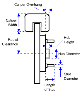

  12. RodStRace
    Joined: Dec 7, 2007
    Posts: 9,857
    RodStRace
    A drum brake is flat at the wheel mounting surface. A caliper extends past this plane. Wheel must have clearance for this. Labeled overhang here.
    As said American cars started getting discs in the mid to late 60s. Those of the late 60s tend to be narrower than the 70s and often restorers will create demand for them. So narrow and harder to find and more expensive or wider and likely easier and cheaper to find. Most will not accept old center caps. Full wheel covers may or may not fit. A very deep style like the 50s Caddy probably will not.

  21. 57JoeFoMoPar
    Joined: Sep 14, 2004
    Posts: 6,539
    57JoeFoMoPar
    Thanks for the input fellas. I agree that it mainly has to do with clearance for the caliper, as @RodStRace points out with the diagram posted. A buddy saw this post and reached out that he has a set, so hopefully that's the case.
