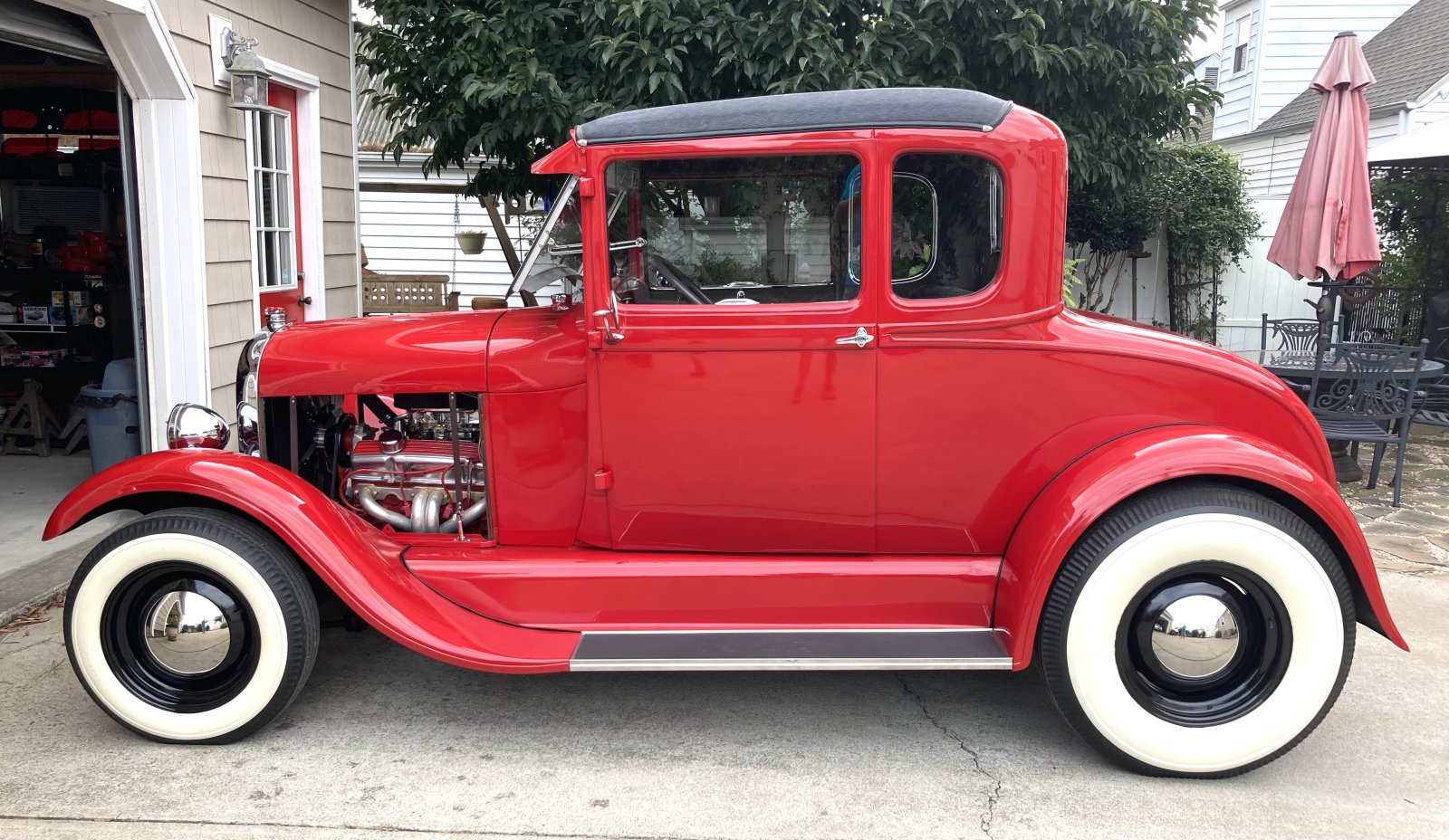

  2. catdad49
    Joined: Sep 25, 2005
    Posts: 7,013
    catdad49
