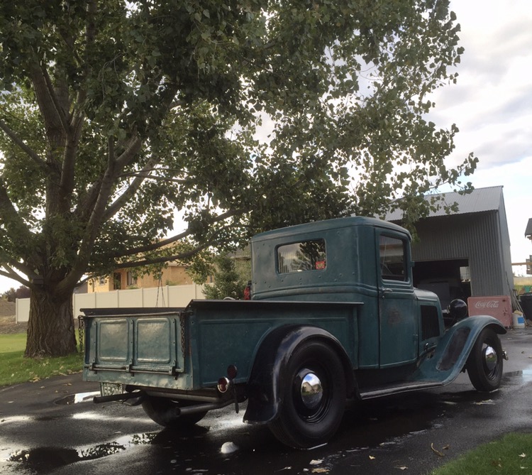

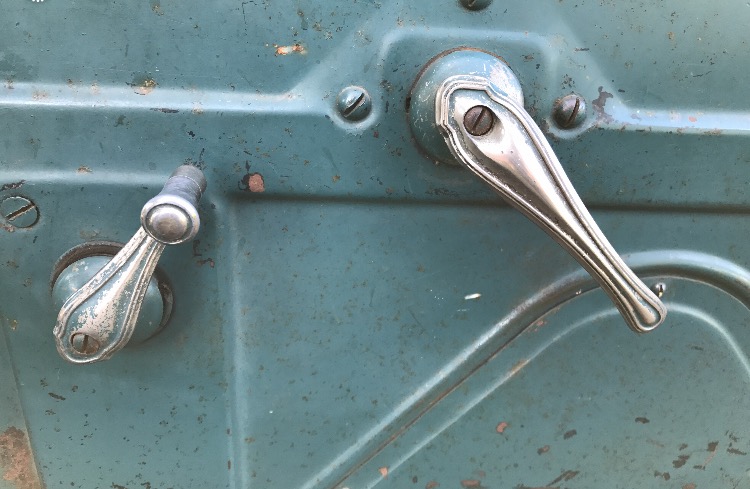

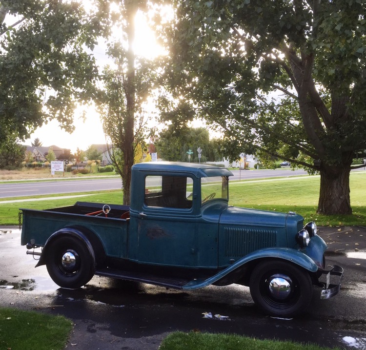

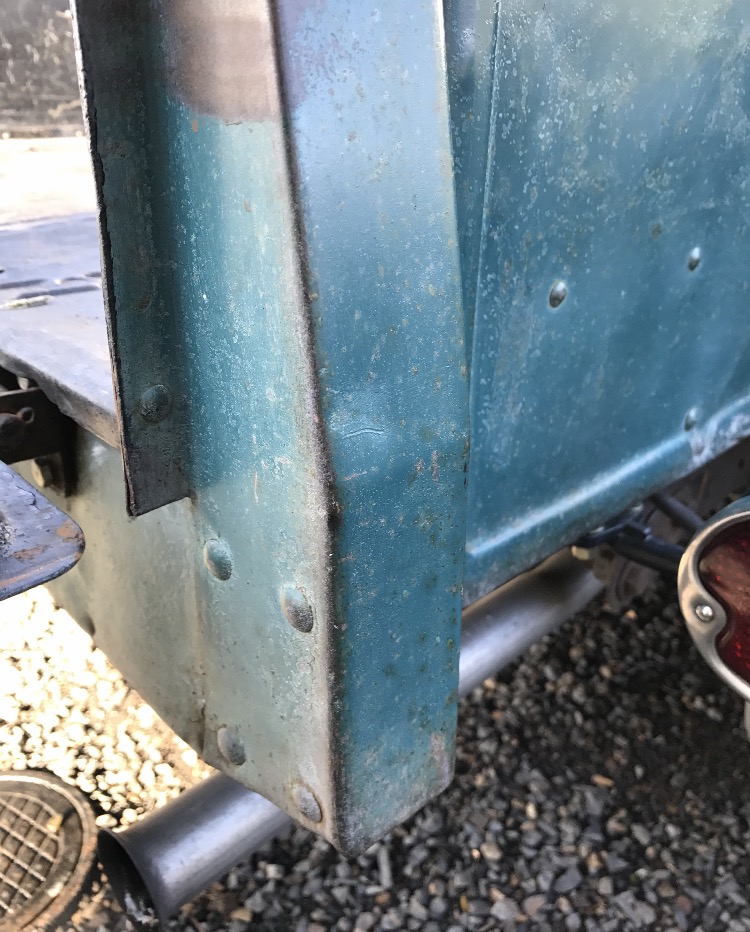

    Good question. I have thoughts about selling my 33 pickup, but would like to paint and install the correct rear fenders before I do. Problem is, it has one repaint and it is 60-70 years old and not only dull, but has a lot of character as well. Not sure I'd ever be able to pull it off?

    Can be done. I did it to a 39 Ford several years ago. Car had a 50ish year old well seasoned paint job with lot's of character as well. Someone before it was painted had welded in VW headlight buckets, guess they thought 6v seal beams would be an upgrade, but they looked terrible. I repaired the fenders and painted them in matching the paint, rock chips and all. I tell people it was the hardest ****py paint job I ever did. Really, not much different then these guys doing fake "patina" except you have to match the color including any color/ primer that is showing up under the paint. PM me if you want tips on how to do it. Thought I might do a tech tread on it someday although not sure how the board would feel. I know how most feel about fake patina (me included) but matching existing might fly. No photos of the 39 but I have this, I know it's an OT car but I painted this fender just a couple weeks ago. It was involved in a minor wreck and replaced the fenders with a junk yard replacement. He didn't want to paint the whole car yet yet didn't want to have an orange fender on it. DSC_0246 (1).JPG

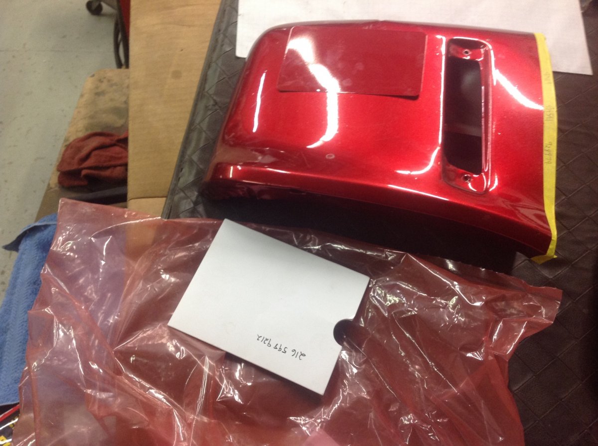

  28. BS,
    That pic I posted came from a huge manufacturer's color lab with unlimited resources.
