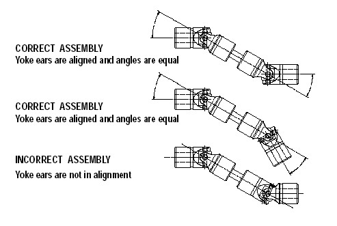

    Don't take the three degrees as gospel. The only gospel in the driveshaft is that the input angle needs to match the output angle in the opposite direction. It might be two degrees, or four, or five, or seven. It doesn't even care which one is pointing uphill, and which is pointing downhill. Just as long as they are opposite like in Gimpy's drawing.

    Opposite direction is not gospel. Keeping the angles the same, or as close to the same as possible, is gospel. As long as the angles are the same, they can both point up, both point down, or be opposite. The second configuration in the image below, known as a "W" configuration, is what the setup is called when both angles are the same direction.. Not normally used in our hobby, but in odd cases where you have to do it, it works as well as the top configuration does.
