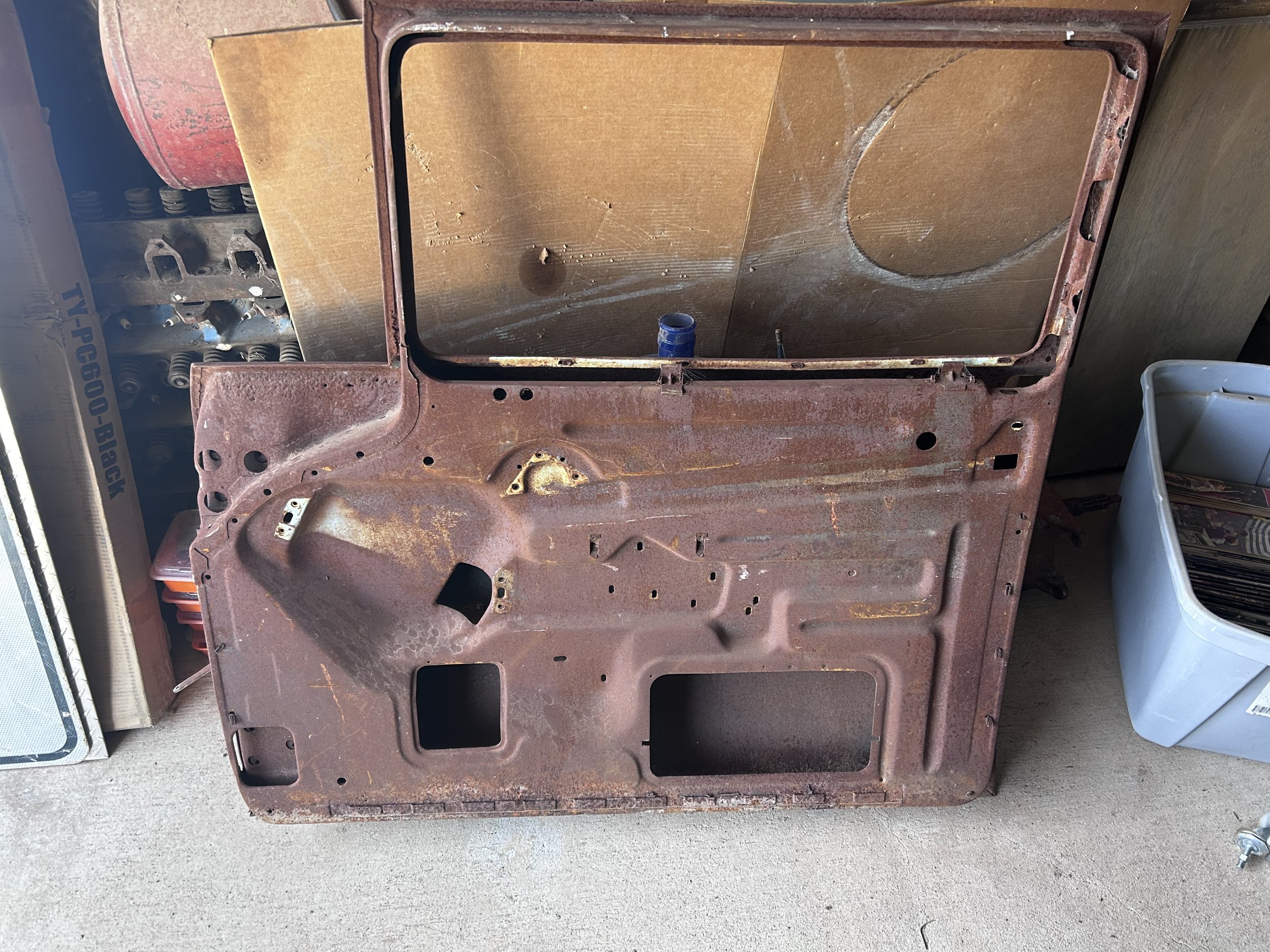

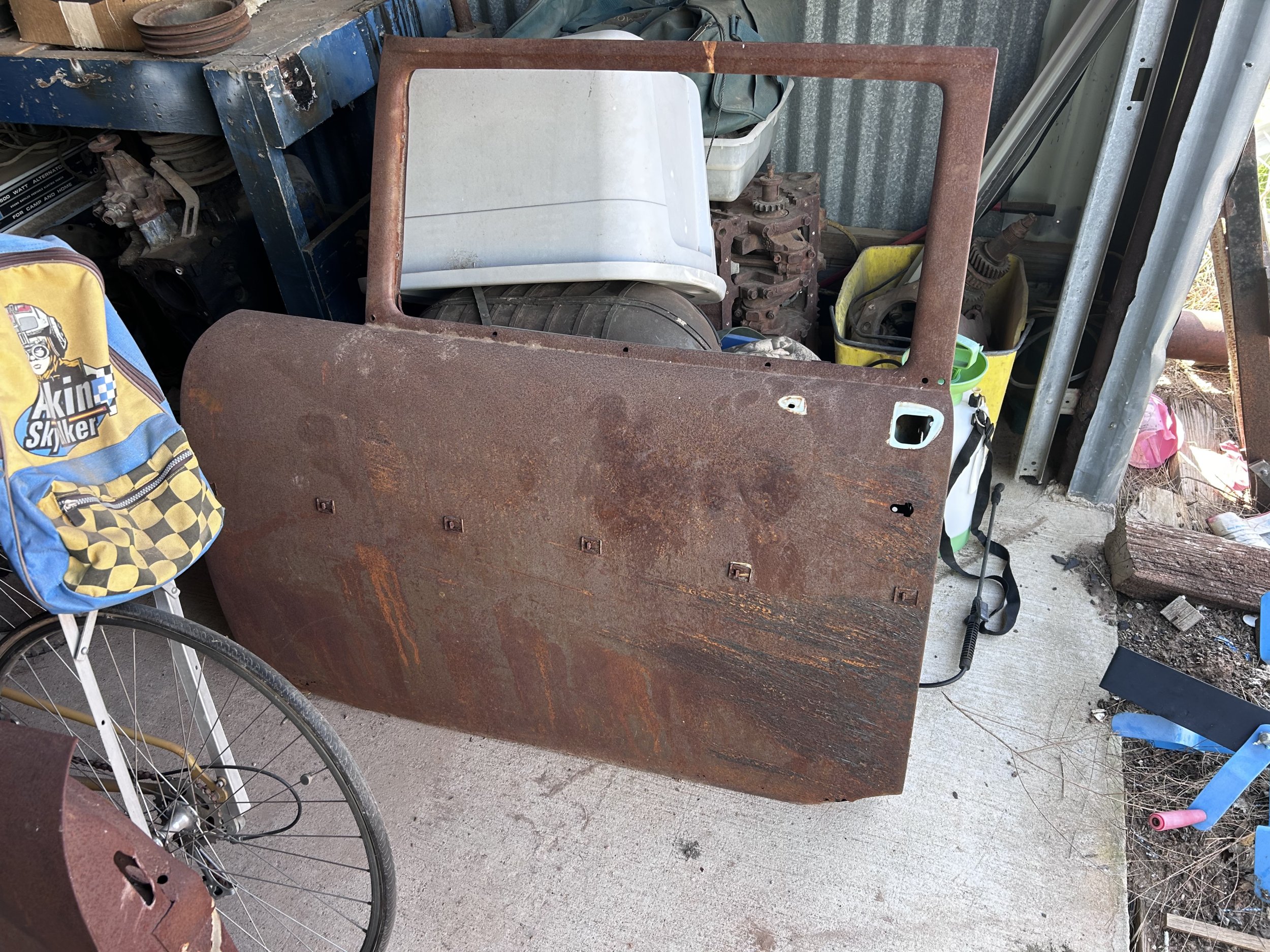

    I bought these doors sight unseen thinking they might be 55 Chevy. They’re not. What are they?

    A mid 50's car with a wrap around windshield.

  3. Going by the white paint under the door handle it was'nt a yellow cab/taxi o_O

    Ford...55-56ish....

    Are you sure, or guessing? I thought that might be it but wasn’t sure about the trim holes.

    I'm pretty sure, based on looking at pictures of the Ford service manual for those years that show the inside of the door, and also knowing that that particular shape of door was used those two years.
    The trim looks like the 55 Custom.

    oh...one other way to tell right away that a door is GM or Ford is the shape of the hole for the lock. GMs used a round hole with 4 square tabs poking into it, while Fords had that funky old keyhole shape.
  12. I'm looking at the shape of the door handle paint remains, concur it's not Chevy.

    Inside looks exactly like my 56 Ford
    sedan delivery

    upload_2025-4-19_9-41-17.jpeg 1952-56 Ford door handle shape looks to be the same shape as the leftover paint remnants. 55-56 Ford looks spot on. upload_2025-4-19_9-41-17.jpeg
