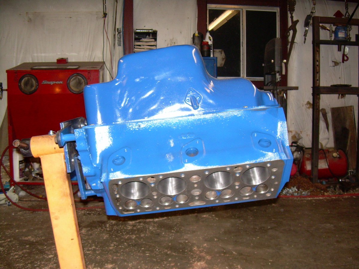

    Soft plugs in the 348. Will get new paint, rebuild carbs, Edelbrock valve covers and just an overall cosmetic freshening up.[​IMG][​IMG][​IMG]

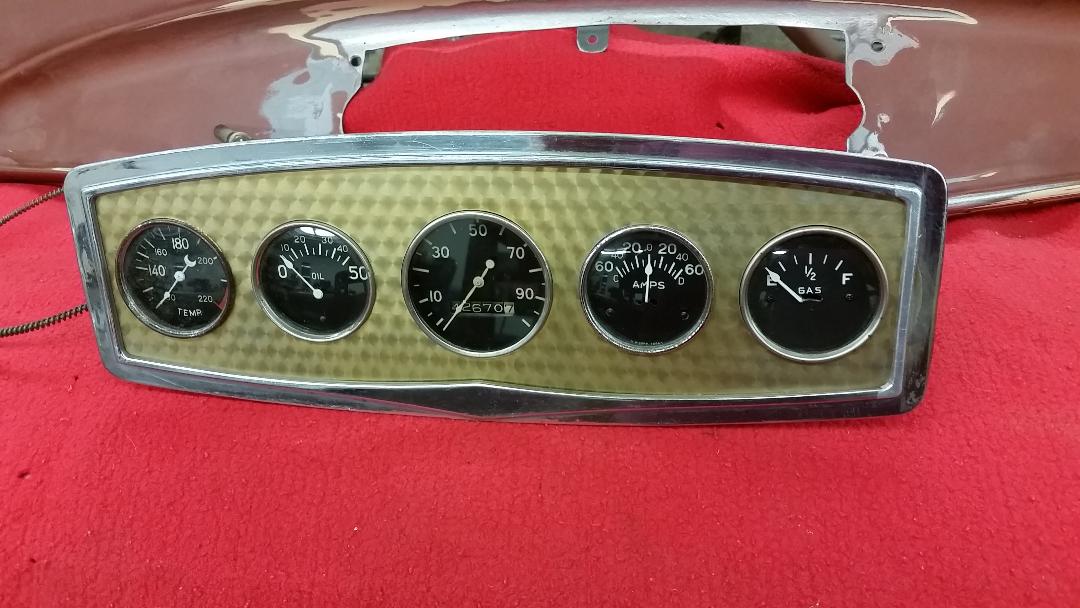

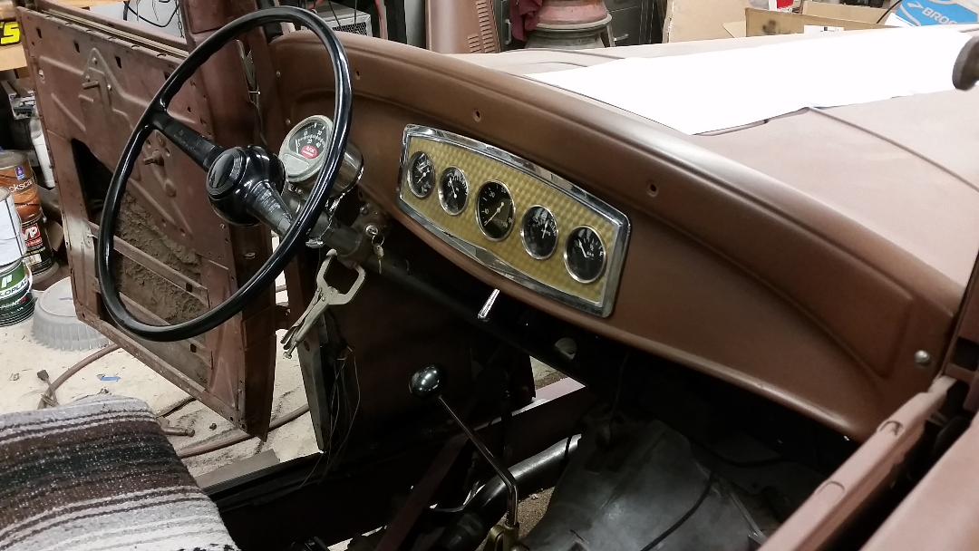

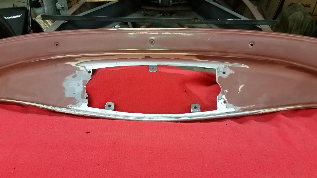

    Finally got this panel put together. Made new engine turn face, and dipped it in alodine. Dash to follow soon. thumbnail (94).jpg thumbnail (92).jpg

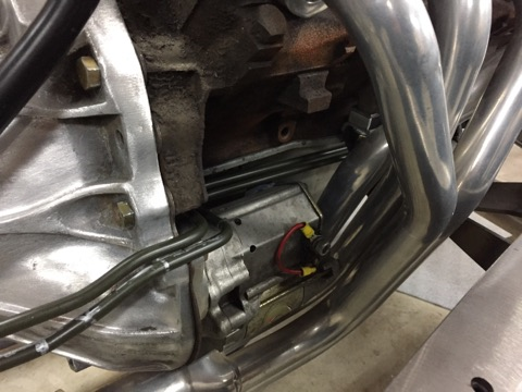

    Running cooler lines for the ****** in my '32 ch***is. First time ***embling coated/braided PTFE lines with AN fittings. I now have no skin on my thumbs. Time to get some brackets and mounts. Also made the hard line from the vacuum modulator to the back of the intake runner.

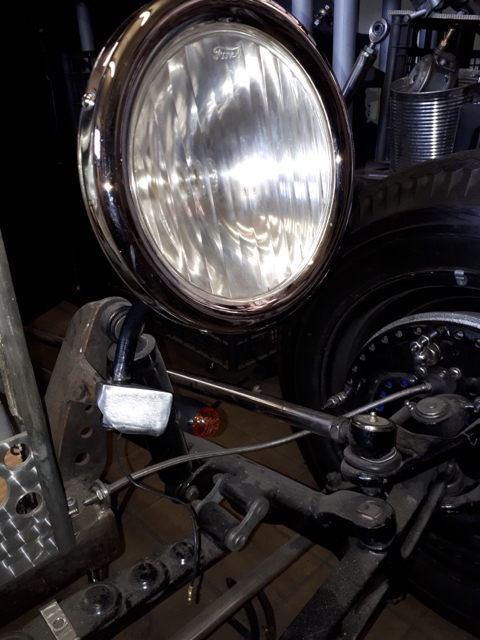

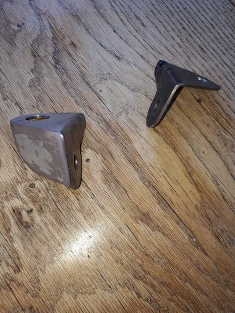

  13. Made some brackets out of box section to mount little motorcycle bullet-style turn signals underneath the Model T headlamps - then filled in the gaps to make it look like a cast piece. Just a small thing but I like it.

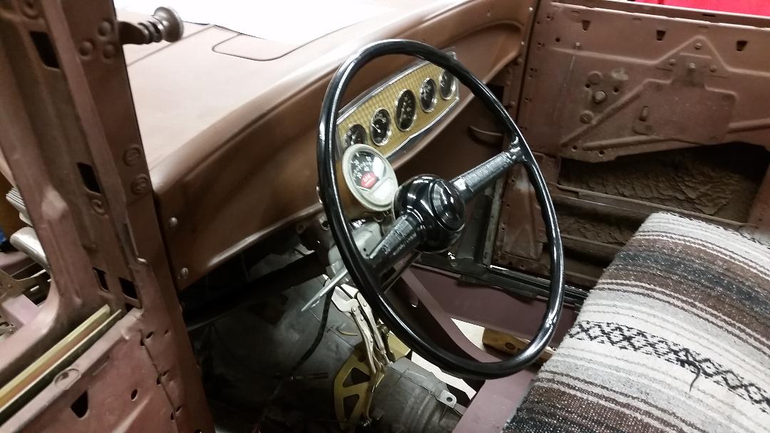

    Got the guages and vega steering box mocked up on my sons 31 Model A. The steering wheel is temporary while we finish the final column adjustment. IMG_2405.JPG IMG_2401.JPG

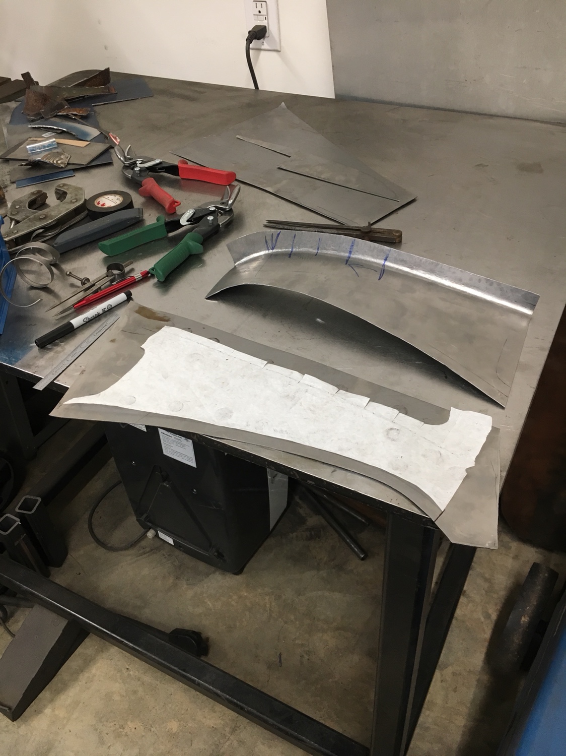

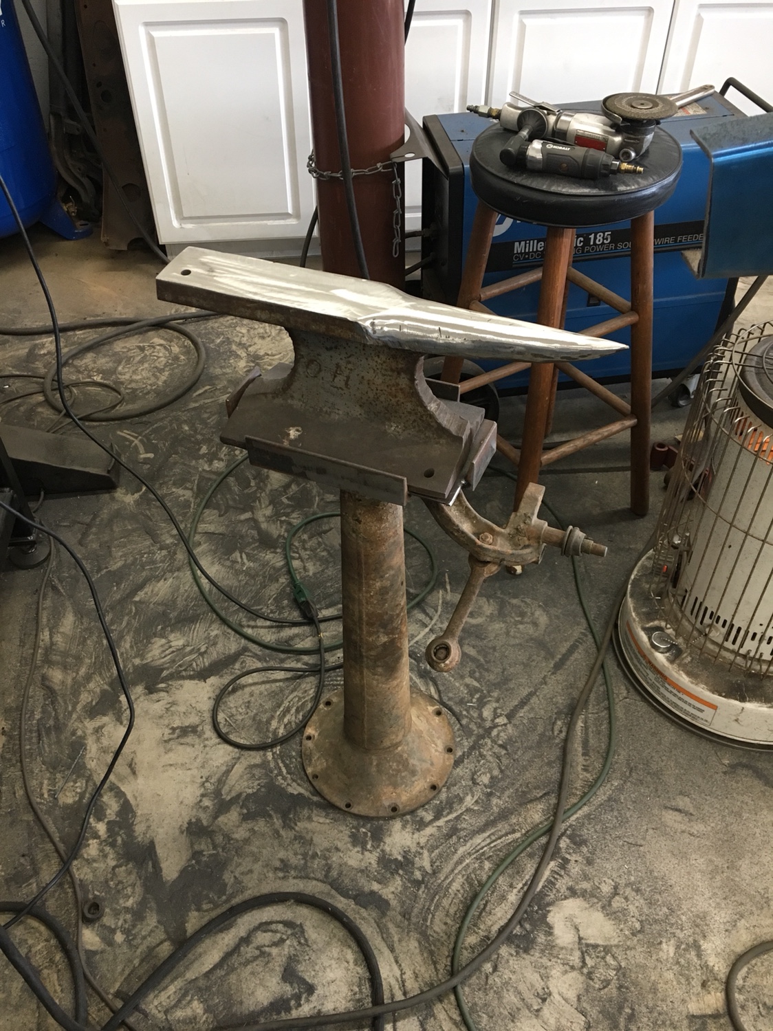

    Made a stand for a train track anvil, ground top of said anvil, and started making cowl top for my coupe [​IMG][​IMG]
