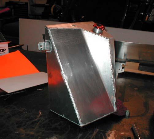

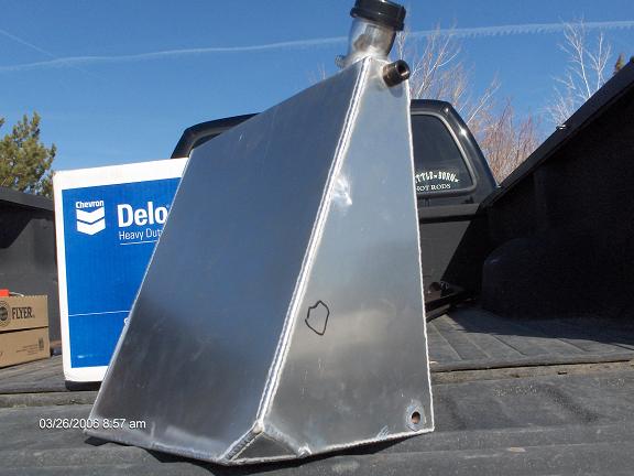

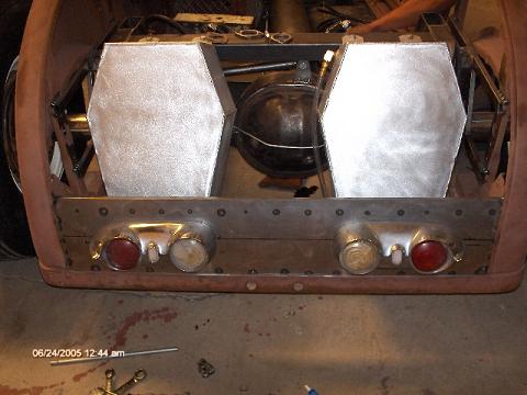

    seems to me that 90% of the guys i know building hot rods are in need of some type of fuel cell, and with the limited space we're all working with, catalogue fuel cell dimensions won't cut it. i've been making custom-sized aluminum cells for awhile now, and everybody seems to need one, or have a buddy that does. just curious as to how much need is really out there. here are some pics of a few i've done to get an idea. i just know that anytime you call a big-name cell manufacturer, they wont touch a custom application for less than about 800 bucks that i know of... even for a damn rectangle w/ no tricky stuff. what have you all been doing??
