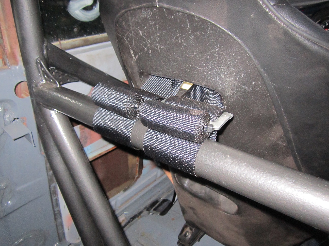

    I took my bolt in harnesses apart, removed the bolt on bracket and installed it directly to the bar. Turned out nice and didn't have to worry about mounting angles. The excess was rolled up and a tie strap bundles it together nice.

    That looks really slick.I'll have a look at mine when I get out to the shop on Sunday.I have the "Y" type instead of the individual straps,so it may be a little different,but I'll give it a try.
    Thanks for the tip on that!

    Scott just keep the routing configuration the same for the harness so it works correctly and basically the roll bar replaces the bracket in the ***embly. Mine are individual because I have a bracket in the middle of those two that mounts the seat back to the roll bar. Bill
