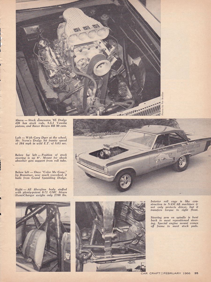

    Well this isn't the Stardust but its a Dodge :)

    Except that's not a Charger.....What is that a Coronet?
    It says in one of the captions it used to be the Roger Lindamood "Color Me Gone" car.....That's cool.
    The Tasca Ford A/FX car ended up like that....Sam Auxier ended up running it with a tube axle as the "Bowani" car.I only found that out this year.
    Man those cars got used and abused!
