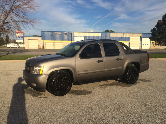

    I don't think my Dad would be up for towing the Shaker for 8 hrs behind his BBC powered Willys coupe,but I did pick up a new tow rig last week:
    Hoping to get back to work on that motor,and a few other small details right after Christmas,and have that thing ready to snap crackle and pop by springtime.:)

    Scott how hard was that pill to swallow to buy a brand C tow rig?

    HHmmmm how about a front view pic. of that nice new tow rig.:cool:
    The low profile tires should really help with trailer sway. (But watch the bumps):eek:

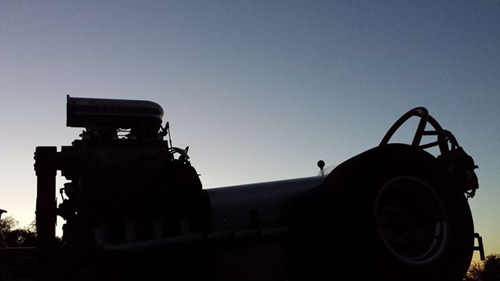

    AJ, love the pic! Very cool...!
    Jimbo...
