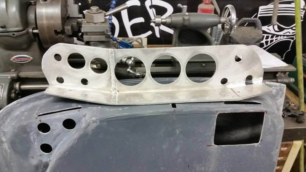

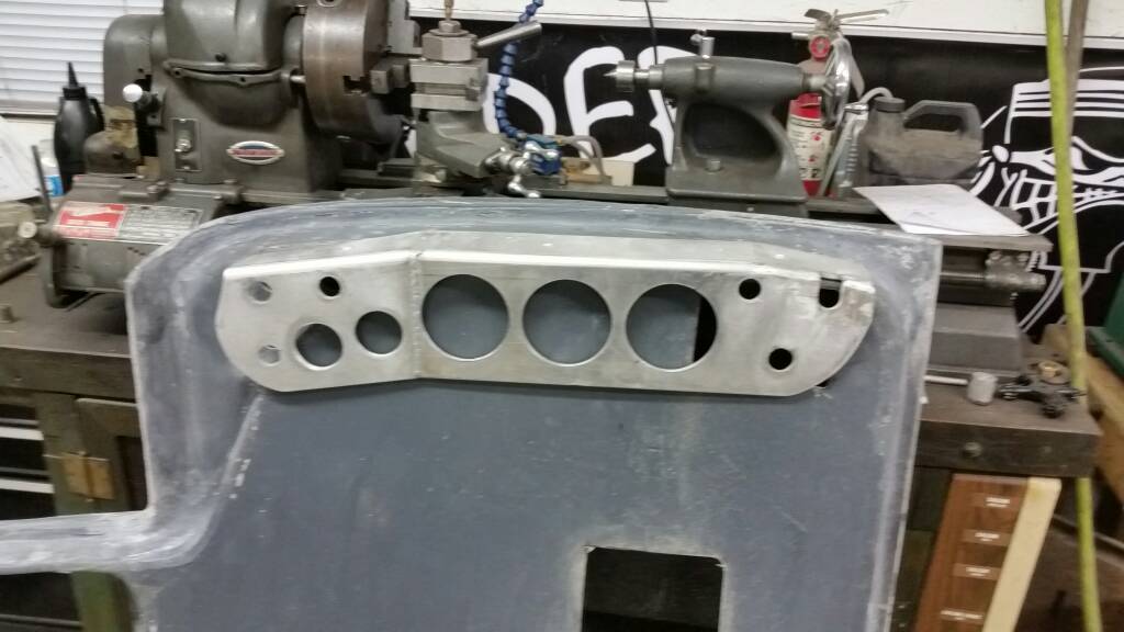

    This is how I did mine. The hinge bracket is aluminum and is panel bonded to the fibergl*** so the fibergl*** by the hinge is really strong. Anyone not familiar with panel bond it's basically what holds most cars together now days so once it is glued it's not comming apart. I Still haven't made the turn buckle for the inside yet but I plan on it.

    Looks a lot better than mine, I don't have any experience or welder for aluminum. I'm using square tubing spaced out to the door from the hinge. If I build something it will look similar to the factory deal and bolt it to the end of the door like my small bracket than a support bracket on the other end. If my old door were total junk I would be tempted to cut them apart and use some of that section.

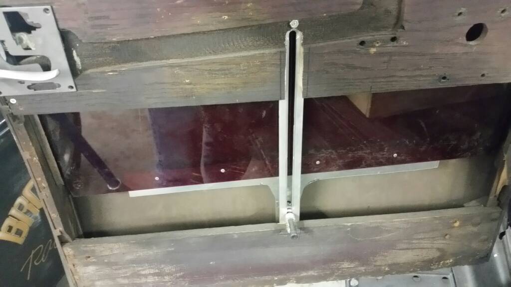

    Mine will have lexan the go up and down. This is a pic of my 31 chevy of kinda how I plan on making them go up and down. My buddy did these ones before I bought it from him. They are spring loaded and the bolt just pushes in to move it to the next groove. These ones only have up or down but u can machine different slots if u want them to be more ajustable. Mine will probably have more slots so it will be a little lighter
