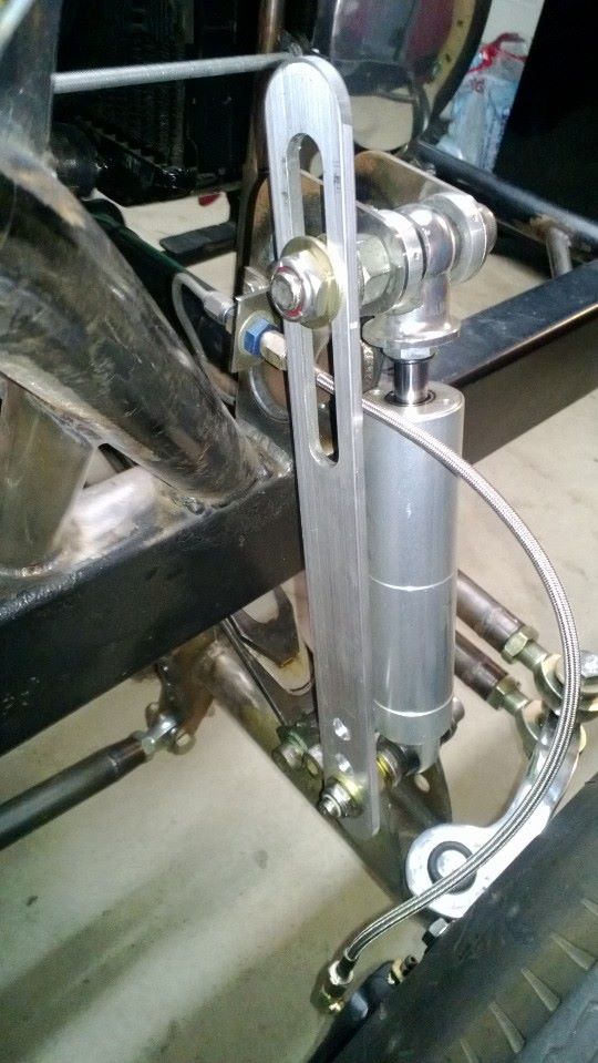

    Make youself some adjustable front end travel limiters while your at it. Restricting front end lift on a good hooking track can pick up the 60' time/ET a lot. Years ago, my roommate and I spent a day @ LACR doing 60' testing on our '72 Chevelle wagon, and picked up a whopping 12 hundreths (THATS A TENTH & 2 HUNDRETHS!) just by limiting the front end travel. It didn't look, or feel as cool leaving the starting line, but that much gain you can't ignore. If you look at this shot at the Meltdowns last year, the front end is completely extended, and the spring shackles are parallel to the front axle. If we'd had more time, (or even known what was going on at the time) I'd have rigged up some limiters. Got them made now. We ran low 1.4 60' times like that, and I'm very confident, with the 4.88's installed, the limiters dialed in, and a little more shock/wheelie bar tuning, touch more air in the slicks, and a little less base pressure, we will be well into the 1.3 60' times. Plus, the front wheels will be higher in the air. :) Melt Down Launch.jpg PS. Kip had asked about tires on this thread, or the Border Bandit Builds thread. I noted that we had run 16 psi @ The Meltdowns, and someone said the Hoosier rep said 11 psi was the hot ticket. Look at the rear tires in this pic, and tell me you would take 5 psi, out of them. On the contrary, we could have added 2-4 psi in my humble opinion. We do have tubes in ours, where many run without, maybe that's the difference. Like anything else on a race car, read the tires, and they'll tell ya what they need

  19. One last note on the front end limiters. Quain, and most his guys use chain, or a cable lanyard for their limiters. This is fine, and maybe a little more era correct, but their cars (except Donovans Anglia) are parallel leaf setups. On our car there was no "clean" place to do the chain/lanyard deal, without chance of them catching/hanging up on something. So after looking at it awhile, these adjustable aluminum plates are what Marc & I came up with. In the pic, the plates are in the 3'' travel location ( without anything, we have 4'' of travel).

    Ric,I'm really liking the simplicity of that limiter you guys brewed up for the Child....Adjustable for tuning to track conditions,but not over complicated.

    RIC, Thanks for all the info! Before I made lower bracket, my shock at full extension was the limiter, (1" of travel) with the lower bracket now I've got about 3.5" of travel. But I think I can figure something out with a chain or cable lanyard... But I do like that limiter bracket you made! Jim...
