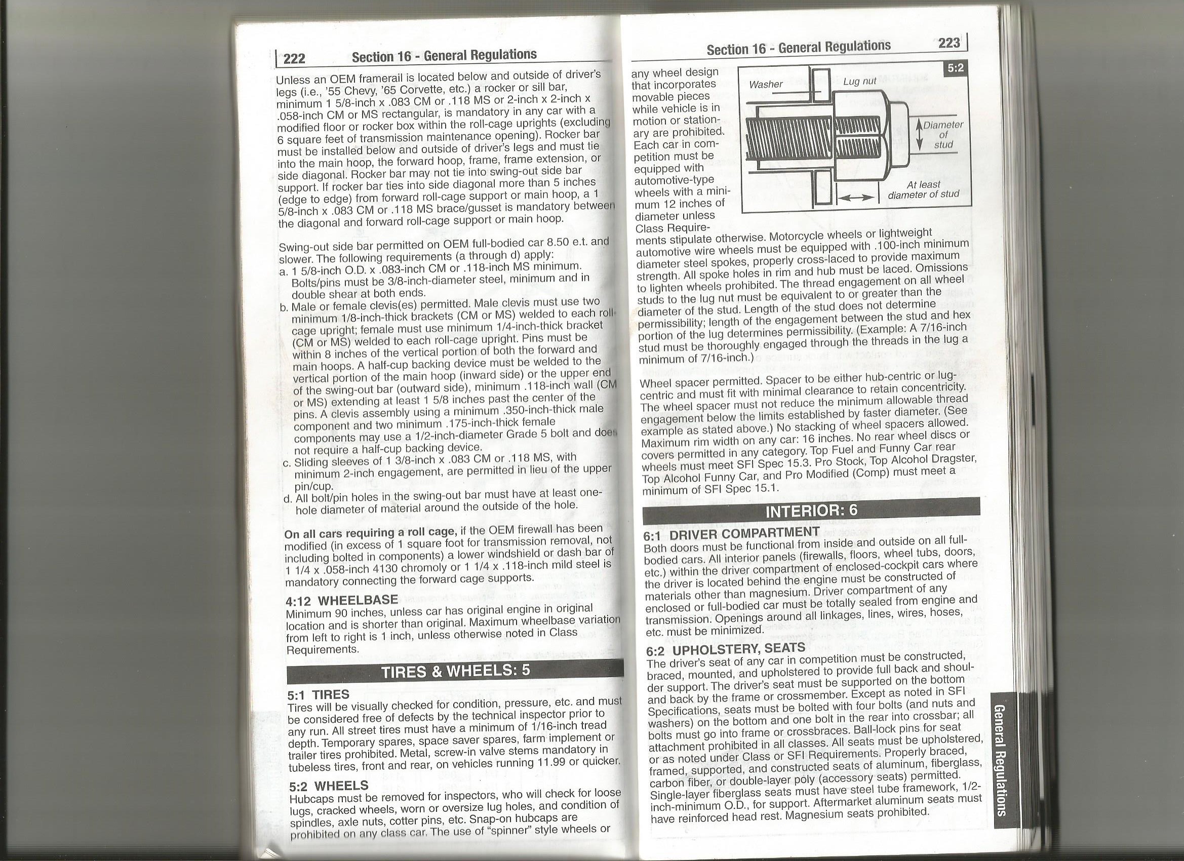

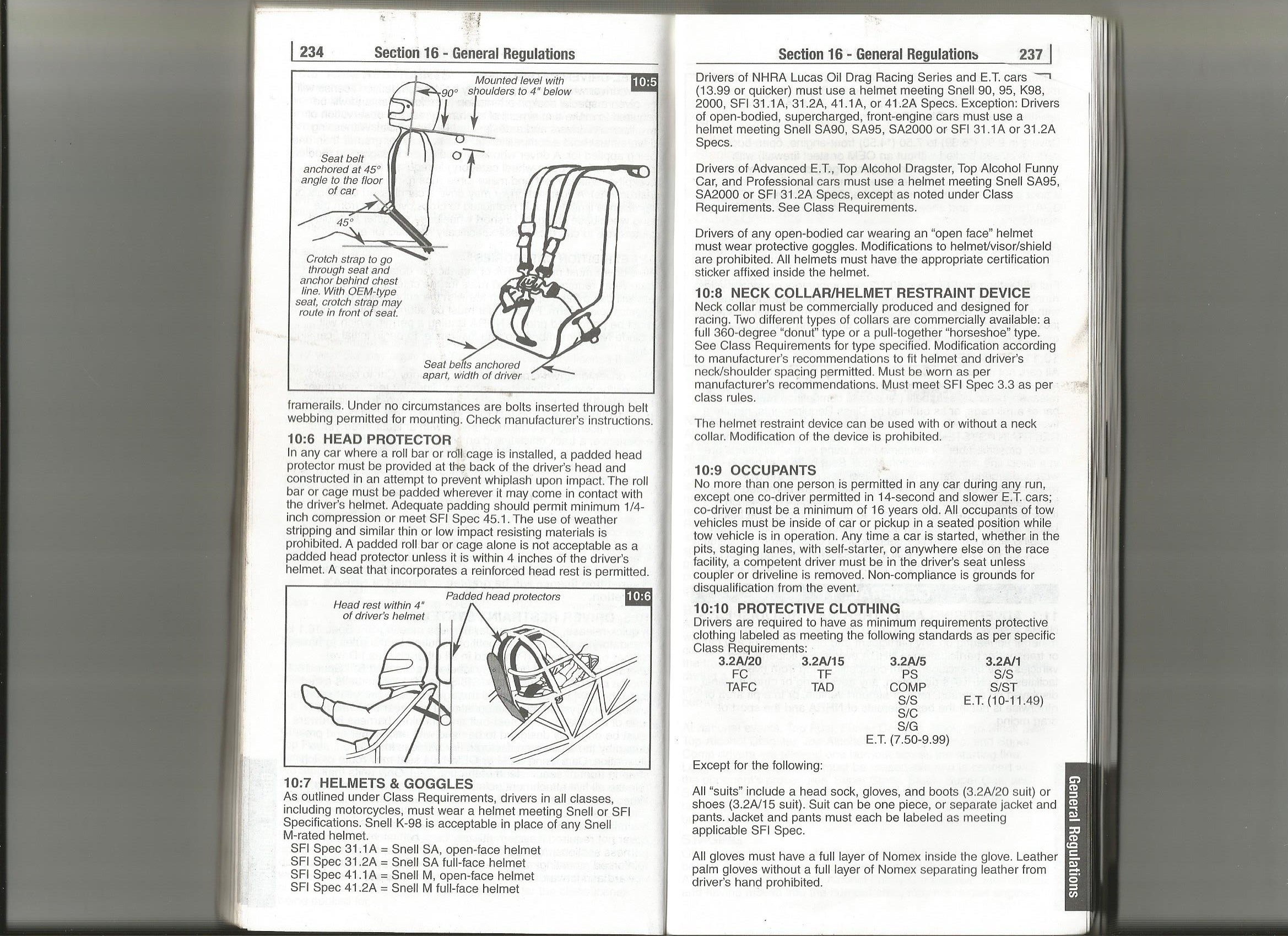

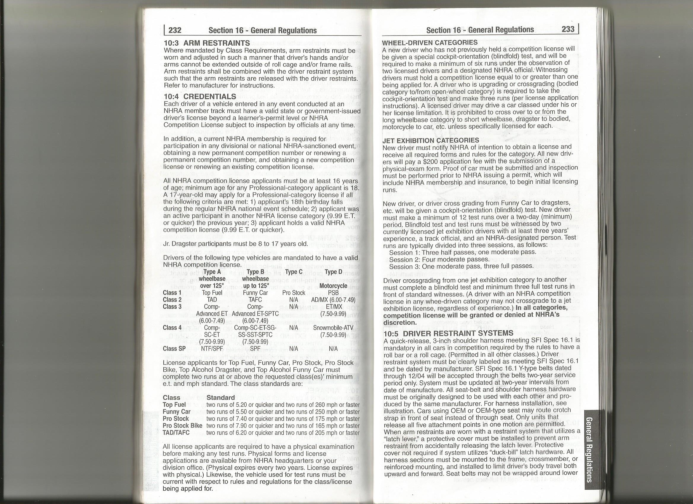

    What is the best way to run the over the shoulder belt? Through the top slot in the seat or not? I have the bolt on type so they could be bolted to a single bolt or 2 a few inches apart. Cage guy was not sure where to put the bar height wise. How would I know ? Its almost done - just like some advice so we can move on.

    You need to mount your seat to figure that one out.should be level with shoulders or no more than 4 inches below.

    see if this is any help for you Dog. Scan0018.jpg Scan0019.jpg Scan0020.jpg Scan0021.jpg

    Thanks Saltflats! The pic shows 2 independent anchors - one over each shoulder. That is what I was looking for.
