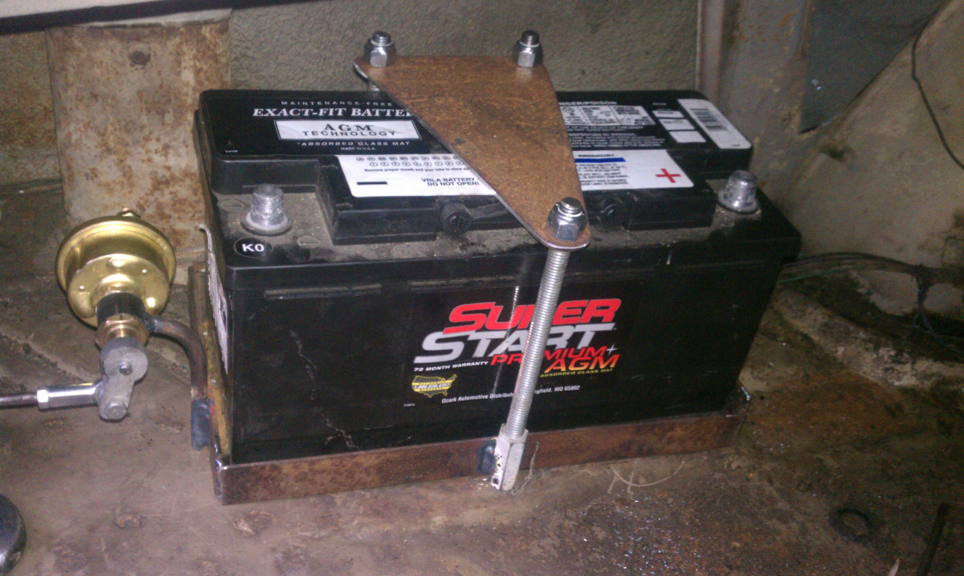

  8. .
    Not a bad idea, you save the weight of the switch & 10-11' of battery cable, and your car already hooks well enough to turn a 9" housing inside out. I have thought about this for the 56, especially if it became problematic with big wheelies (no problem so far)), the weight of the battery on the nose would keep the nose closer to terra firma, and I could lose the above mentioned weight.

    And it leaves the trunk open, no need for a bulkhead (I'm running the stock fuel tank). I think the only downside is that "we all know that race cars have the battery in the trunk"

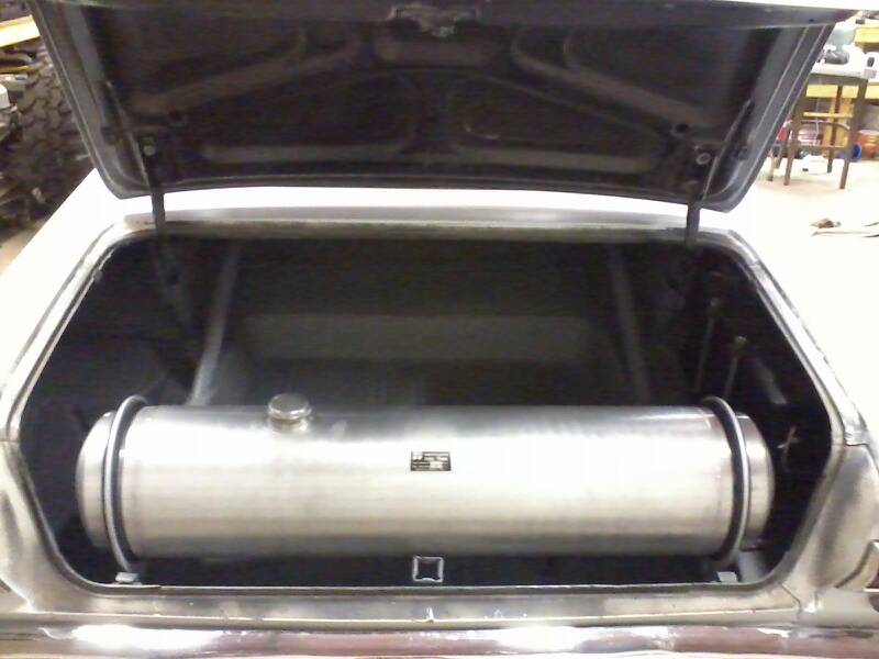

    My trunk is kind of boring inside...
