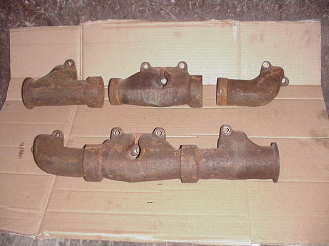

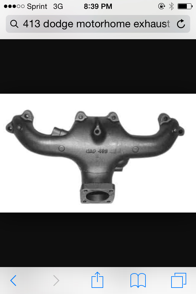

    Have a pair of motorhome manifolds, not 7 hole,but I'm close if he wants to take a look. Still on the bus. Bugsy
  2. Jimbo, that pictured exhaust manifold is for the heavy duty (truck & industrial) engines. Typical HD motorhome, big truck, and industrial (think combines, military, etc) applications. Those cylinder heads are different than the more popular p***enger car that use six bolts at the manifolds. Not ideal for high perf usage. I might still have a set of exhaust manifolds for the HD engines, but mine had the outlets straight back the ends instead of down at the center. Mine are in three sections that telescope together (like some bigger turbocharged diesels do) so they won't crack. MVC-621S.JPG
    Feel free to call me if you have any questions.

    My drivers side is center dump, p***. is rear. Hope that helps. Bugsy

    AJ, I texted Rick a pic of them & message. Rick said he'd like to change out heads to ones with hardened seats. He said he'd need intake & water pump ***embly to match everything. He explained to me the block is 440, the heads are 413's also used on 361? He said its a 440-3 from motor home. To make a 440-1 he said he'd need heads, intake & water pump ***embly. But at this point he just wants to get it running. He just had a son so he's on a shoestring budget at moment. But for a 55' Dodge the body is in amazing shape! I'll see what he says on manifolds...

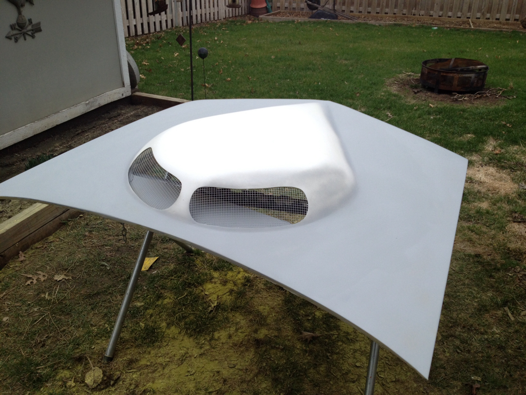

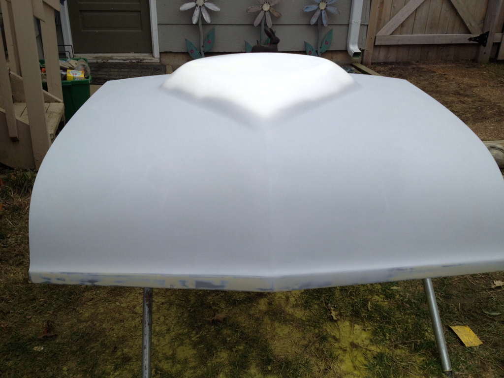

    I made a lil progress on hood this weekend! Have it roughed in, but still couple low spots. I'm pretty happy with how front hood center line came out! Starting to look like something...

    bigslim55
    Thanks Scott! I'm getting kinda giddy[emoji6] gotta take my time & try to make it look straight, but it should look kick *** on the old girl...!

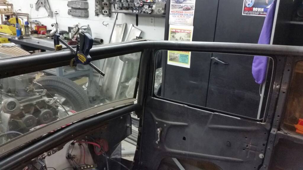

    Not much work getting done on the 55 but I have been working on the coupe. Last year the track told me to slow the car down or park it until my safety equipment was up to par. I agree with them so I decided to Finnish the cage.

    I really like how you tuck the cage tight to the body (hiding in plain sight) nice:cool:

    Made some more progress on the hood... Moved inside hood support brace ahead about 6" & just in case cut a notch at rear of hood... Started wet sanding top of hood with 150 grit... Starting to take shape...
    Jimbo... ImageUploadedByH.A.M.B.1429233997.399325.jpg ImageUploadedByH.A.M.B.1429234055.051315.jpg ImageUploadedByH.A.M.B.1429234085.884879.jpg ImageUploadedByH.A.M.B.1429234129.281634.jpg

    bigslim55
    Thanks AJ...! You ever been on a boat all day & you get off boat & you still feel like your rocking with the waves? My arms feel like I'm still sanding sitting on the couch... LOL...

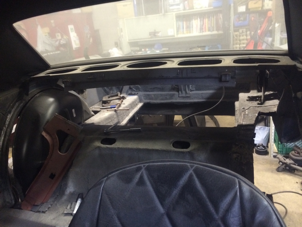

    So it's 2:46am,and it's like Groundhog Day again....lol!
    Got the p***enger's side at about 90%,began hacking and slashing on the driver's side tonight,and whaddya know,this side is WAY worse than the also-****ty other side...Lmao!
    So the big hillbilly and his grinder spring into action again!
    (handsome devil!)
    Here's what the back seat/trunk area
    Currently looks like.On the left you can see the new inner wheelhousing tacked in (I'm not happy with the job I did trying to fit it up and tack it alone,so I'm gonna cut the tacks and get my crew chief/Dad to help me fit it up about 1/2" higher and weld it out).
    On the right you see the carnage from two dozen Canadian winters and a big dummy with a grinder:)
    Here we have the sad view of the once proud Ford as it sits awaiting my legendary mig welding skills (looks like I threw molten wire around with a slingshot),and a few new custom-fabbed panels.
    Getting the housing back from the machine shop tomorrow (probably),so we should be mocking stuff up to see how nicely those M/T's center up in the wheel wells,and that annoying rubbing and bottoming out will be a thing of the past!:)
    I may even be able to jump up one tire size,but that would throw my gearing all out of whack,so we'll wait and see...
    If y'all will excuse me,I gotta go dig a couple pounds of rust out of my ears.....
    Scott
